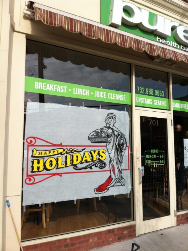

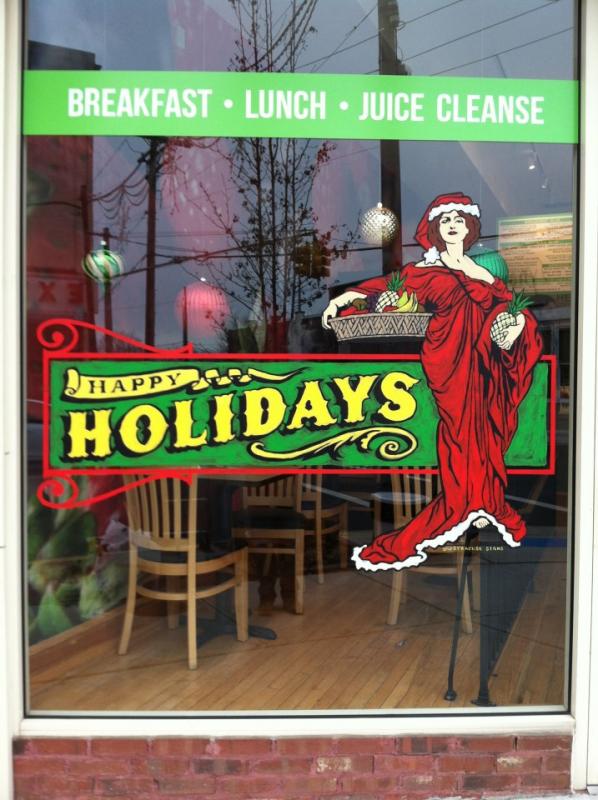

One of our favorite clients asked us to do a holiday window for her... We've never painted a window, so this sounded like fun. The artwork is altered from a design book (adding the white trim, santa cap, and fruit basket to the lovely lady.) The drawing was cleaned up in corel, then pen-plotted to use as a guide. We thought that painting the outlines first would be the best way to go, and it turned out great but took FOREVER. Seriously, it took two of us 6 hours to install. But woah, it looks SO cool.

Nice job, what paint did you use?
We used Liquitex Basics acrylic paint. I did a bunch of research, and although I found many different things we could use, we already had this paint so we decided to try it out. It worked well, I would use it again.
