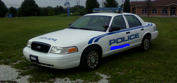

Heya,
I'm wondering how I can get this effect on this font in Adobe Illustrator.
I'm needing the effect on the side POLICE part. The font, and then the space, then outline.
Is that two offset paths, or what?
Thanks!

All it is is a multiple outline. Would take 5 minutes in any vector art program.
BPI Color
Convert your text to outlines. Then convert the outlines to a compound path. Don't be shocked if it disappears. Illustrator often loses your fill and stroke info when you convert outlined text to a compound path. Next go to Object > Path > Offset Path. Be sure to check your preview button. Reenter the values and hit tab until you're satisfied with the result. Once you like what you see hit return. Then change the stroke and fill values on the outside path until you have what you want. This is pretty basic stuff.

BPI Color, I can do basic outlines, but what I don't get is do I do two outline strokes? How? I can make a general outline on the font with stroke, but how do I get the white area between the outlines?
HulkSmash
create a text.
go to type>Create Outlines.
then select your type, Type>Path>Offsetpath
select your your offset #. Click preview box to see how big it is.
make that an outline, increase stroke to the desired size. then outline.

create a text.
Thank You!!!!!!!!!!!!!!!!!!!!!!!!!!!!!!!!!!!!!!!!!
