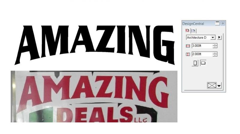

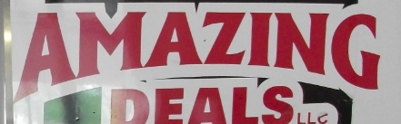

How can i replicate this text warp?
njsignguy
(Amazing)
I have flexibasic and have adobe cs3 package.
I cannot seem to find something that will make the text like this.
Anyone know?
Thank You

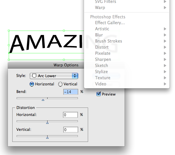

In adobe illustrator cs3, go to effect > illustrator effects > warp > Arc Lower
expand appearance once you have the right "bend" you're looking for and go to Object > Path > Offset Path to generate the white box around the lettering.

yeah, but type on a path also rotates the letter... his example shows a "flat-top", requiring the "Arc Lower" option.
