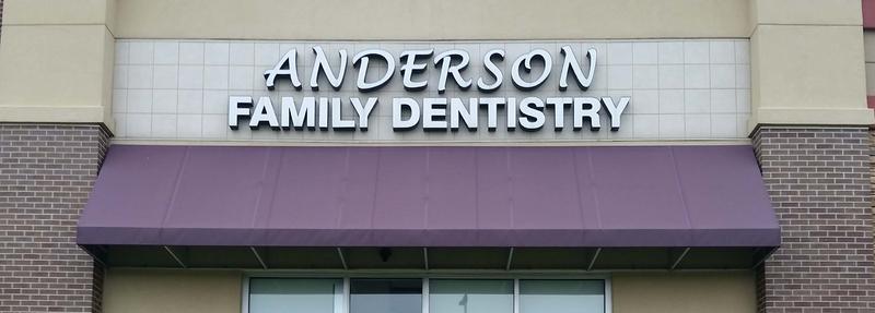

Customer has white acrylic face channel letters on a light colored facade. He is concerned that the black trimcap does not allow the letters to "pop off of the building." So he wants to widen the black edges.
This sign has been up for 6 years. He just bought the company. No one knows the original manufacturer.

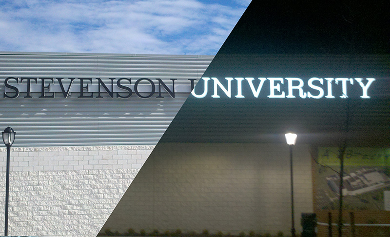

What color are the returns?
You can try day/night vinyl over the whole face. Though I don't recommend if the returns are black, if the letters are close together, that would make it hard to read...
Just do what 2B suggested. In fact, if anyone in your shop has a steady hand, you don't even need the tape part. Just cut it in and be done with it.

the cans are black (?) with black trim cap and white faces? inline with paint or vinyl but it won't make much of a difference and since they are lighted letters, the night time letters will have less light coming thru the faces. any reaqson why he can't switch to a red faced letter or some other color? that is pretty easy to do. not everythign has to "pop" to get attention

A couple of you suggested ordering new faces. I thought fit could be an issue if you do not order from the original manufacturer. Not a concern?
I have tried to attach a photo. Trim and returns are black.

Billct2
Yep, a vinyl overlay, either day/night like Rick suggested (but not black) or a regular translucent color (that will work with the black).
Marlene
who sold them white letters on a white background? adding black to it won't help. the night day would be OK but just how much business does a dentist do at night? not much I would assume so adding a translucent colored vinyl to the faces might help his day time and help him be seen during office hours.
