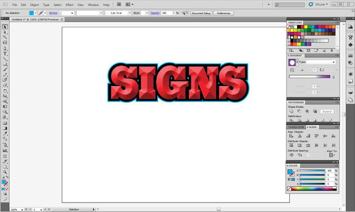

In the sample here, I typed in the lettering in illustrator, I then used the create outlines command (convert to curves), copied and pasted into photoshop on a transparent background, added the bevel effect, saved as a png file , then placed it in illustrator and added the outlines behind it.
