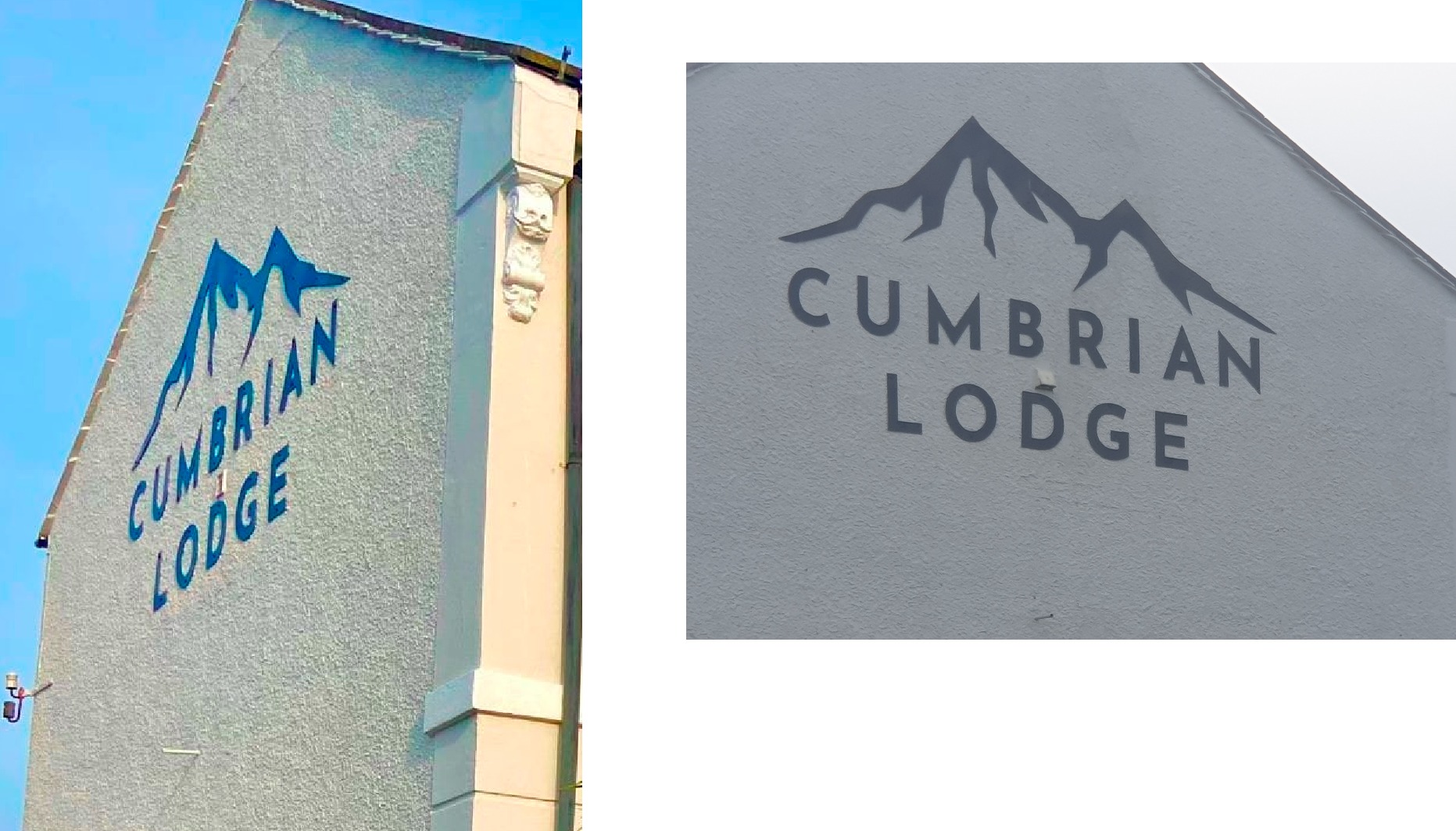

I have a customer who is looking for flat cut acrylic letters bonded directly to a rendered wall like the picture attached.
Do you know how I would go about fixing these and with what?

Here is the picture you have been waiting for.
Sorry but I forgot to attach it yesterday.

visual800
You need to scuff the back of the acrylic letters and then prime with 2 part auto epoxy primer its available in a spray can at automtive paint supply places, dont be using no cheap a$$ rustoleum primer!....and then silicone the letters to the front using a pattenr and hold it up there with gorilla tape,. You have got to scuff and prime acrylic because silicone will not hold without doing this. Thanks for the picture
