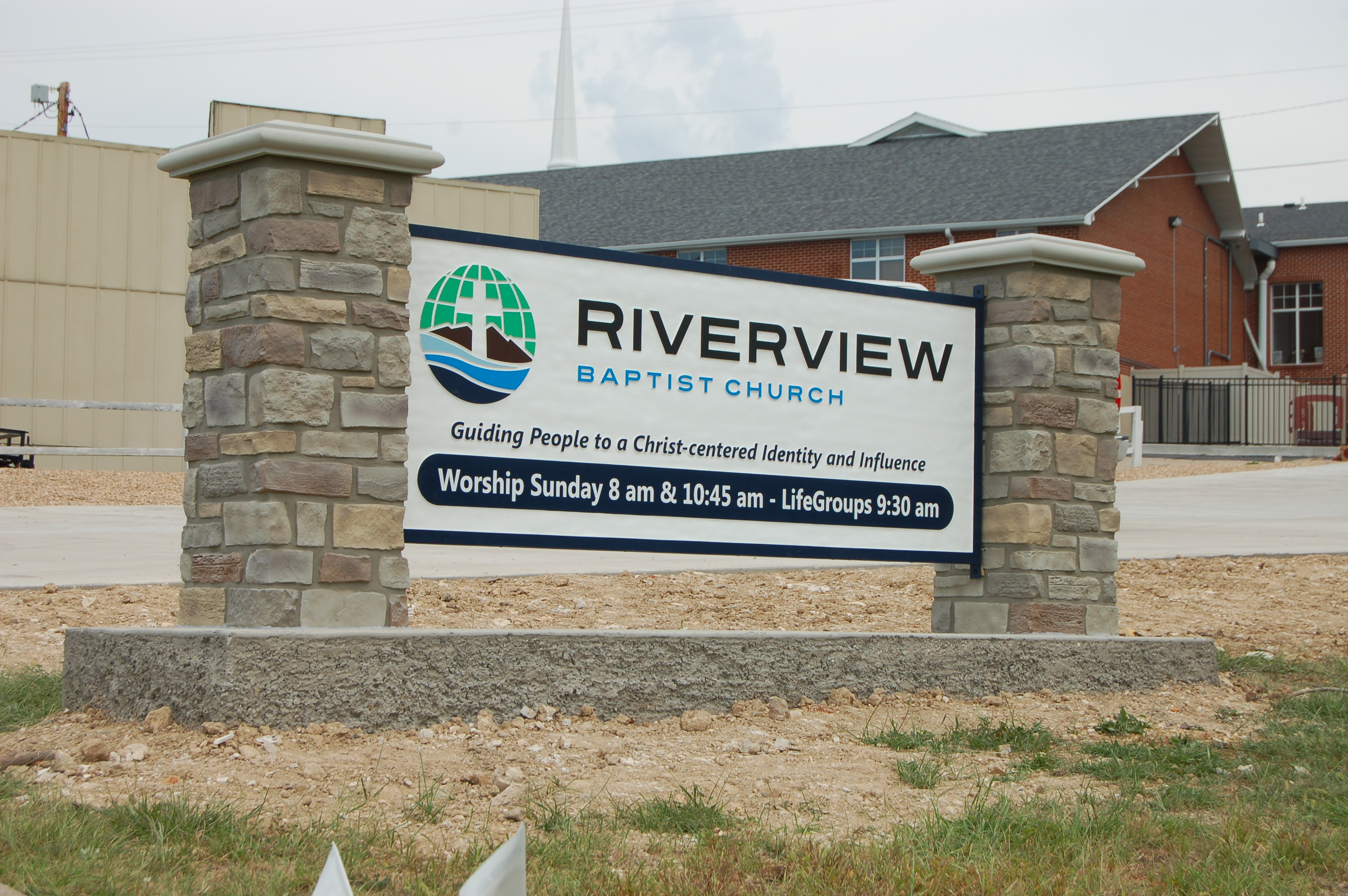

The cheapest method would be to screw some lumber to the brick pillars with masonry screws in anchors, run some lumber stringers across the width, then screw an ACM sign to the stringers that essentially fills the space. It'll be ugly from the back unless you make it two sided.
You can also have a frame welded from square steel tube (or aluminum if you have someone that can do that) which is screwed to the pillars, then attach flat faces to that frame. The frame will typically be built like a ladder.
If you're making a sandblasted foam face or a carved foam face, you'll want to have the foam sign built with a steel strap edge that has mounting flanges, which can then be used to screw to the brick pillars.
Lots of ways to skin this cat.
I've attached a picture of a similar sign installation we did (though it uses faux stone pillars).

You can also buy post/panel extrusions to accomplish something like your photo there, as well. We have done a couple between brick pillars like this, all unlit. We used an aluminum cabinet body and ACM panels. Made the outer measurements of the cabinet a couple inches smaller than the opening, then used all-thread and threaded hangers to attach it to the brick and lock nuts inside the cabinet body. Then it was essentially 'floating' and had an equal gap on all 3 sides between the brick. Of course, there are other and I'm sure better ways of doing things.
This is extremely helpful, thank you.
