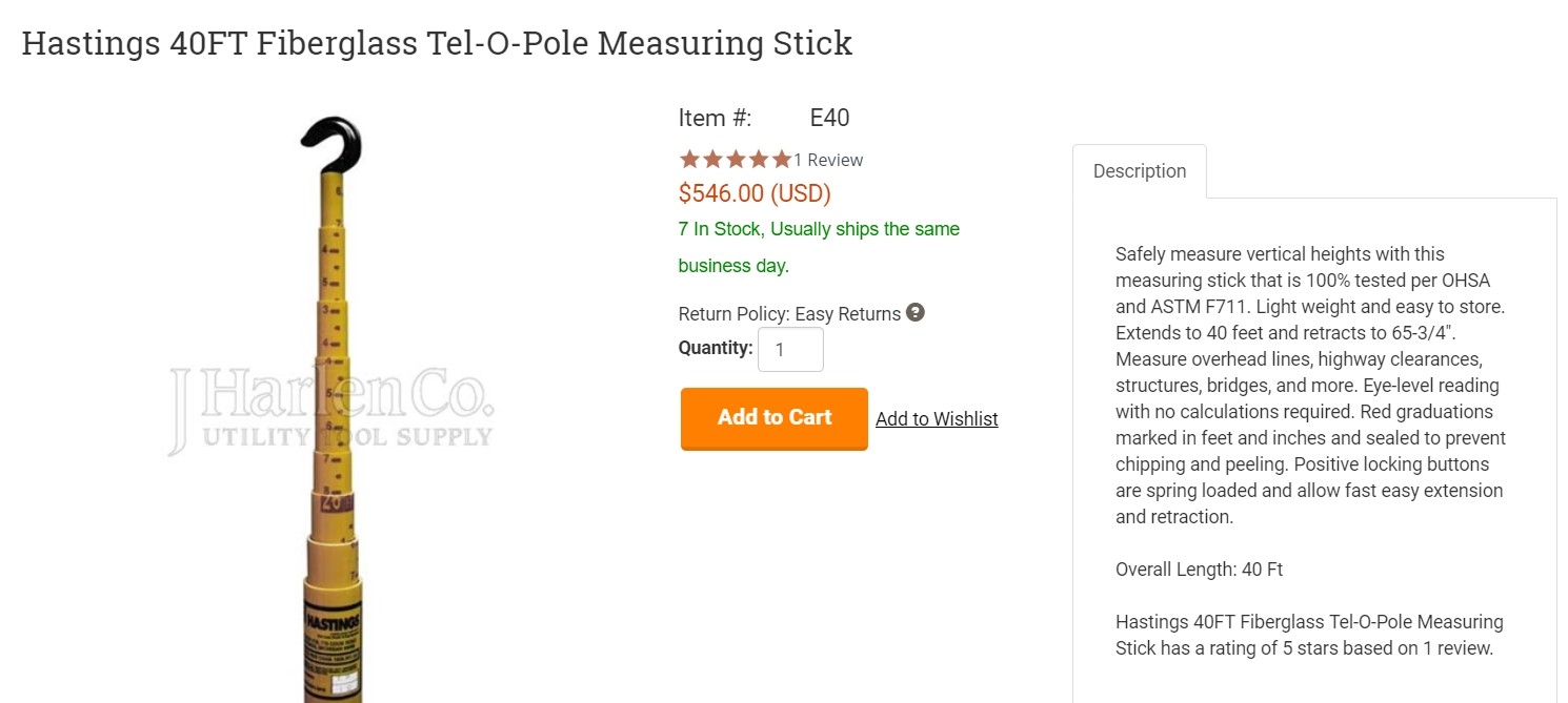

You said 'exact' twice. If you need exact, you're going to need to get up in the air with a bucket truck. No other tool is going to give you exact.
If you want approximate, there are a number of different ways, some mentioned above. I use a 40' fiberglass measuring pole for pylons, channel letters, etc.
wow....pricey!!!
