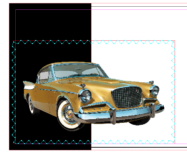

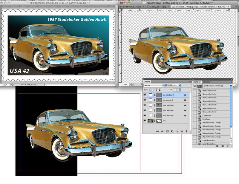

Working with a JPG image, opened it in PSD, created a vector mask around the car, saved it as a PSD, place native PSD in InDesign...
Can someone please tell me how it's possible that curvy frame that you see in the first PSD window, appears as a vector path in InDesign?
Top Left Window: original JPG open in Photoshop
Top Right Window: masked PSD open in Photoshop (pallets showing)
Bottom Window: placed PSD image open in InDesign (WTH vector frame)
see second image to view vector path in InDesign

That vector mask path must be acting like a clipping path in Indesign.
Do you want the image to retain that path in Indesign?
GypsyGraphics
The only vector path in the PSD file is the clipping path I created around the car masking out the background, that wiggle frame is part of the bitmap JPG! How it is possible a bitmap JPG could have a vector path of any kind?

Could be a hiccup in importing, but it's obviously something left over from PS. PS has vector capabilities, so PSD's can contain vectors. Jpegs... cannot.

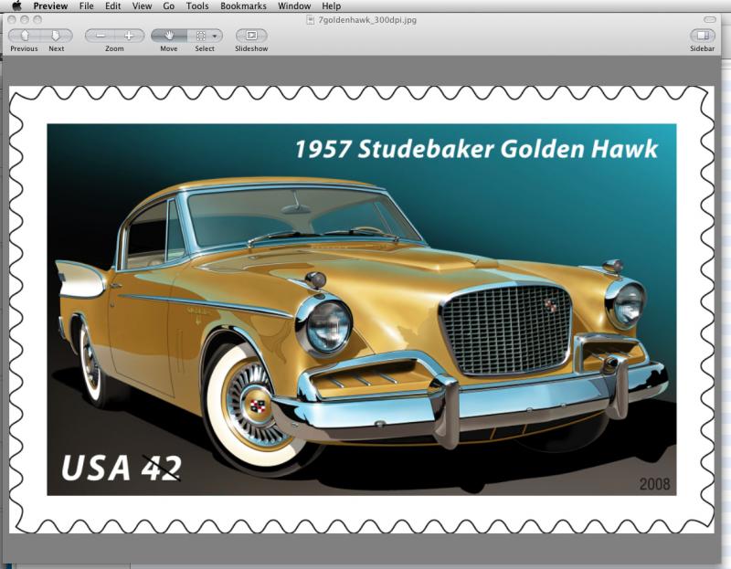

Can you open the original jpg in a basic viewer (like windows picture viewer), and post the screen shot? Or maybe just post it here?

You can save a .jpg file in Photoshop and it will still retain the clipping path
there are plenty of times I've opened .jpg files in photoshop and they have the clipping path intact. Coming from a retail page layout background you would want to save your images in photoshop with a clipping path. So when you import them into a page layout program like QuarkXpess InDesign the background of the image is not showing

Did you open it in Illustrator and see it in wireframe to see if the vector is in there...
You can save a jpg with the clipping mask embedded in the jpg so it seems the previous designer must have done that.

What you are suggesting is exactly what was done. It is saved as a photoshop file, with a clipping path, the PSD file is what you seen in the InDesign file.

If you open the original .jpg, in Photoshop, then go to paths, you should see the path, click on it, you should be able to turn on the path.
GypsyGraphics
Okay, tired this way... vector path not visible in Illustrator.
Holly Cow!!!! There it is!!! Like many answers often do, this poses another question. And since your are clearly the guy with the answers, can I ask...
How is that two vector based programs can't see that path but Photoshop can?
And... in what manner would the JPG have been save that would have preserve a clipping path?

If they did a path in Photoshop and saved the file as a jpg, the path is saved, you just added another path to it. I do not get too many designer files like that. I usually do all my clipping in Illustrator.
