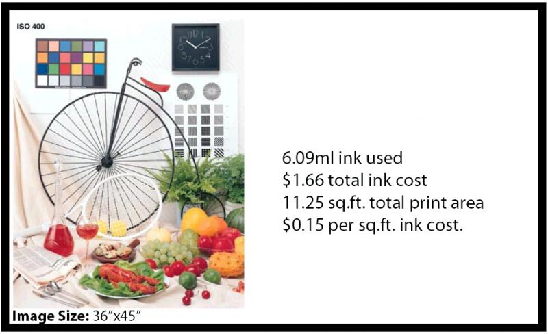

Epson uses 1 ml per sqft as an average in their ROI calculators for solvent machines and 1.5 ml per sqft in the aqueous machines. This is a good starting point.
The only way to be absolutely sure is to keep logs and weigh your full, empty and partial carts to calculate your average.

Now that doesn't make any sense. .50ml per square foot would give me 440 sq.ft. per cartridge. There are more than 600 sq.ft. in a 54" x 150' roll of vinyl.

Stealth Ryder
See the pic...

Here is some additional information:
http://www.mutoh.com/kb/entry/30/
so that .5 ml or 1.2 ml per sq.ft. is C, M, Y and K total.
so .5 ml would give you 1760 sq. ft. per set of cartridges
and the 1.2 ml would give you 733 per set....etc..
*Your actual mileage may vary.
