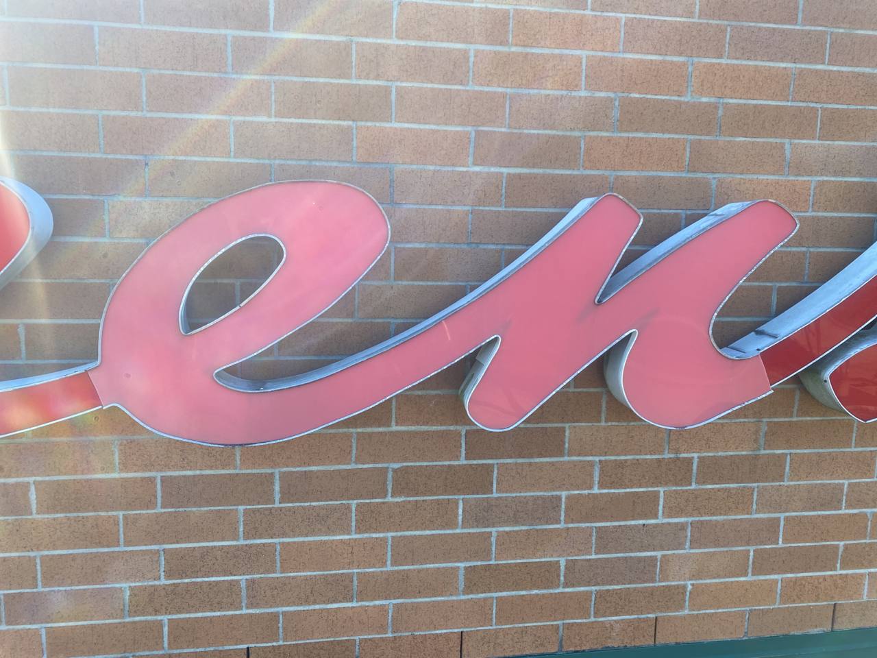

Hello Forum.
What tools and method do you use to cut channel letter faces when there are no files available? For example when faded faces need to be replaced.
The method I was told is to remove a channel letter can from the wall, put it on the table, attach to a sheet of acrylic with double sided tape, flip over and cut with a hand router with flush trim bit (with the bearing). That didn't always work well for use.
We tried Oscillating Tool with questionable results.
Thank you!
