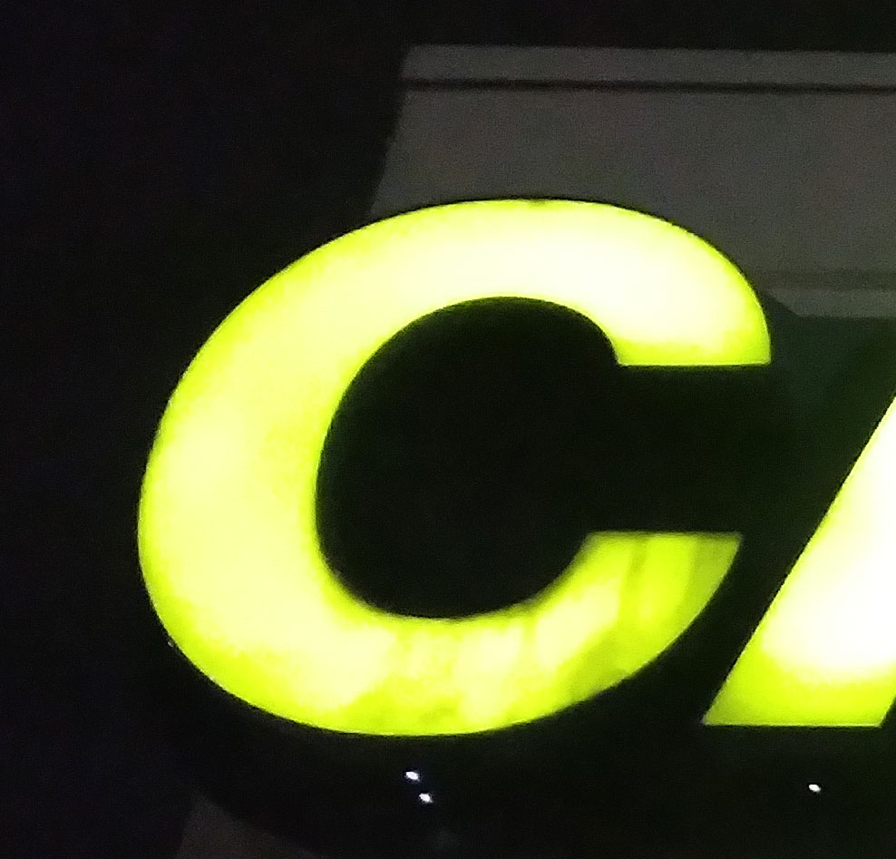

I got a call from a customer about "dirt" in a lit channel letter sign and if I could service it. Checked it out during daylight today and the signs looked fine, went back after dark and saw dark streaks running down the interior of the face of every letter, mostly pooling at the bottoms of the letters. They all look dingy and it looks to me like mildew or mold, or could be rust. I took a few pics but they came out overexposed, so I can't post an example right now. Wondering if anyone has ever encountered anything like this. I'm probably going to turn down the job, past my skill set, but still curious for future reference how they'd be cleaned.

You could just take the faces off the channel letters and clean them. One of the companies I do sub work for does these a few times a year. I take them down, they clean the faces and re-vinyl them, and I put them back up.

gnubler, I think you ought to take this job. Get up there and as JBurton and Tex said to remove the channel letter face and clean them off. Water is leaking in there and making the mildew and mold to form. Could be a new money maker for you.
There is also a whole other market of removing bird nests and their droppings in sign cabinets and channel letters.

There are likely philips head screws around the perimeter. They are little pan heads that are pretty industry standard, and you should have some on hand when working on faces. You are likely to drop a few and its also likely you'll find the last person to service them did not replace all the screws, leaving a big ol' hole for water to run in. There should also be drain holes at the lowest point(s) on all of the letters. So for an M, that's 3 holes.
Call your states electrical licensing board and ask if there is a sign specialist license program, or if you need a license to remove a 'sign cover' while not messing with electrical components (this is essentially what you are already doing when replacing cabinet faces already). I'll wager you can do that much unlicensed, but always wise to check. Also, there should be a toggle switch on the raceway that the letters are mounted to. Always a good idea to flip it off to ensure nothing bites ya...

Ran out there again over the weekend with my installer, first thing he said was "What if we break something?" Got a closer look and the letter faces look like yellow acrylic pieces enclosed in a housing (trimcap, as mentioned above?) fastened around with screws. Easy enough to remove, but then onto the cleaning part. How would you go about cleaning them up? There's no water source at the site, and it's the dead of winter. My installer said this is a job to revisit in April, or just replace the faces with new ones. I think at that point the customer needs to contact the original sign company that made them, yes?

Give the owner a price for making new faces and leave it at that. Quit over thinking every job you come across. You will burn out in a year.

You bring the letters to the shop to clean. Gnubler, do you know how to take a picture and post it? Gezz this is like pulling teeth out of a cat.

Simmer down there, Tex. I did take pics but the night shots came out bad and I haven't made it back there again. I don't want to publicize the entire business name...how about a C for $500? It's a bad shot, but you can see some of the black junk inside. All the letters have it, some worse than others.
