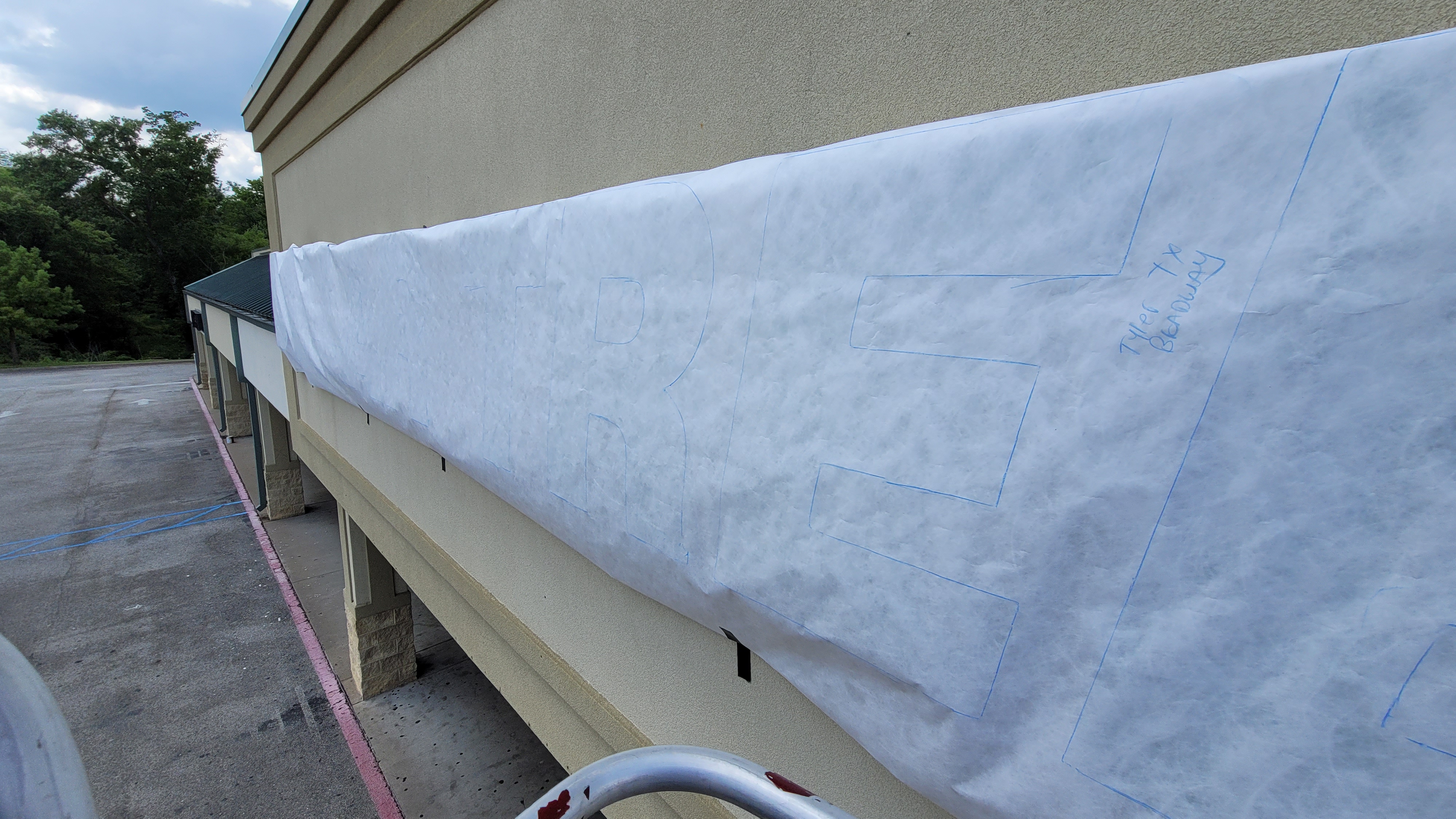

No way would I ever do this to someone else's work from 20 years ago. Unless you can take the whole thing down, bring it into your shop, no way in this weather would I ever attempt this. However, at my age, I don't wanna do something like this. I like to be kinda dead on with things and know it going in.Yes and no. Ideally they have a fat wad of cash and don't mind paying for a brand new sign that will work for another 15+ years, but with a physical rubbing, anybody can recut faces and glue trimcap on. They are just big hollow cans with some lights in them, if that supplier can't cut new faces with confidence, then I'd find a different outfit to work with.
This is really easy to do yourself. Once you have a pattern, get a 4'x8' piece of 4" thick styrofoam, sheets of lexan or acrylic, cut the pattern down to fit on your sheet, then start cutting with a jig saw. You will either want to cut on the line if you traced the faces, or outside of the line if you traced the cans. Once you're done, get a roll of trimcap and some CHANNELBOND, not weldon, pin the letter to the table with a few nails, start your trimcap, and place nails every 1-2". You'll need a nipper to cut the edge of the trimcap for inside bends, but that's about it. Once you have all of the perimeter capped, lay down 2 or 3 thin coats of channelbond, letting it dry 15-20 minutes between coats.
Bottom line, a new sign would look better and be 'perfect', but new faces would be cheaper, with no guarantees of a perfect fit. (This is where you hopefully started this venture with "and how much would you like to spend on this project")
