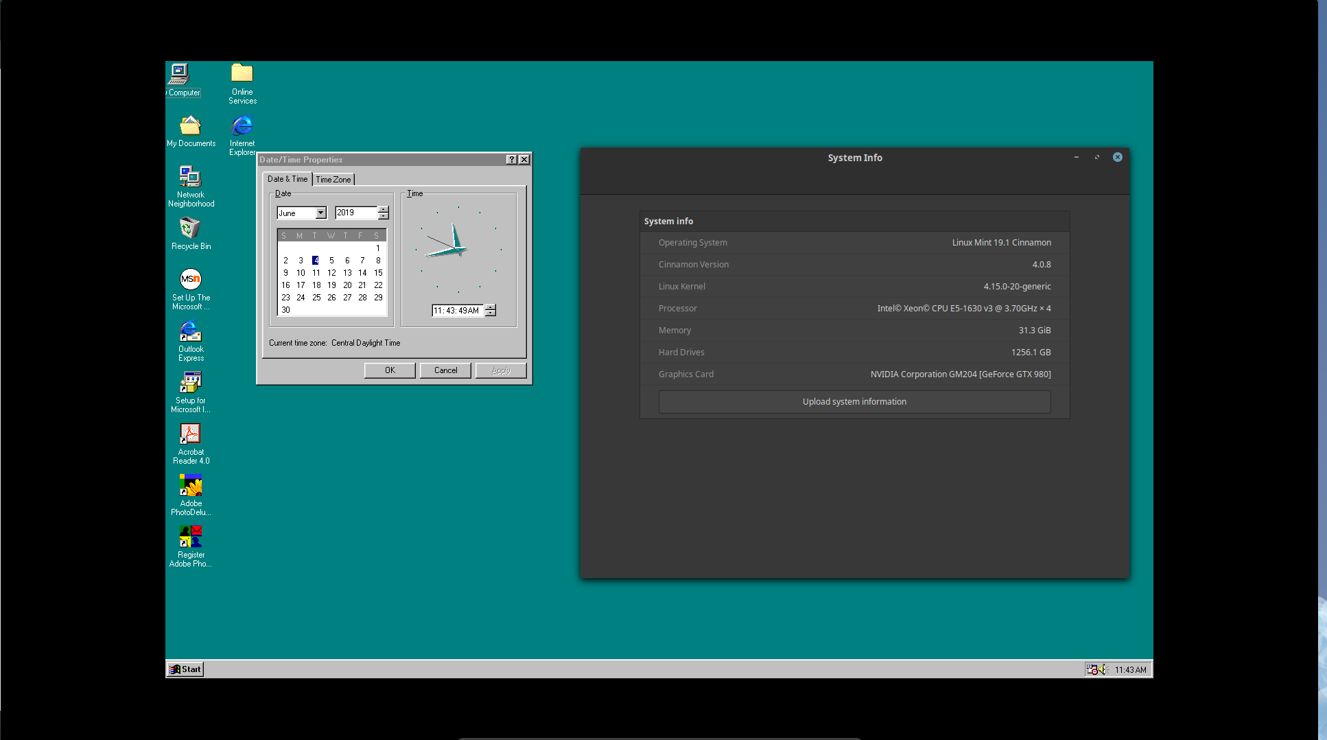

If they need older OSs to run and there isn't a way to get it to run on slightly newer OSs (especially ones that everyone still supports (software/hardware/MS etc)), you can start off using a physical machine with the OS, but depending on how much longer that runs, may want to start thinking about a VM solution of the older OS (not emulation, that takes up too much of a performance hit, but virtualization (slight differences between the 2)) that way it can still be on newer hardware.
Attached is my Win98 VM running on much newer hardware.
It does bring about it's own particular quirks, so make sure that it would fit your situation, I just hate having to keep older computer hardware when newer stuff came keep the software alive for a little while longer.
Now if this bleeds into say the production equipment (plotters, printers etc) then it's time to upgrade those as keeping the legacy stuff doesn't make as much sense. Then the need for VMs and/or older computer hardware isn't necessary (at least as much).
