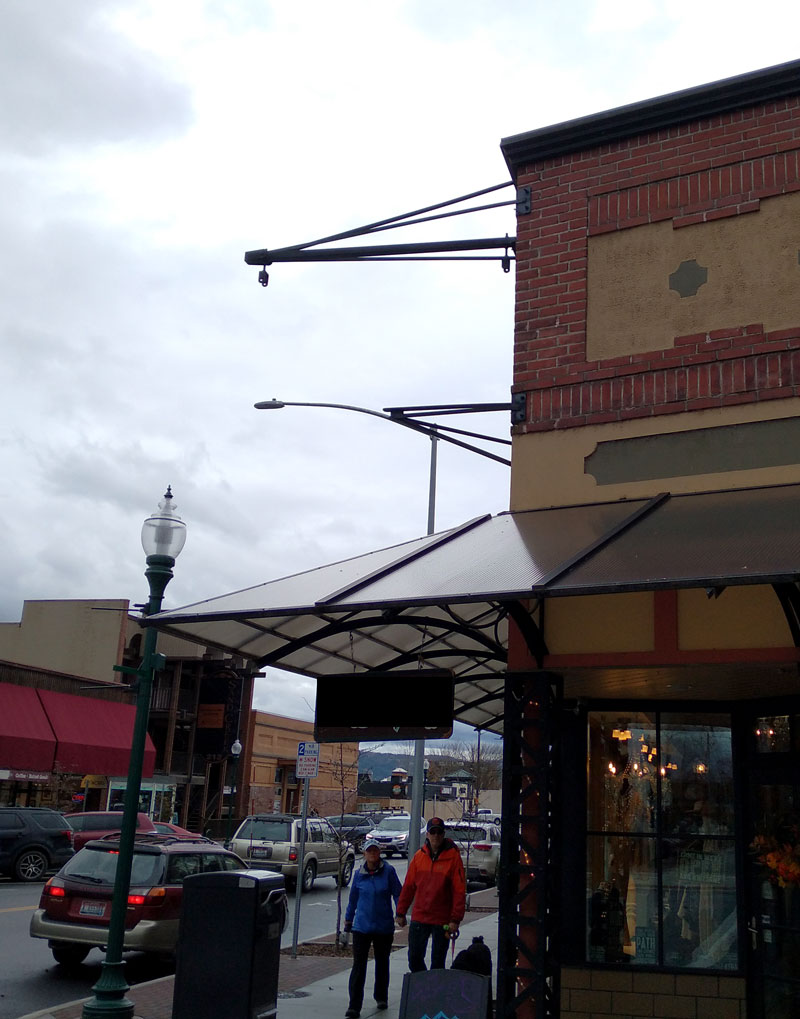

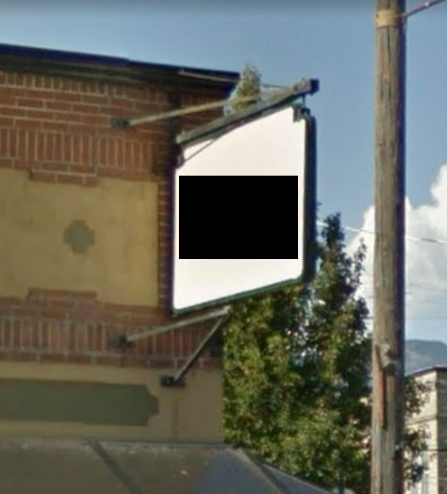

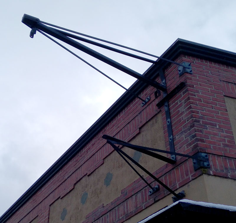

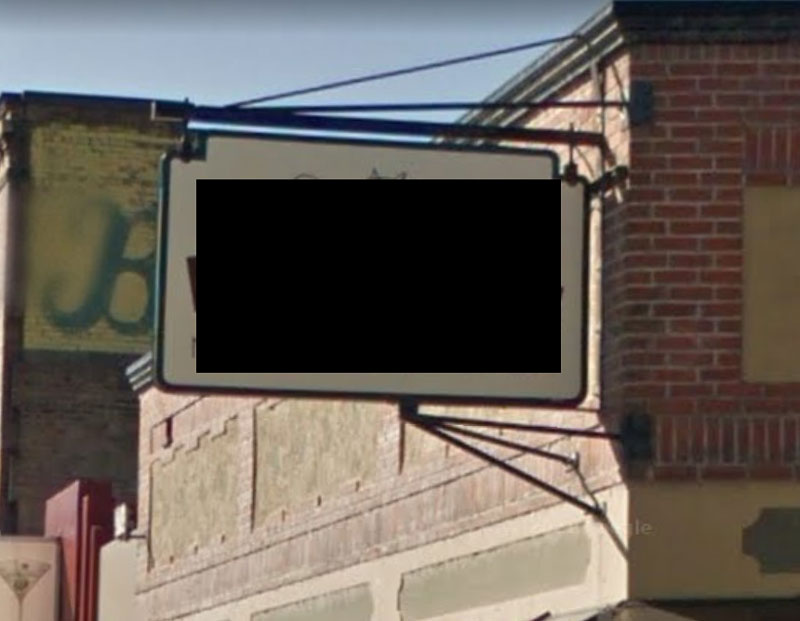

Bunch of images below. Working on a bid for this project and would like some suggestions on how you would make and install this sign. Two faces measuring 84x48" into existing framework projecting from the side of a building, with an awning below so boom lift is required for access. Was able to snag old Google street view shots of the old sign that used to be there so you can kinda see what they did. One of the faces is still there in the basement of the business, it was made of 3mm ACM and I can use it as a template if needed. What materials would you use to make this and what would be the easiest method of installation? We haven't been up there yet to measure the brackets and see if they're bolted in or welded. For reference the bottom of the frame is about 17 ft from the ground. Thanks in advance!

You can definitely see it's more than just a 3mm panel. Looks like a framework was used and maybe a 3mm attached on each side. Use a bucket on either side and one hold it in place, while the other one bolts it up there.
gnubler
Yes, there def was some sort of framing between the two panels, cut around the edges and painted black. Probably some "ribs" inside for wind load resistance.
That's what a framework usually entails, Gussets, battens and the outer edging with some mechanism for hanging it, welded into it for strength. So what's your question if you knew all that ??.

Over the years, we've done lots of them like this. One thing we did and this was before engineers and crazy-a$$ed permitting. We'd put all-thread through the wall and flange it to the inside wall. One place said, but we have apartments up there. So ?? You want a dead body down here ?? Guy wires and all will help, but there's no sleeping like a baby without it going through the wall for peace of mind.
