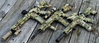

does anyone on here do this,looks awesome just wondering if there is money to be made at it and also what type of printer do you need looks like regular printers converted to different inks

I let the experts serve my hydro-dipping needs. It sounds simple on the surface, but it isn't. Lots of steps involved. Base part has to be prepped and primed. The graphic sheet is then laid in a water tank(tanks are temp regulated). Graphic sheet is then sprayed with activator. Now the part can be dipped. After dipping parts need to be clearcoated.
There is a member here that will make hydro sheets. Just send him your file. AFAIK there is no way to do it with our printers.
There is supposedly material available in China that will run through a wide format printer, but I haven't found it yet.
Can you make money with it? Yup, but it's a lot of upfront money, steep learning curve and a ton of shop space. You'll also have to deal with air regs in your area as you'll be using automotive type bases and clears.

hydrographics uses polyvinyl alcohol to transfer the ink layer, same stuff as listerine strips.
+1 to outsourcing your prints to someone else that already has the means. I have only dabbled in a few handguns, stock camo patterns ordered online.
having a 3D printer is actually pretty handy for this, as you can create custom mounts/handles to use for the dipping process (that can also double as stands/handles for clearcoating)
