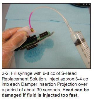

you mean the manifold. there are a couple ways. the most common is to fix a damper to a line that is about a foot long. then attach a syringe to the other end of the line and gently push cleaning solution into the head manifold.
you have to be very gentle because the head doesn't like positive pressure like that. also your head manifold may be dried up. for that, take out the head and take off the manifold. either put the manifold in ultrasonic or just jet cleaning solution through it.

here's a screen capture from a head replacement manual for a mimaki. it shows the general set up for the syringe. if you want, i can email you the entire manual which will give you a better idea of how the heads are screwed in and the removal of the dampers, etc.
