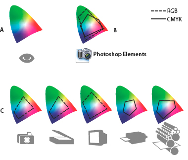

Tell them that thier monitors are backlit RGB and the product is a frontlit CMYK printed banner, and you need a CMYK printed frontlit object to match color from, or a pantone color number.

702 graphics
Show her this
