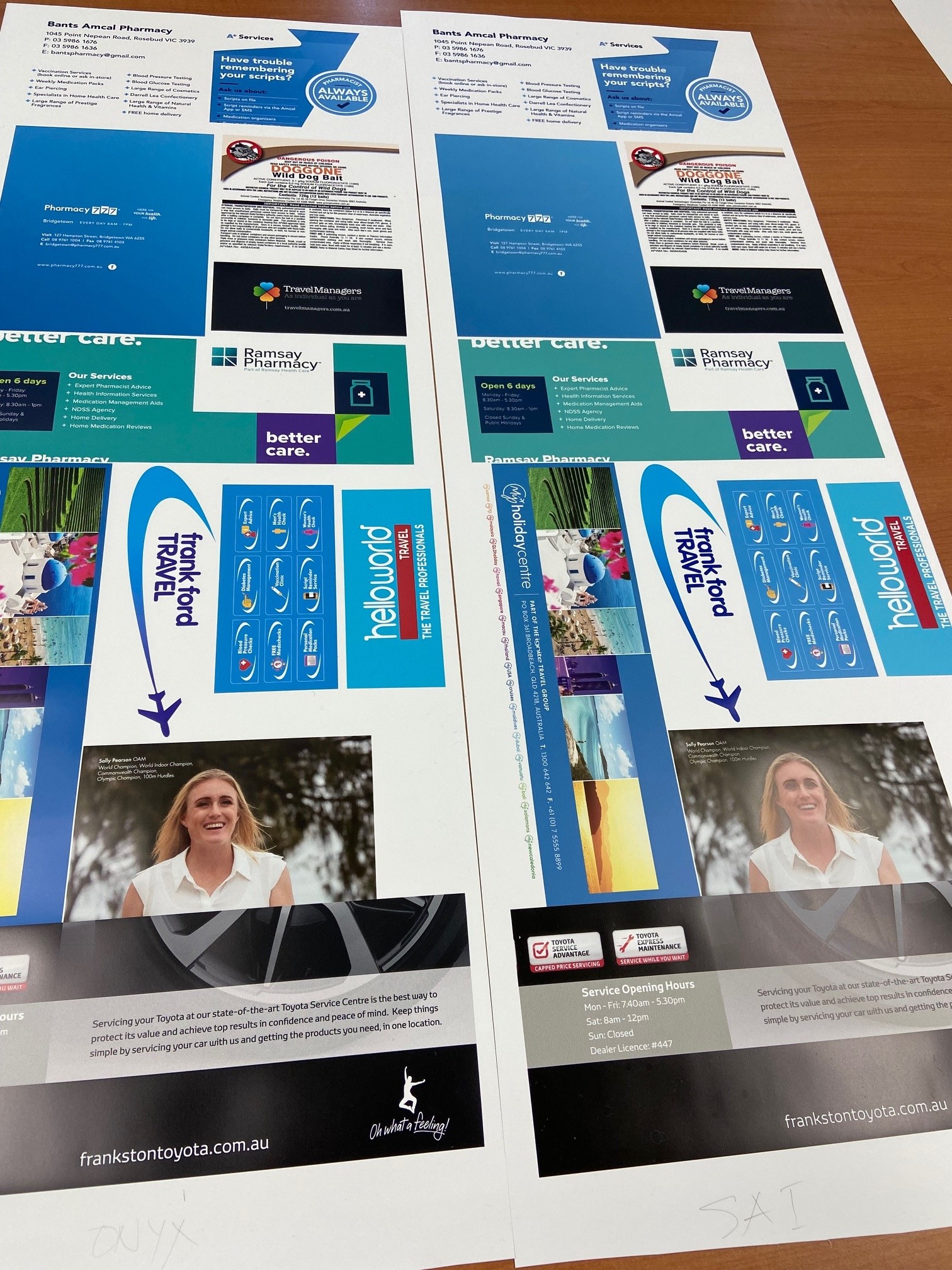

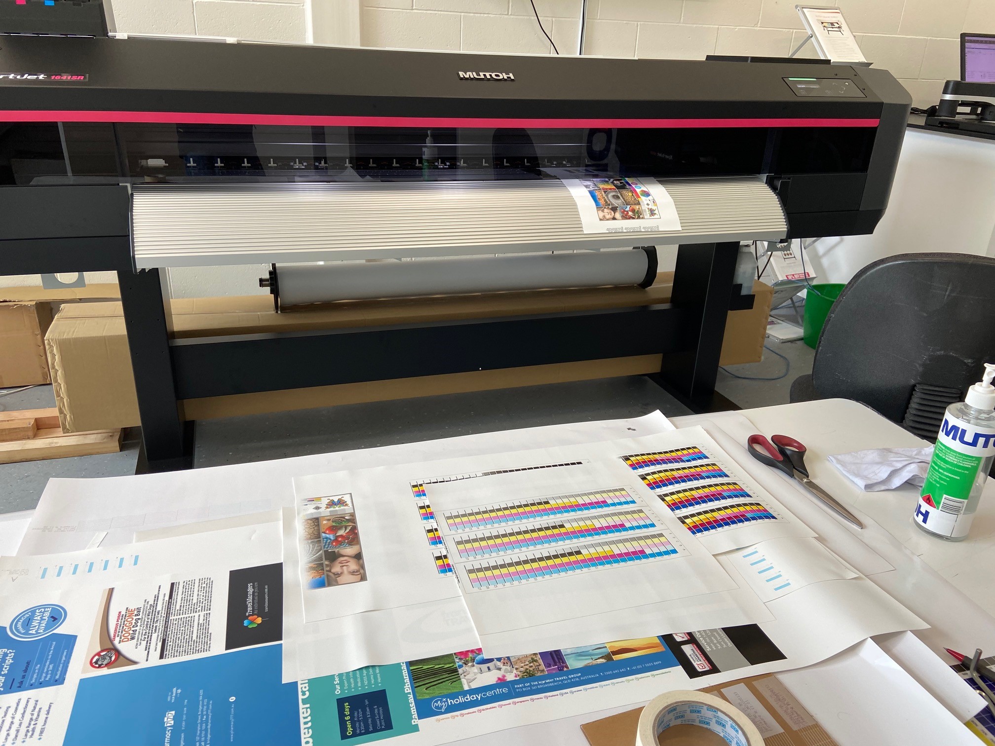

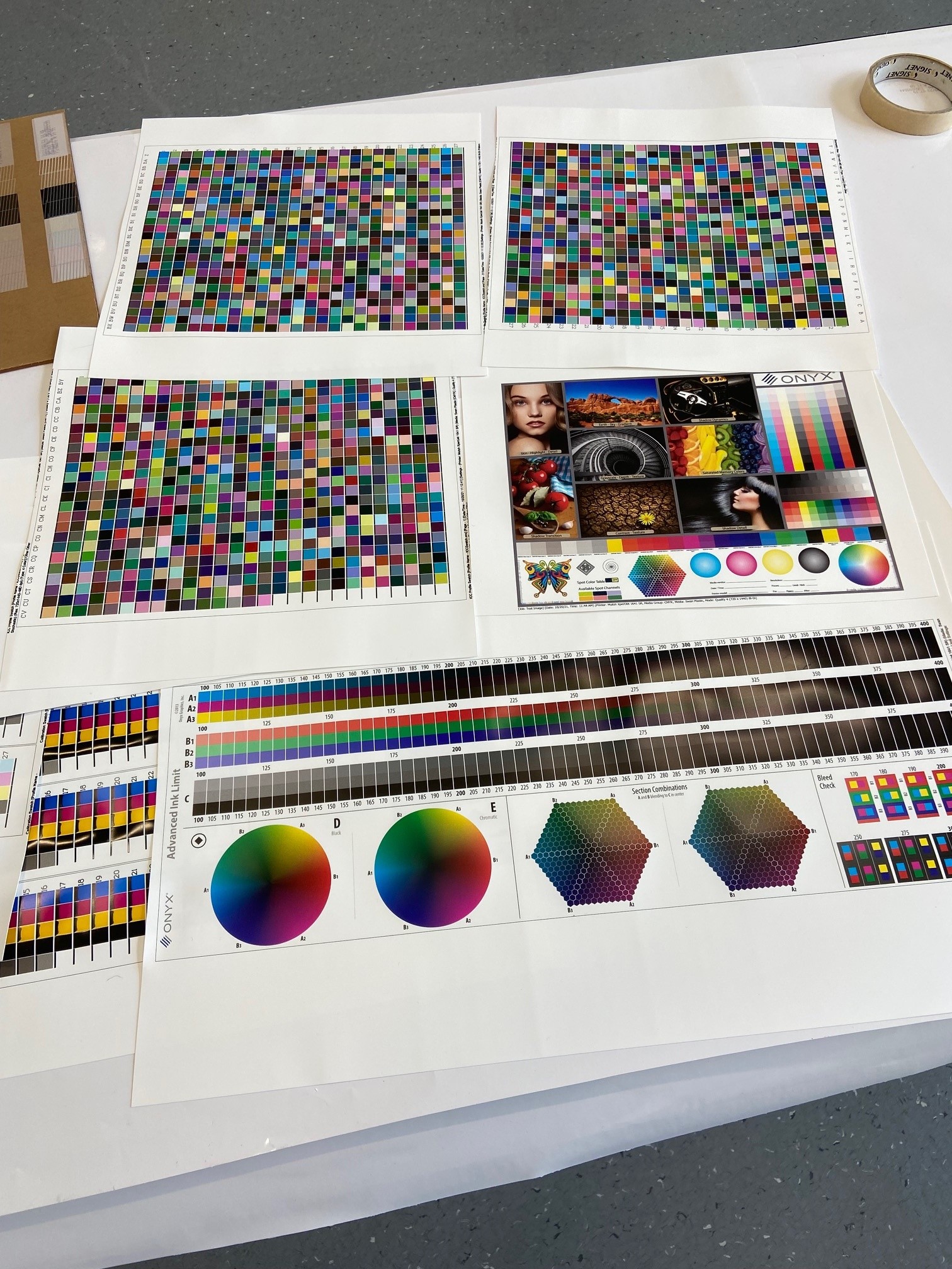

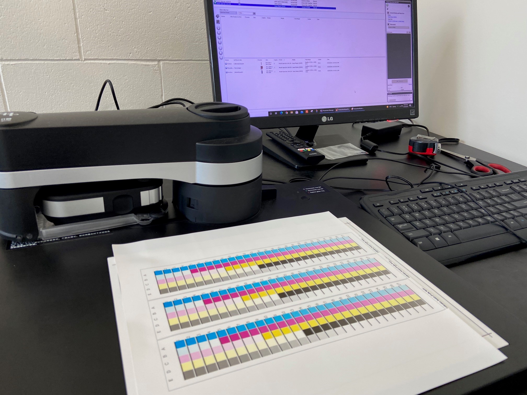

I just did a quick Q4 (720 x 1440 8 Pass Bi-Directional) profile in Onyx on our XPJ-1641SR using mostly default automated settings, it came out slightly better than the canned SAI Flexi profile.

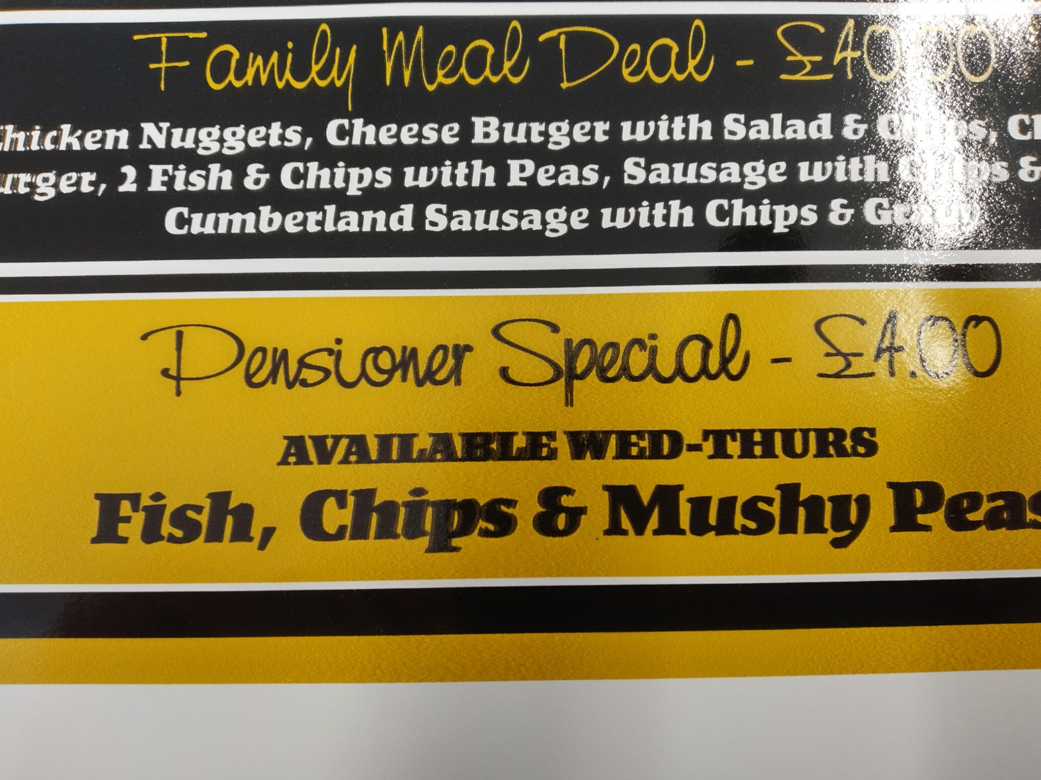

I purchased the machine of Grafityp in the UK.
I am using Onyx 21 as my RIP
We do not use Grafityps materials and tend to sway to 3M, Avery and Oracal print medias.
All of Grafityps profiles are very similar except for heat setting and all use Effect Fine & Fog 3, which is the slowest effect.
I have an issue printing on some materials and it blurs in different areas over a full width print as attached photo.
I am not sure whether this is a software issue or a hardware problem as the machine is only connected via a seperate network card and not on my main network.
If anyone had any profiles they could share for Onyx for this machine it would be much appreciated?

Depending in which direction you have the offset, you need to adjust the bidirectional printing or feed settings.

That double printing issue sort of looks like an encoder issue. My first thought was maybe the media is buckling in that area as well. Won't hurt to make sure the vacuum is turned all the way up and make sure your heat isn't set too high. Also, make sure there isn't any grease on the encoder. Newer machines tend not to have bad encoders but the grease from the rail can sometimes splatter on there and cause issues.

Well I have cleaned the encoder and it has improved the print slightly but their are still blurring across the print in areas.
Vacuum is almost on full and the material is flat going through the printer.
Their is still too much ink being placed down as blacks and darker prints are flowing into each other.
Also noticed that all print modes I have managed to find for this machine are Bi-Directional, even the highest quality ones.
I thought and it was for the old 1604 I had, that to gain high quality you had to be applying a Uni-Directional mode?

I don't want to adjust the bidirectional printing as it is not doing this over the length of the print.
As I am getting a technician over next week.
I have also noticed the encoder disk on these machines is no longer enclosed like the valuejet machines. Which will surely have further issues with contamination.
Also their is now a fan to the very rear which will be pulling ink vapour over the encoder fence.

Did you get print samples off of a 1641 before you bought this - or preferably watch one print your file(s). If so, you should hold the tech/sales team to delivering what they showed you before you purchased the printer. If not (shame on you) the print you posted definitely has some problems A decent tech should be able to observe what's happening and work out a solution.
Mutoh printers, in my experience are pretty forgiving and reliable machines. I'm sorry you're having problems with yours. It's not the norm.

OK the technician has been and spent the entire day and a lot more trying to fix faults. On the printer the only thing he could find was the bi-directional alignment was way out and this has helped big time printing on their polymeric material. I have not touched any alignments as I felt it was a bit early to start adjusting this. I am still having what I can only describe as ink not adhering and the edge between colours reacting on their and my monomeric materials. All available print profiles available anywhere as far as I can find are bi-directional and I cannot find any profiles to run at the much better uni-directional rate.
Does anyone have any more profiles I could try for the Xpertjet 1641SR using the latest Onyx RIP?
I am beginning to think the MS41 inks for this machine are very fussy with certain materials and even profiling is not going to cure or help the issues onto certain materials.
