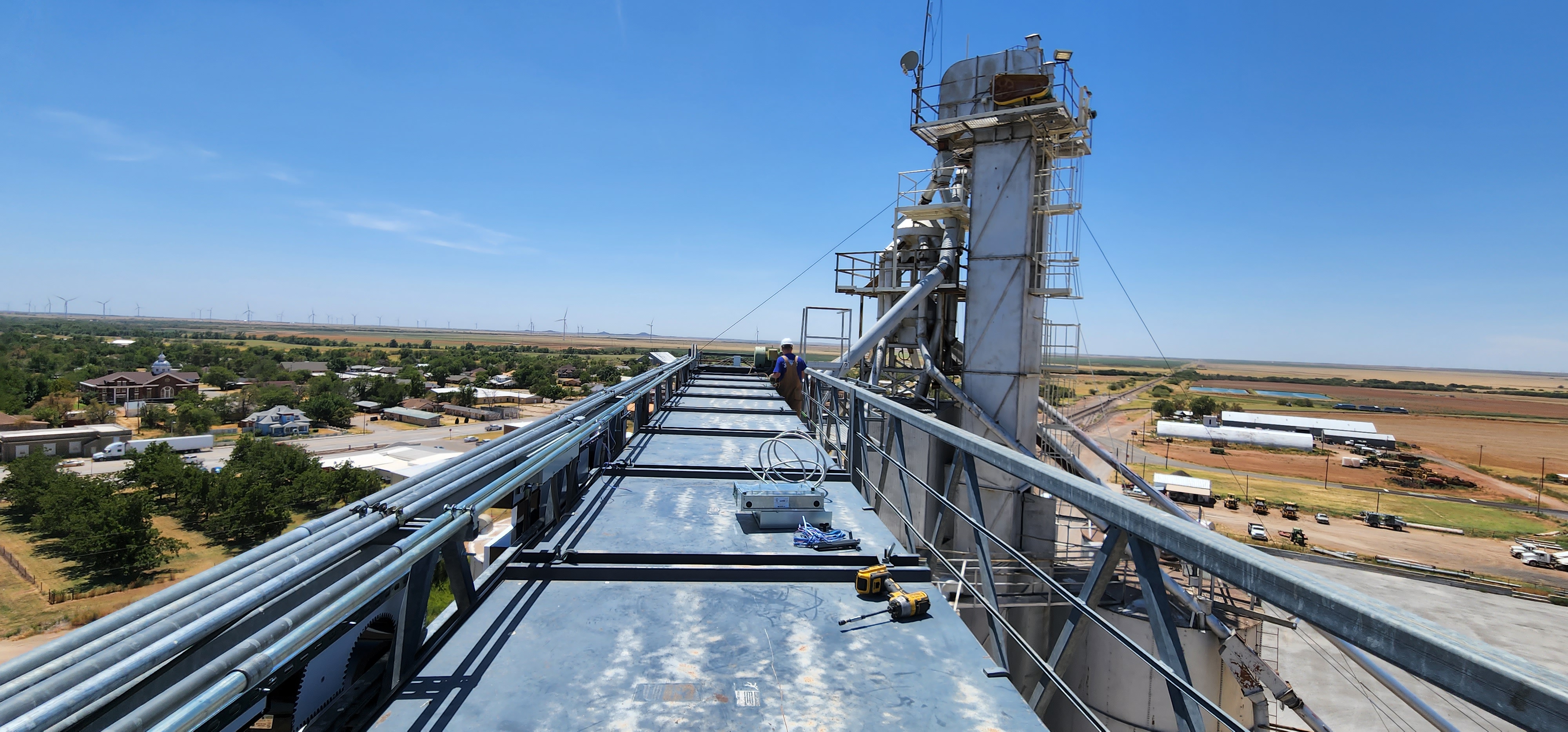

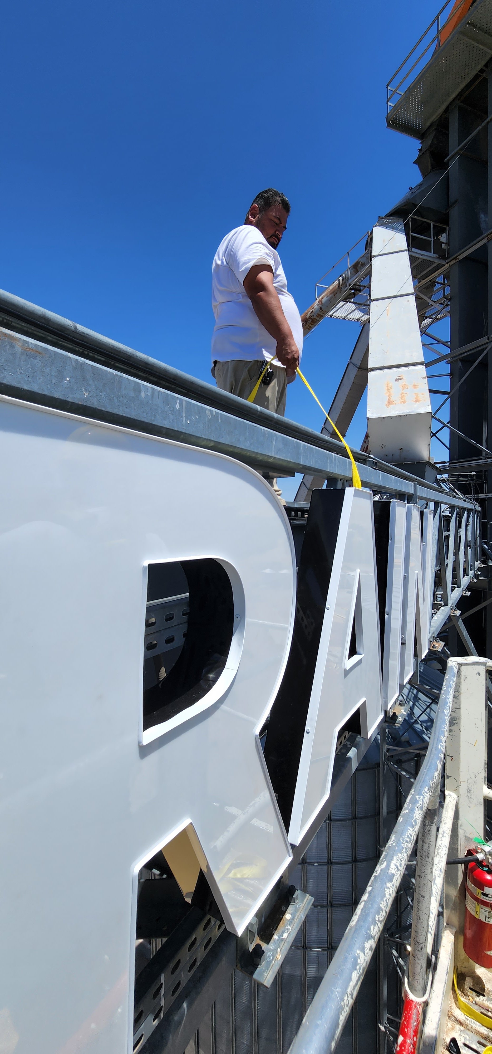

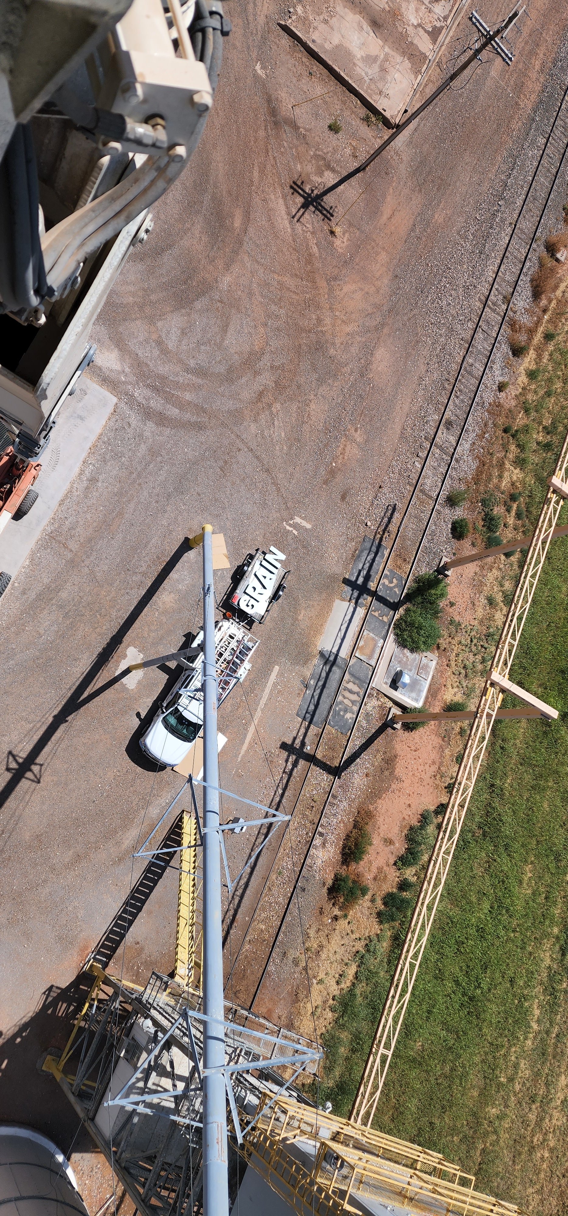

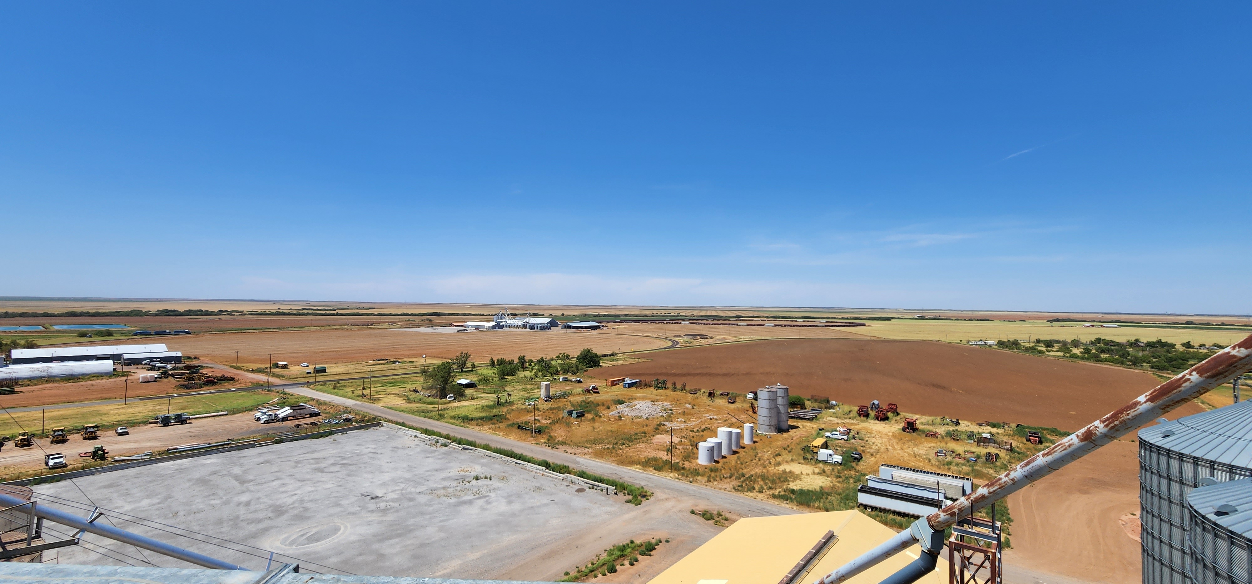

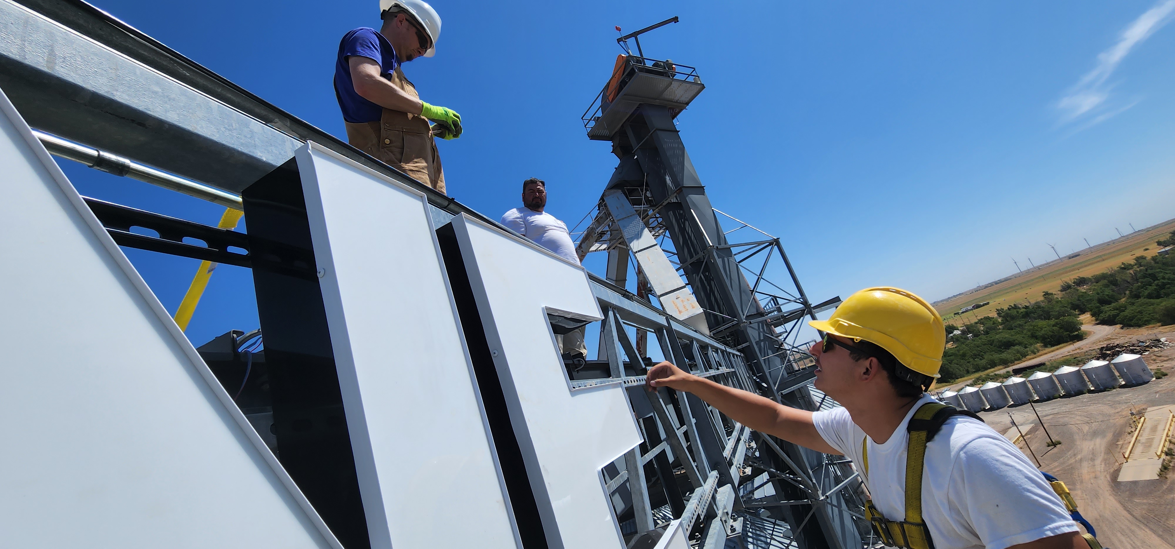

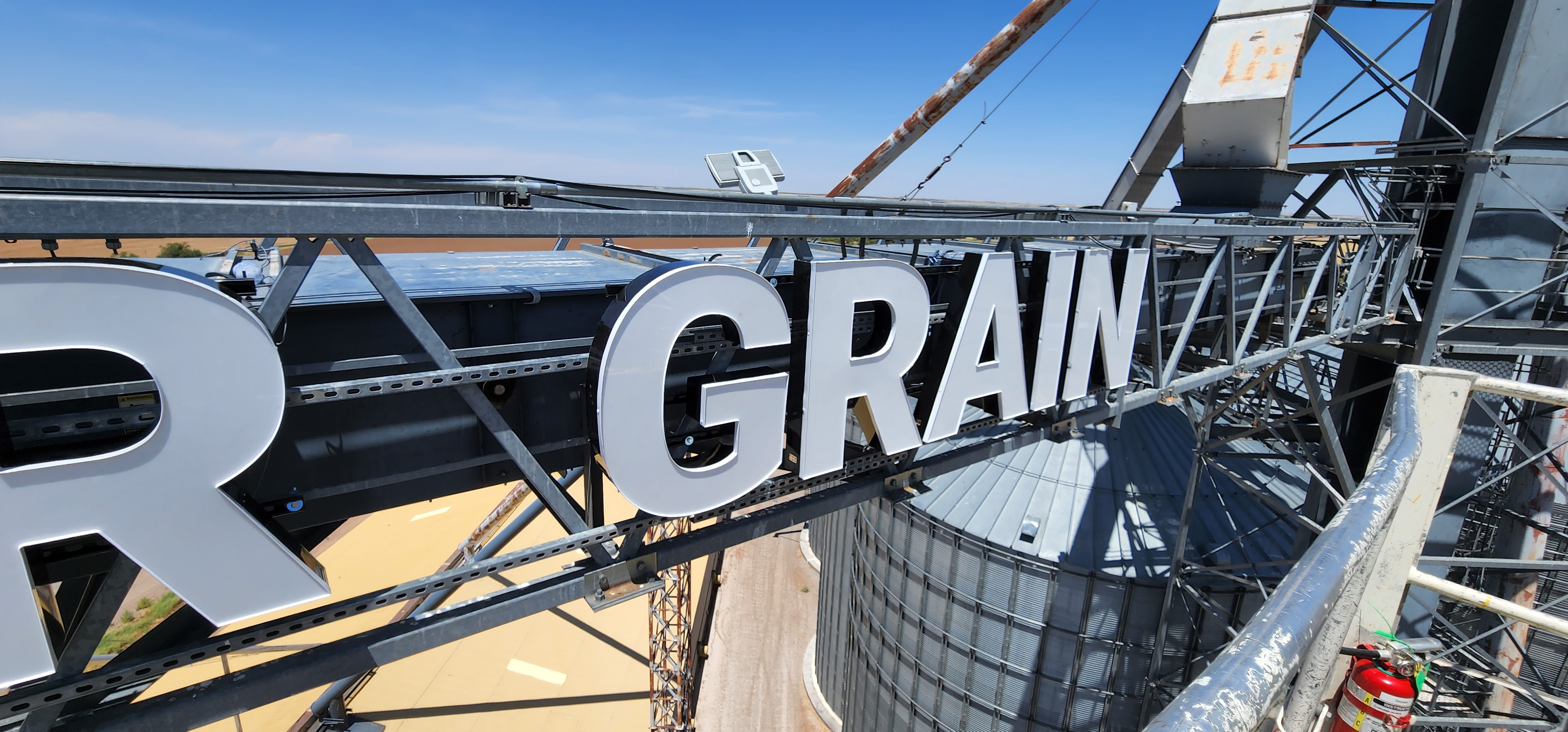

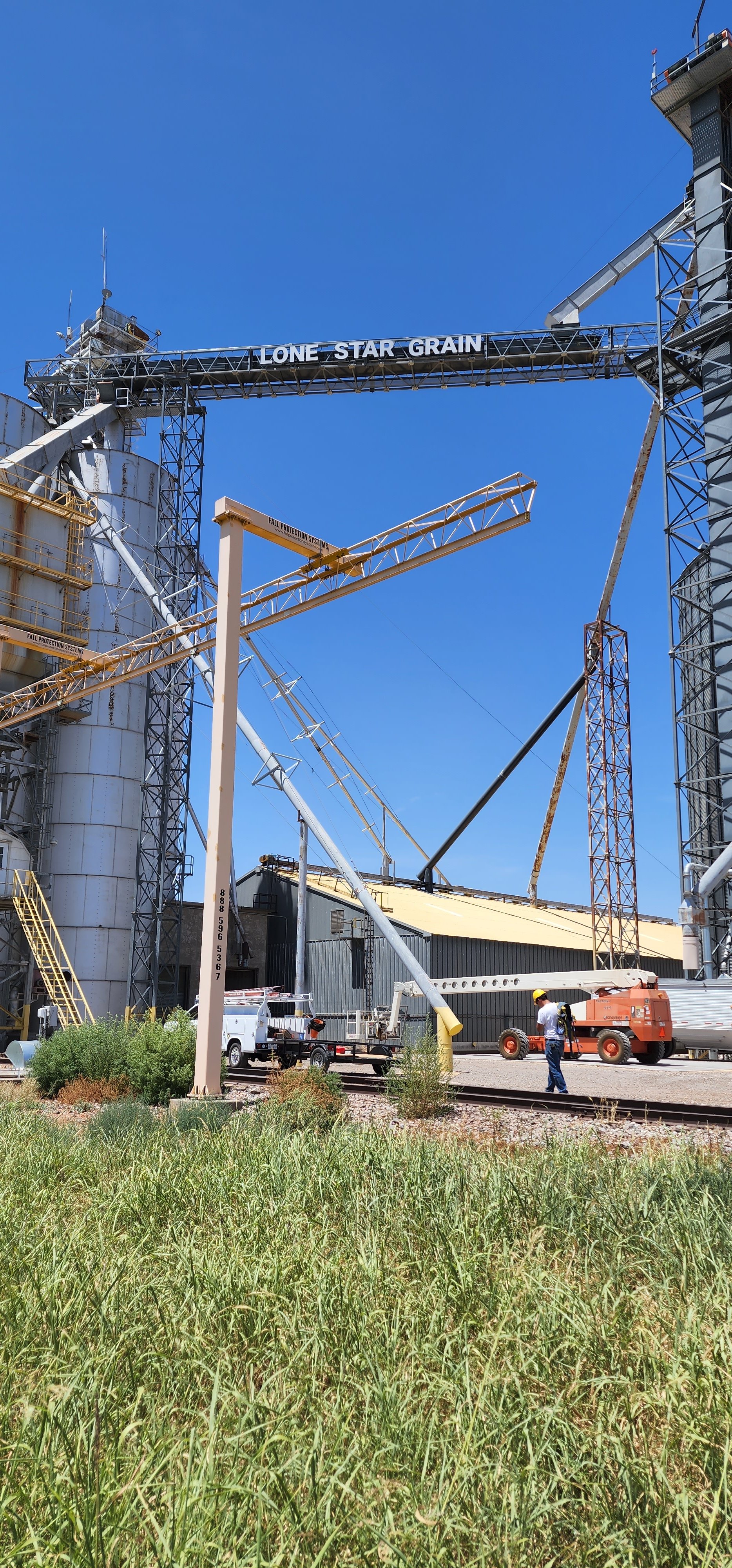

120' to be exact. We had a constant 30+ mph wind which made things more interesting, but otherwise the install went just as planned. We strapped each set to the front of the boom, and then the two guys on the catwalk hooked on to the letterset and held it while we backed off and drilled and bolted on. One issue we had was the boom was 126' working height, and we were 120' so it was fully extended with little wiggle room. The only way to move it was to drive it.. which was really fun from that height. Is it perfect? No, but from the highway it looks decent and client paid the balance this morning.

Nice clickbait Tex ;) ... nice sign work too! I got a touch of vertigo just looking at your pictures.

How come mr big doesn't need a harness up there ?? Do they figure if he falls, he'll just keep bouncing til he gets to milwaukee ??

You don't need a harness on the catwalk I don't think.. to get up there you have to take a really small mine shaft looking elevator, and then climb a series of ladders.. you could get the harness caught on things doing all that I guess. Still made me nervous thinking I was going to get blown off.
He looks like he'd get caught on things anywhere he goes.
Job looks great !!! :thumb:

It's not really a catwalk is it? I think you're supposed to have a harness on, I would. My fatass would make a big splat

Nice work Tex. Bet your glad thats over with.

Client owns the lift and I did the site evaluation from the boom and catwalk. (It's actually a conveyer belt that move grain from one silo to the other) And yes, they would lean over the side to help push the drill because the lift would move back and forth and made putting pressure on the drill to get though the beams difficult.
Yes, power was already up there.
