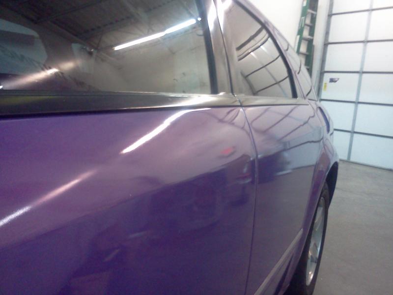

The customers car doesn't unlock with the key remote because the cars battery is dead. It's a 2006 Dodge Magnum with shaved doors(no doorhandles) no keyhole on tailgate, doorjams are tight and it's sitting right smack in front of the bay door...so everything stops until i figure this one out! I'm trying to explore my options here, any help would be greatly appreciated. ......just one of those bad weeks.:banghead:

Get a long thin screwdriver, fiddle with the hood latch til you get it popped, shouldn't take more then a few minutes. Throw a battery charger on it at high amps, then try.

crawl under the front end. Reach up there with your hand or an extension tool. Pop the hood.

By default in my previous life as a hot rod builder we would install manual latch devices for situations such as this. the latch should of been moved to the body and a pull rod should be located underneith the car. Hate to say it but if this was not done it was a very poor installation by some half pot crack body shop.

I will call him as my last option because i have a feeling he's gonna try to make me pay for it if someone needs to come out. I don't see anyway of gaining entry. Thanks guys...i will try popping the hood with a screwdriver

A friend of mine who does body work just did some shaved handles for a customer. He installed a hidaway key under the car so if the battery went dead , he could open the trunk. Inside the trunk was a lead to the battery so it could be jumped from the trunk in case something like this happened.

Everything was turned off...i just think it has a weak battery. As told, I hit the unlock button on the remote and the drivers door pops open, but when i did it this morning, i just heard a click, click, click..then nothing. I'm working to see if i can pop the hood. I don't see any other alternative.

for all dodge magnums, it is in the rear deck with the spare tire, you would need a torch to get to it from underneath

I don't know specifically about a 2006 Dodge whatever but if you're desperate on most cars you can slide underneath the thing with a set of jumper cables and hook the positive cable to the huge battery lug on the starter solenoid on the starter motor. Connect the other cable to the chassis. Now you should be able to jump the thing sufficient to open the door.

Also, you can always borrow a set of wheel dollies and roll the car out of your way for now.
