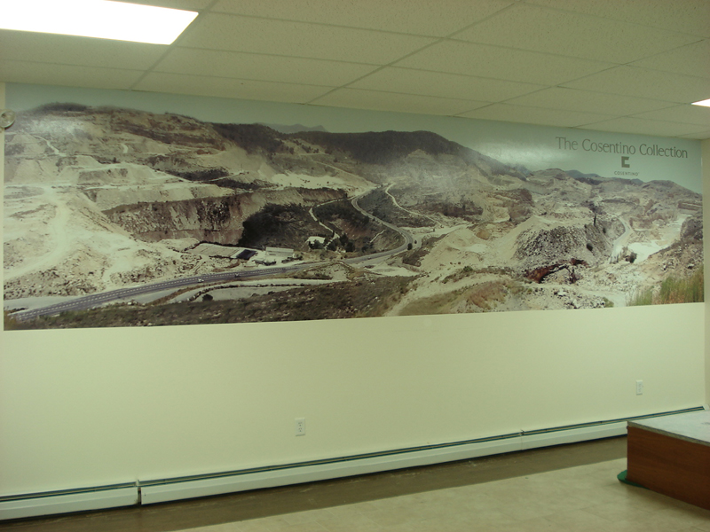

We got it done using 72 dpi pix taken with an Ipad2 and a little help from photoshop. :) No more pixels and one happy customer! Just wanted to share! Thanks for all your help!!

LOL...they are great customers...I'd never tell them to go pound sand...plus last night putting it up, they provided the beer. ;) Good custahmiz!!!
He gave me the go ahead with the pixelated one...so they were so happy to see what I had done to it.

I took the actual photos that he sent me (72 dpi) into Flexi and fit them together so they lined up, increased them to 47" x 12.75" tipped the photos so I could get a good slice out out of the middle of it and exported those as an EPS. Opened them in Illustrator, converted so I could open in PS. Then I opened them in photoshop and changed the resolution to 350dpi and at that res it was 75" x 17". There I cropped it to my size, added sky and grass as needed with my clone tool, played around with the levels to get a good deep color to it. Changed the coloring so it all matched (each photo was a different color!) using various tools including the burn, dodge and airbrush tools. At that point, printed a sample and it was insanely pixelated. Took it back into PS, played around with the watercolor tool and can't quite remember why I reverted back to the regular photo and then I actually ended up using a gaussian blur to eliminate the pixels and on this particular photo, it worked like a charm. The water color was pretty good too, as I remember - I think I went with the blur tool because it still retained it's 'photo' feel. The final print was printed at 20' x 5' at 150dpi and up on the wall, it doesn't look blurred at all, it really looks great! That was my biggest concern...it looks far better than a bunch of little squares!!

In the countryside of Macael, Almeria, Spain...where ever that is! LOL. They said it was absolutely beautiful. The quarry is Cosentino - they make Silestone. I think I deserve new countertops. HA!
