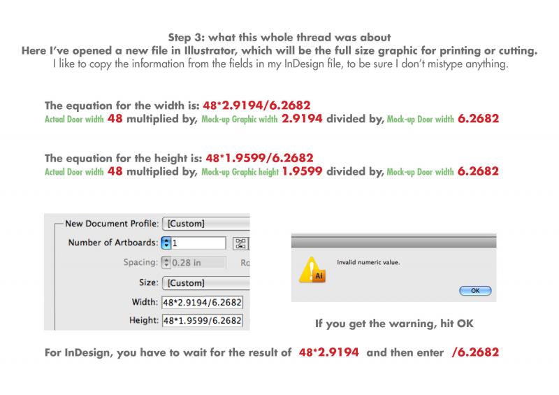

GypsyGraphics
And here's the example i should have given in my opening post.
FYI: the 48" dimension is just a ratio... that number would apply to anything on the page... whether horizontal vertical or even at an angle.. it just establishes the scale.
attachment.php
attachment.php
ok.. this took me awhile to grasp... now I got it.
48" is not a ratio, but 48" divided by 6.2682 is!
that's why those two numbers both appear in both your formula's... because those are the real door, and the measurement of the door in your mockup & it's from those two numbers that you get your ratio. (in my mind I call that a multiplier) ...and those two numbers result in 765.77.. which can also be expressed as saying EVERYTHING IN YOUR MOCK-UP WILL BE ENLARGED BY 766% ON THE ACTUAL TRUCK DOOR!
I tried your formulas in the width & height fields for a new document in my illustrator CS4 (for PC) and it wouldn't work until I included parenthesis, to help the program sort out one calculation at a time. I also moved the 6.2682 next to the 48, because that just helped me to think of it in the terms I usually do my calculations in myself.
so, I entered:
(48/6.2682)*2.9194 for width, and (48/6.2682)*1.9599 for height & sure enough I got an art board that was just perfect for enlarging your graphic by 766% :clapping:
