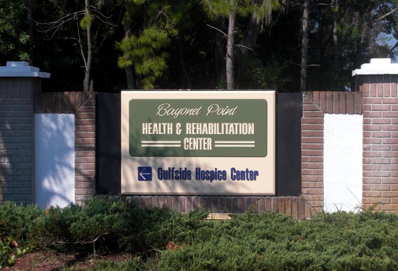

Designed, made and installed two of the faces over an existing blasted sign that was there before. Bayonet Point is inlaid prismatic lettering on raised panel with the Health & Rehab v-carved into the face. Gulfside copy is raised flat fat inlaid into the background. Overall size is 4'h. x 6'w. and 2" thick. All PVC and acrylic latex finish.
They really need to refinish the brickwork if they want it to look good.
