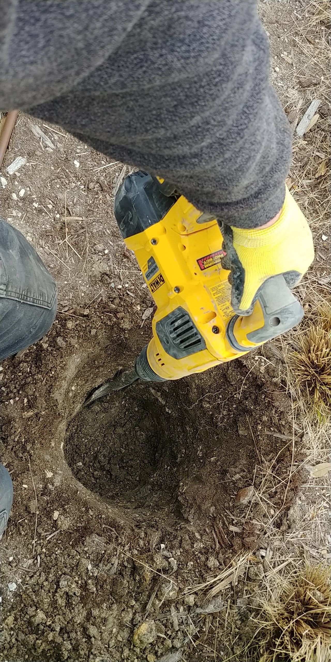

I've tried a hammer drill in dry clay and it's like concrete...doesn't break up. I have a breaker bar on the truck and that's the only way I found

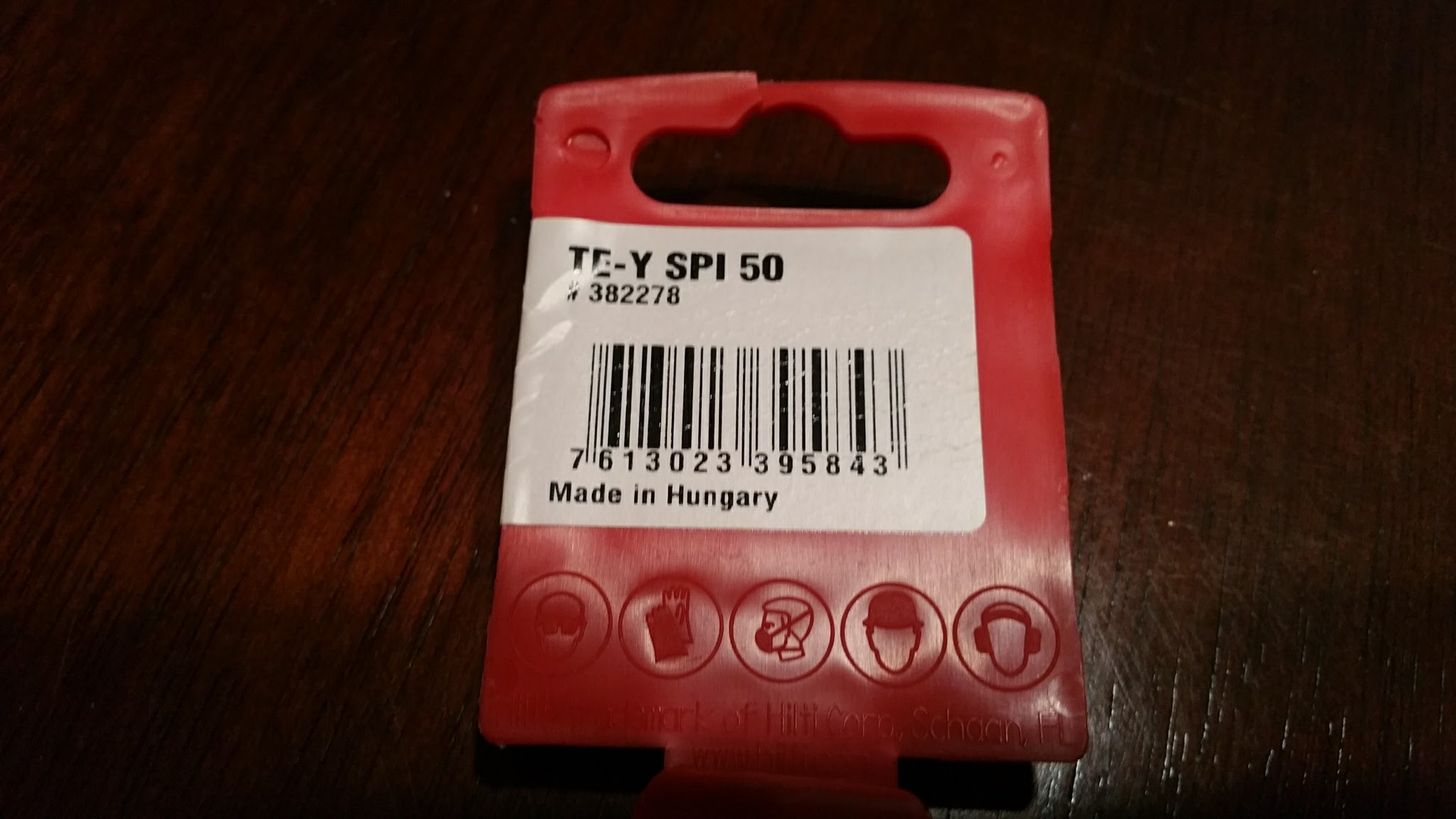

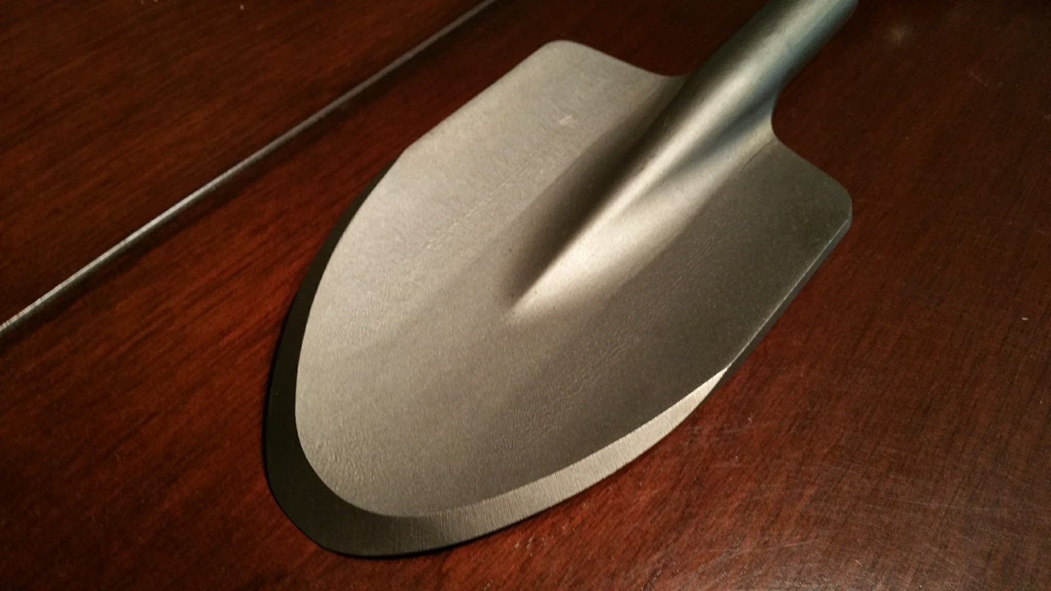

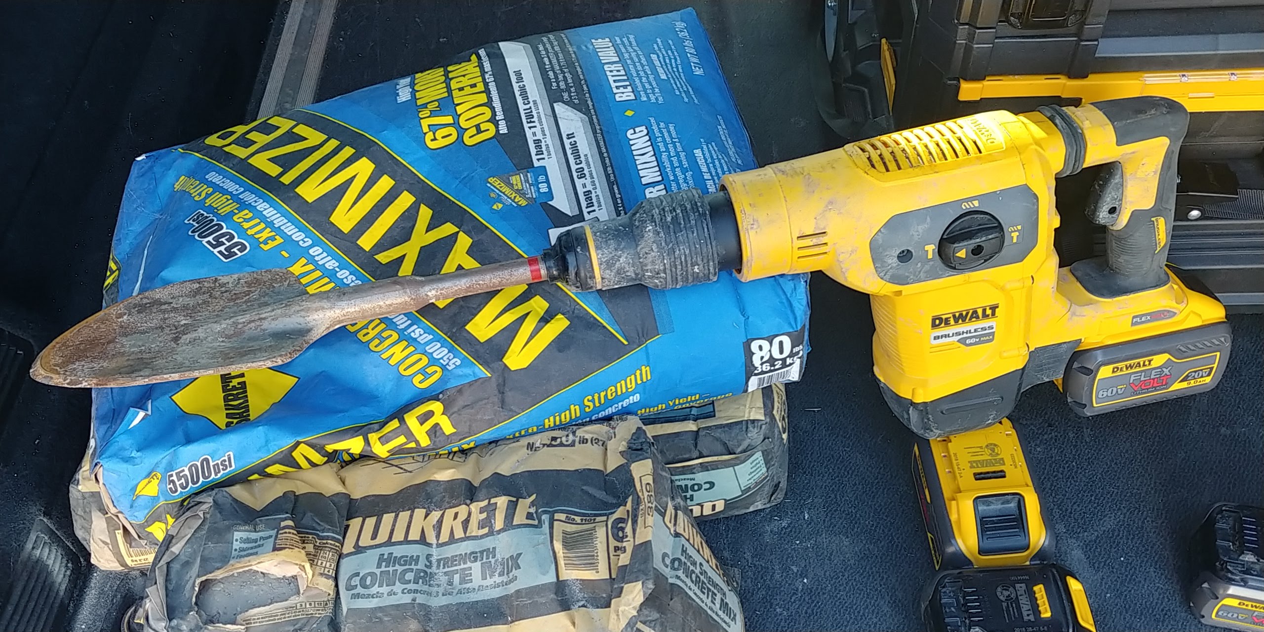

I use a cordless 1-9/16" rotary hammer with a Hilti clay spade bit (part number is pictured if interested). Works pretty well on the rocky stuff.
20181210_085904_HDR.jpg 20180216_150833.jpg 20170531_141233.jpg 20170531_140715.jpg

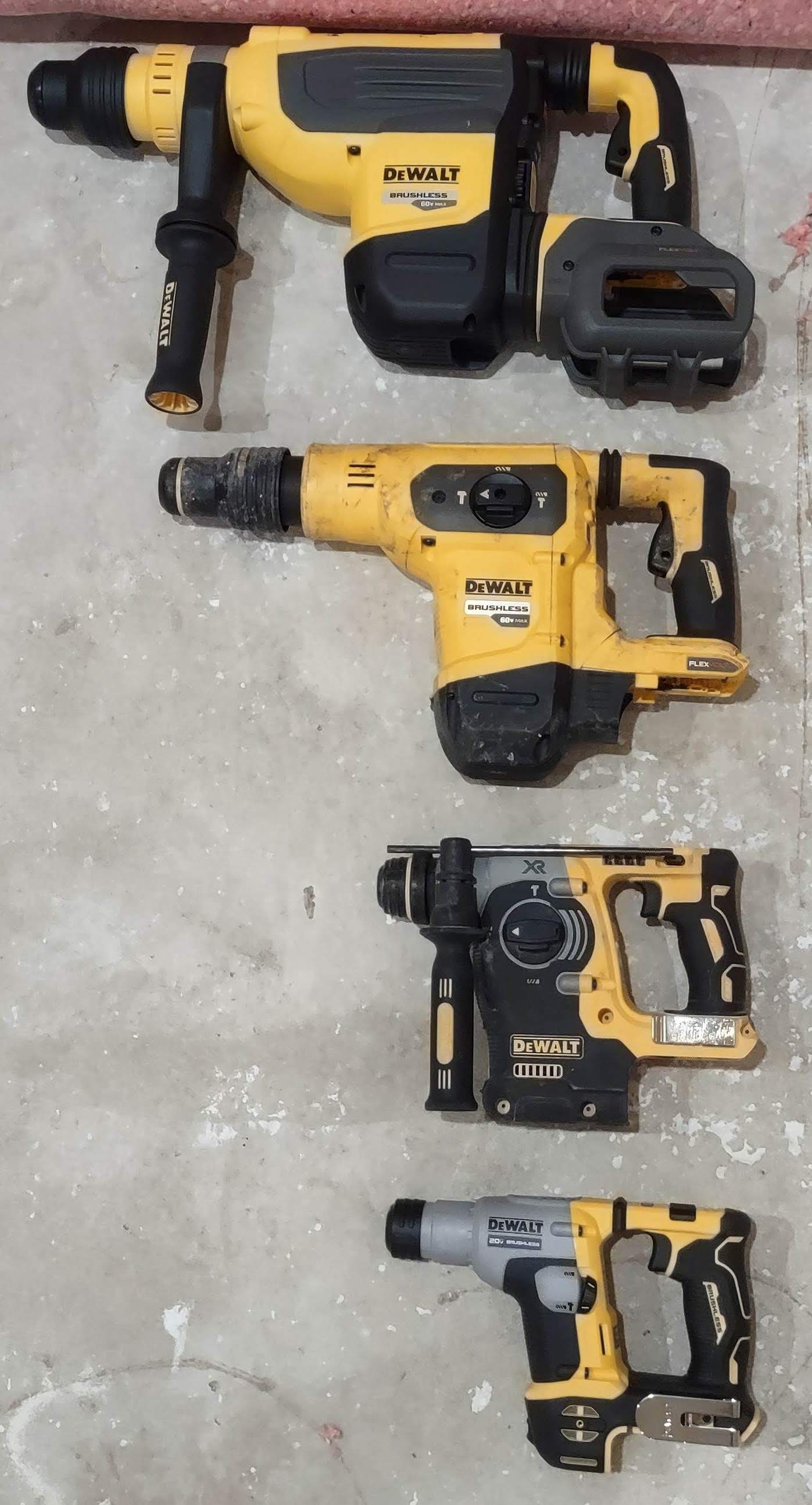

Also have the 1-7/8" rotary hammer that I may switch to. Bought it for a project and wound up not needing it and haven't decided whether to keep it or sell it. Here's the whole fam:

I have the second one from the bottom .maybe that's why it's weak? The one on the top looks like an animal.
Moze
Second one from the bottom is great for holes in concrete. How exactly are you using it to dig holes in dirt? With chisel bits or something?
The top two are more meant for dirt work, light demo work, etc.
Moze
Chizel bit. It's like pissin in the wind with that drill The top one looks like it could get the job done though.
Oh gees. I wouldn't dream of using that smaller one for any dirt work. The top two are meant for it though. I'd give you a good deal on one of the top two if interested. I would just need to figure out which one I want to part with.

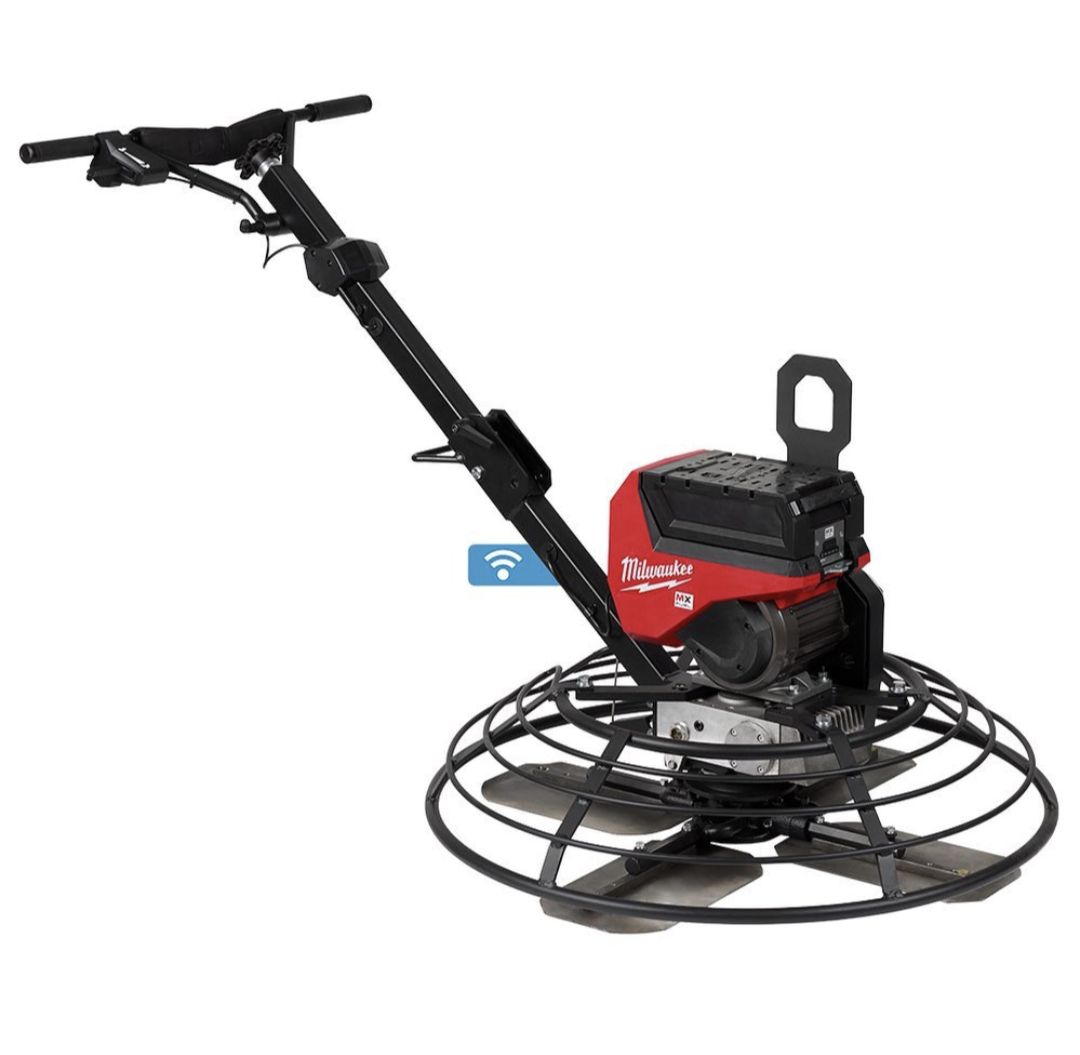

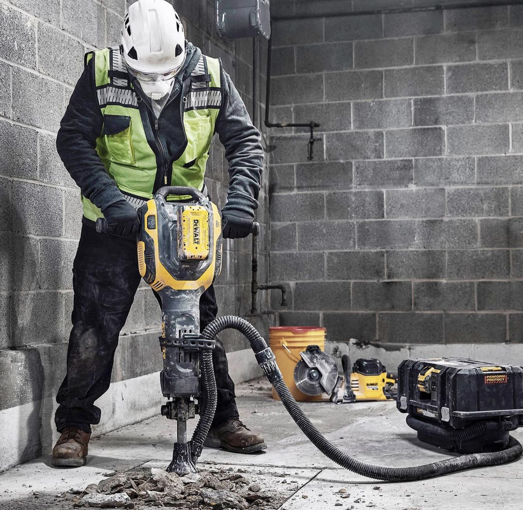

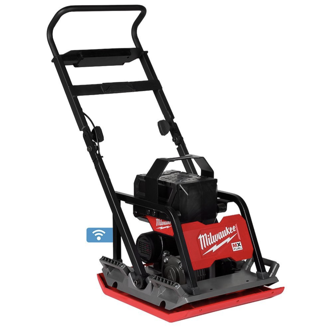

Saying "cords are dead" was obviously a bit tongue-in-cheek, but that's where things are headed. California is on the verge of outlawing gasoline powered outdoor power equipment. So the push for battery powered is huge right now. There are battery powered options now for riding lawn mowers, edges, blowers chainsaws, etc. that are far quieter but perform nearly as well as their gasoline counterparts. They require virtually zero maintenance, no gas, no oil. The initial investment is more, but long term, it's a no-brainer.
Battery powered tool technology is getting crazy. Look at the recent World of Concrete showings. Battery powered concrete trowels, tampers, concrete saws, chipping hammers.....these are all "full size" tools. No one running one of these on an appropriate sized job is ever going to wish for gas or a cord and generator. There are obviously some instances where they'll still be required, but for the most part, most would prefer cordless if given the option.

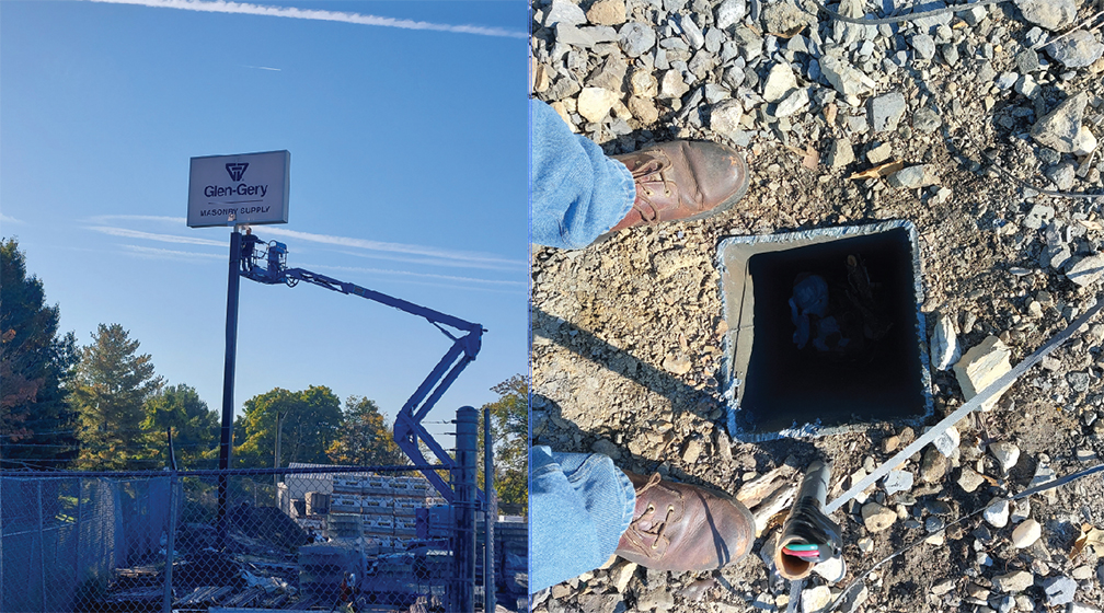

Would you cut or burn it down ?? We cut the sign off and it took about an hour. After that, we did it in 3 sections and we burned it. All total, from cutting to loading in the truck, about 3.5 hours.

I'd use a cordless recip and a Diablo Steel Demon blade. It would blow through the stub pipe and the square tube like butter. No generator, no cords, no torches, no tanks.....a cordless recip and a blade.

Yeah once or twice. That's the problem. I bought an electric sawzall because I got sick of battery swapping when I was reskinning our shop.
