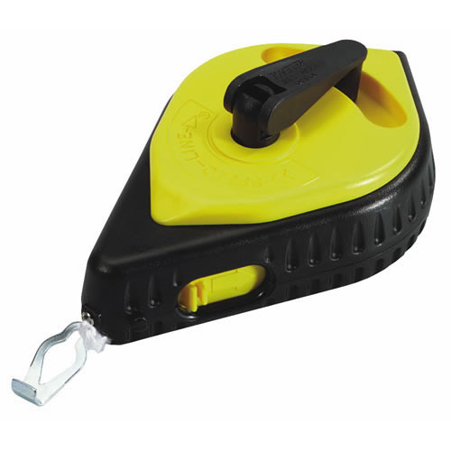

Chalkline, yes.
Billct2
Don't go over the chalk. Or if you that concerned use the chalk line to apply a masking tape straight line, then wipe off the chalk and pally the stripe.
