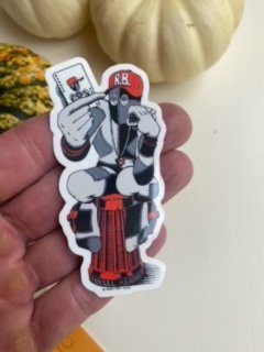

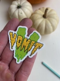

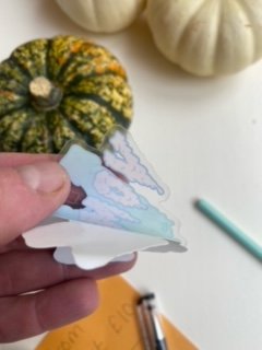

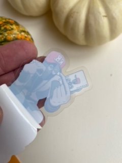

Im wanting to print stickers like the ones below, transparent with white base and laminated.
Ive read nothing but negatives regarding printing white on Inkjet.
Do you think these which i had done locally are printed on a UV machine?
