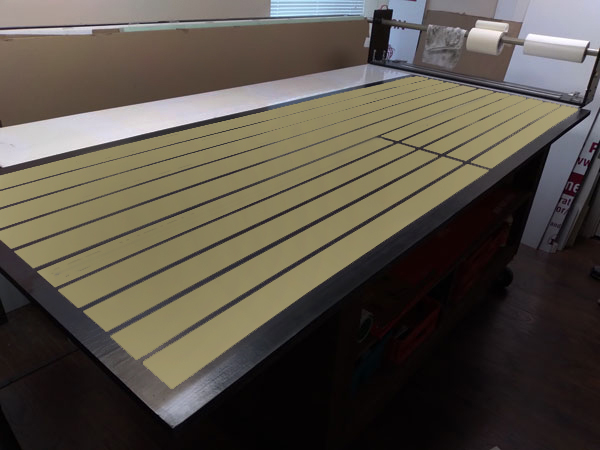

Got sucked up with a doozy, wondering how others would have handled this.
Contacted by a property management company to update an outdoor directory sign for a commercial building. Remove a few tenant names, install a new one. I checked out the sign - each tenant "plaque" was a strip of cut vinyl 40" wide with black cut vinyl lettering on top, all applied to a painted sheet of signboard, both sides. At the time I didn't see any red flags so I took on the job.

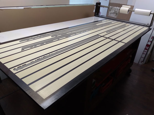

Fellers listed that color in stock by the yard, but when I finally went to order it was 50yd rolls only from manufacturer. Luckily I found 5 yards from another supplier which was enough for the job. Day of install I started working on it onsite. The black lettering didn't want to come off easily, pulling up chunks of the vinyl below. A past tenant had already gouged their plaques trying to remove their name, so I was planning to just pull all the strips off and lay all new vinyl down. Two hours of this on a ladder out in the sun was enough. Called in my installer to pull the panel down and finish working on it in the shop. All together I probably spent 7-8 hours total between cutting vinyl, removal/cleanup, three trips to the site, and wondering the reason why the shop before me made a directory that's extremely difficult to update. I was too far into the job to stop and consider a Plan B. It should have been designed with removable plaques that can easily be re-lettered.
For those more experienced, if you had encountered a directory like this how would you have approached it? Give the customer the option of paying for all the labor of what it took to update, or propose a brand new panel with removable plaques that will save a ton of time and money in the long run? The building has at least 20 tenants and I don't want to go through this again for the next batch of turnover.

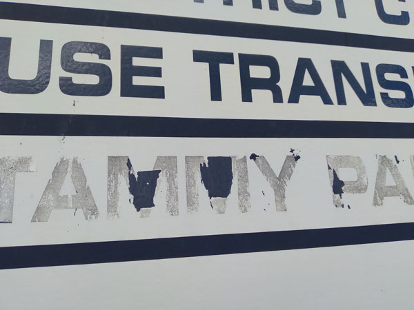

I don't think you can ever count on removing vinyl lettering from the top of other vinyl. Maybe when it's close to new, but once that adhesive has had time to cure, it's going to pull up the vinyl under it.

I wasn't counting on being able to remove the lettering, but didn't think removing the strips would be such a PITA. Here's what was left after a former tenant went ballistic on removing their name.
