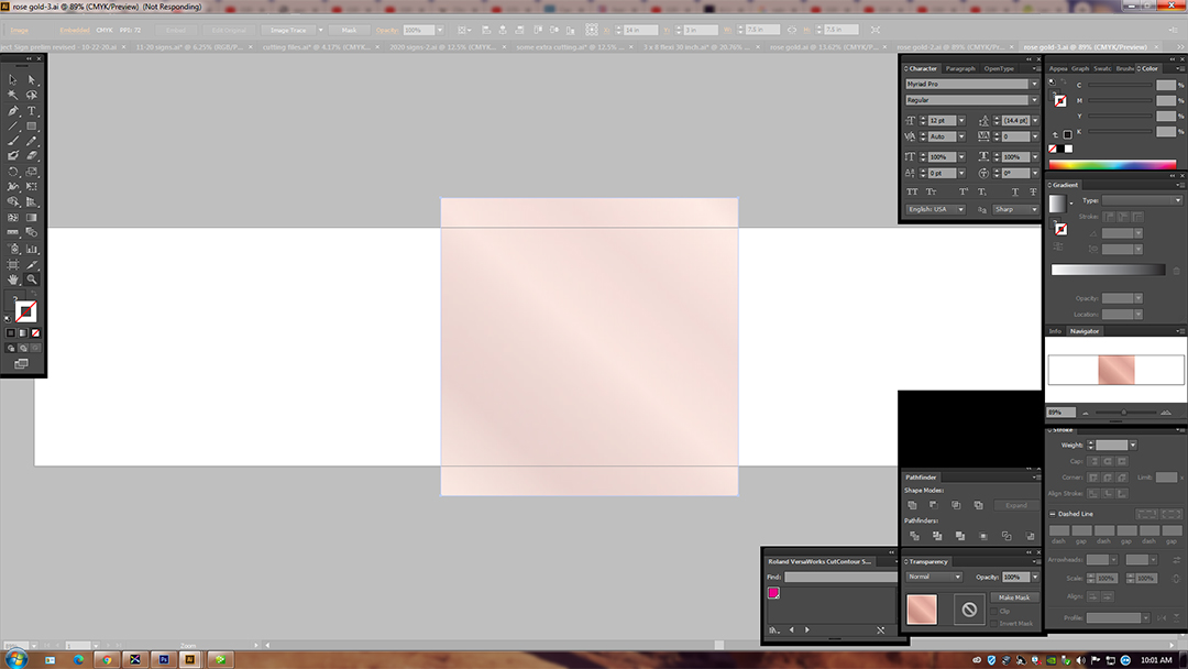

Here...... it just did it again. This lasts for maybe 1/2 minute, then returns to normal.
Have 32g of ram and got a nice video. I use my older computer far more than the new one, cause it's always crapping out on me, but only in Illy. It's CS6. Older setup. Never did the cloud thing. The new system is the lastest 10, while the old one is still 7.

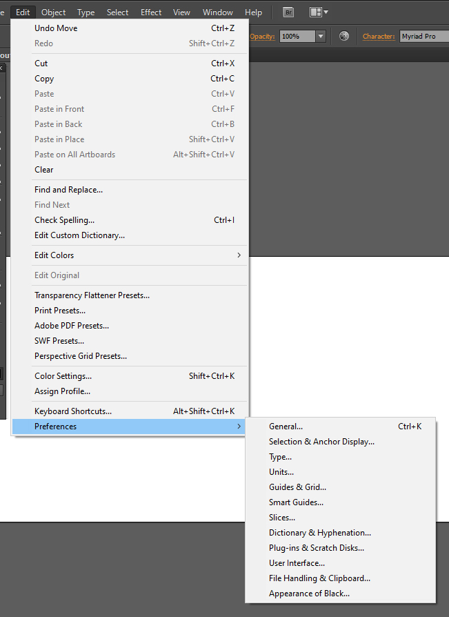

Doesn't appear I have that, unless I'm too dumb to see it.

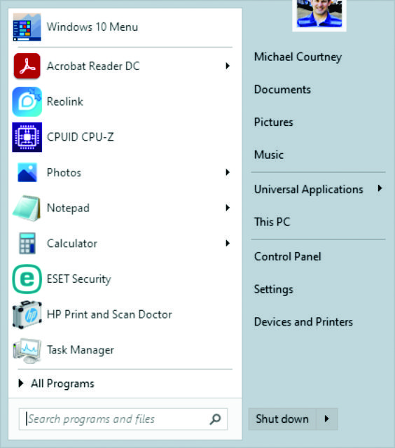

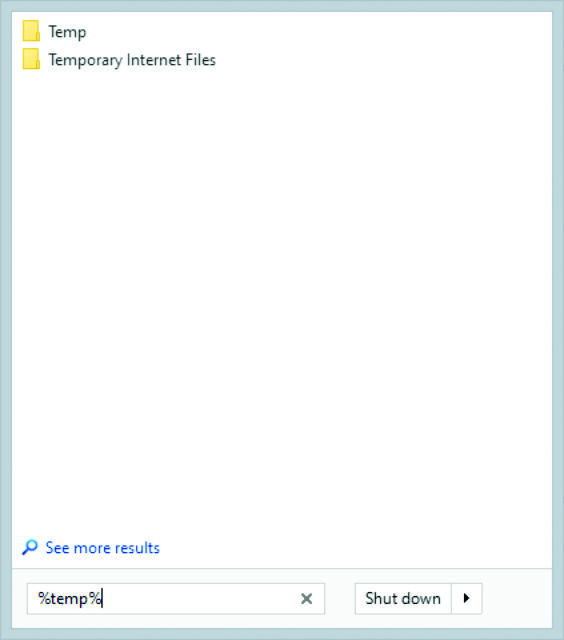

Some other things to consider; a bad stick of RAM can do things like this, if you're doing something complex a low-powered or bad power supply can create voltage fluctuations and cause problems, not enough memory, or scratch disc space, and as I have said before, delete your temp files regularly. Every time you install a program or it crashes it leaves behind a temp file that can cause havoc.
Computers are like people, they have a personality based on the hardware and software installed and they get cranky as they get older...
