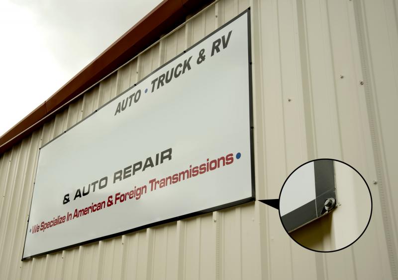

Here is a 10' x 5' aluminum sign on another building in town, it's screwed directly to the corrugated metal building without any frame, they painted the screw heads black and applied black vinyl to the perimeter to make a boarder.
I have seen this type of sign before, why would you need an additional metal frame?
Can you give me a little more info on what type of frame and how it's put together?
:help

we usually have aluminum frame made to the size of the sign using 1x2 square tubing with some verticla braces the sign is screw or riveted to the frame and the whole thing is installed. if there is a joint we make sure a brace is directly behind the joint
Having a frame made takes all the wavyness out of aluminum signs and on dibond or maxxmetal it allows you to have a cleaner joint. We then use 2-3" tek screws to affix to corrugated building.
Billct2
We use 1x1 aluminum tube and use connectors that are made for the tube, they can be screwed or popriveted. We also usually bend a raised frame for the sides from .040.
It just looks better, more finished. It also lets us use brackets to install it so we don't have ant screws thru the face.
That sign looks cheap, nothing wrong with that, but it looks it.

In the pic it looks like a single piece and not a seamed piece. If you have a seam and it falls in open space to 2 pieces wont line up and wont look professional.

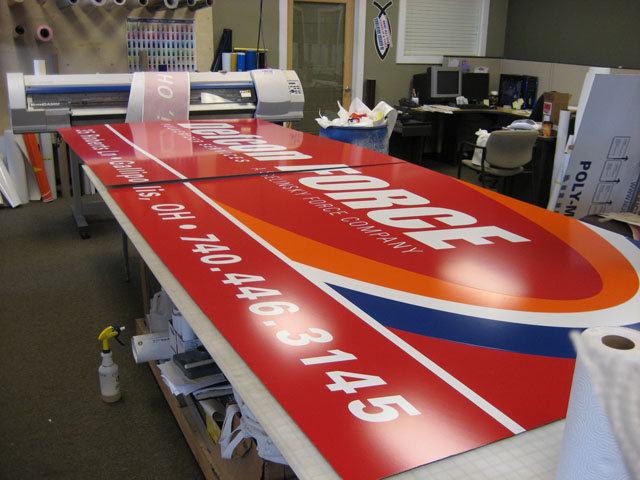

I cut the two pieces separately for each side of the sign in Illustrator with about 1" overlap on the seam edge and install the first panel, then I use my large table to sit the two panels beside each other so that the seam/edge/material all line up correctly and tape the 2nd piece down. Then remove the first panel and apply the 2nd substrate.

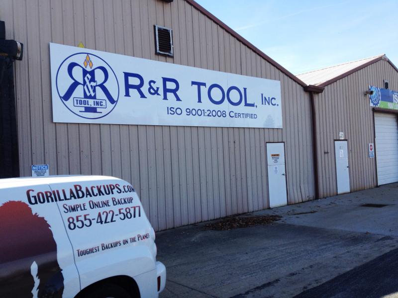

Are you doing the install? You need some treated 2x4's and good anchors; first mount all of these to the building studs and then you can screw the panels to these boards. Makes the large sign panel install easy & easy to replace if the customer ever wants to change a panel.
Here is a 5x24 from a few months ago & a sign from a previous employer where I used the same process (red/orange/blue cut vinyl on white; two 7x5 panels to make a 5x14')
Also, always paint your screw heads to match.

I really like the red/orange/blue cut vinyl on white sign in your photo, can I ask what size was the vinyl and HOW you applied the cut vinyl, in the reflection you can see it is applied perfectly (no bubbles), looks like screen printing.
Did you have to splice the vinyl, and if you did, how much do you overlap?

Thankfully, on this sign the bottom area was separate from the top area (white line running horizontally). A little design tweak that saved a PITA install. This was 48" wide vinyl material. I overlapped about 1/16" on the colors; thankfully they had 3 of these large signs, 6 trucks and 4 or so trailers that all received the same cut vinyl colors. (those big rolls are pricey)
The vinyl was applied wet with rapid-tack on the red sign's panels.
On the white sign the vinyl was applied dry with 1/8" overlap is specific areas of the big circle to minimize overlap visibility.
It's not too hard; most important part is to be SURE your panels meet up exactly, if they end up being a bit off, make a small manual exacto adjustment to one of the panels. ;)
