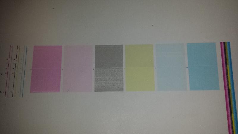

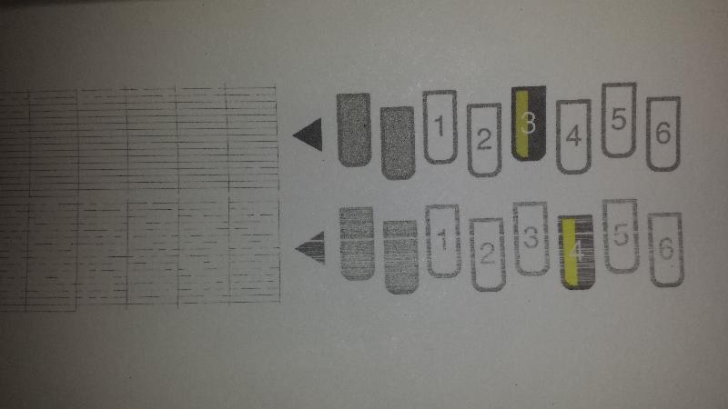

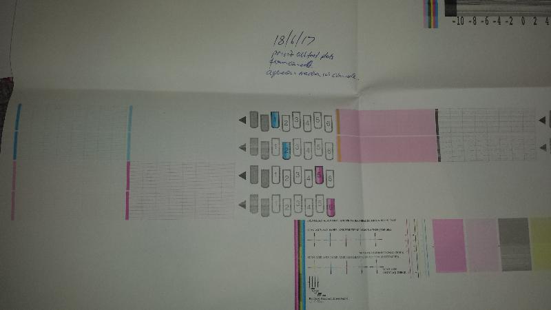

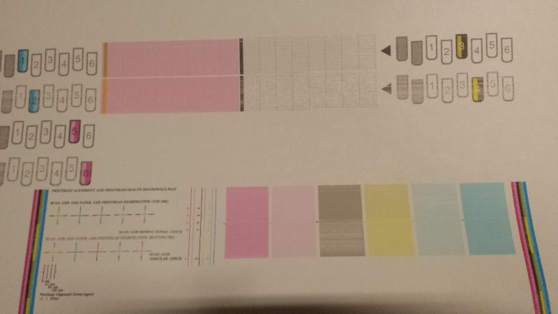

L25500-17June2017-183722_Small.jpg L25500-17June2017-183717_Small.jpg L25500-17June2017-183719_Small.jpg L25500-17June2017-183720_Small.jpg L25500-17June2017-183721_Small.jpg
Looking at that, There's a pink block to the right of the 123456 numbered test tube shapes, and I thought that pink block should be yellow. (1st & 2nd pictures)
(or is it meant to be pink/magenta with an orange left edge ?)
Looking at the Nozzle Check blocks,(3rd & 4th pictures) the upper yellow square is murky with black in it, but the lower yellow square is clean, yet the lower black one is streaky with clogged nozzles or missing lines.
Thanks for any advice. Does this mean both black/yellow print heads may be crook?
IN the meantime, I'll go and run another head cleaning cycle...

after 10 head cleanings of the k-Y heads, it's printing an 80% cleaner yellow in the top line, and reds, oranges, yellows & greens are much closer to PMS expectations than the muddy misses they'd been looking like before.
Turning All ICC profiles on, was better than all profiles off, which gave a washed-out look..
