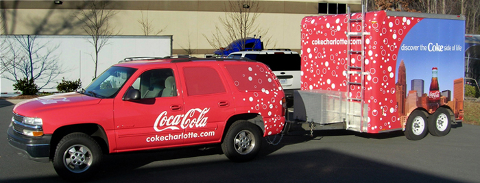

Anyone print a coca cola red yet? Is it possible?
Yes on a trailer and a tuck. Turned out well I think. It is never perfect, but so long as it doesn't fall on the orange or brown areas we and the client are happy. In our case it was a nice coke red. Again I'm sure not "the" coke red though.
jkdbjj
I am sure the photo won't do it justice, but all went well on the Coke Wrap.
