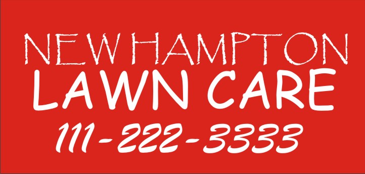

AKwrapguy
Hello!
I recently made a truck logo for a company and the customer is being critical about it. He isn't sure of the colors but I'm stuck with what else to do. Any input would help.
Thank you!
So, here are the issues that I see off the top of my head.
First it's too big for that door. Maybe look at reducing the size about 50%
It looks like you have three or four different fonts. Try to limit it to 1 main font and a similar one for the phone number.
For lawn care I wold agree that green would be the go-to color but on a red truck it doesn't work well. maybe look at changing the color scheme to something that will pop off the red like maybe white/grey's or yellow orange .
That's it for the big changes...
For the more nit-picky things....
For me the tree is very feminine and doesn't match the rest of the logo
The grass and tree should be the same color so that it flows together
Try taking the 'free estimates' and 'fully insured' and putting them on the same plane, in an all caps font (something san-serif) and have it under the phone number and increase the kerning to like 100 and see what that looks like maybe use a '•' (alt+7)in between .
The phone number looks like it has an inner stroke and an outer stroke? Trying doing an just an outer stroke.

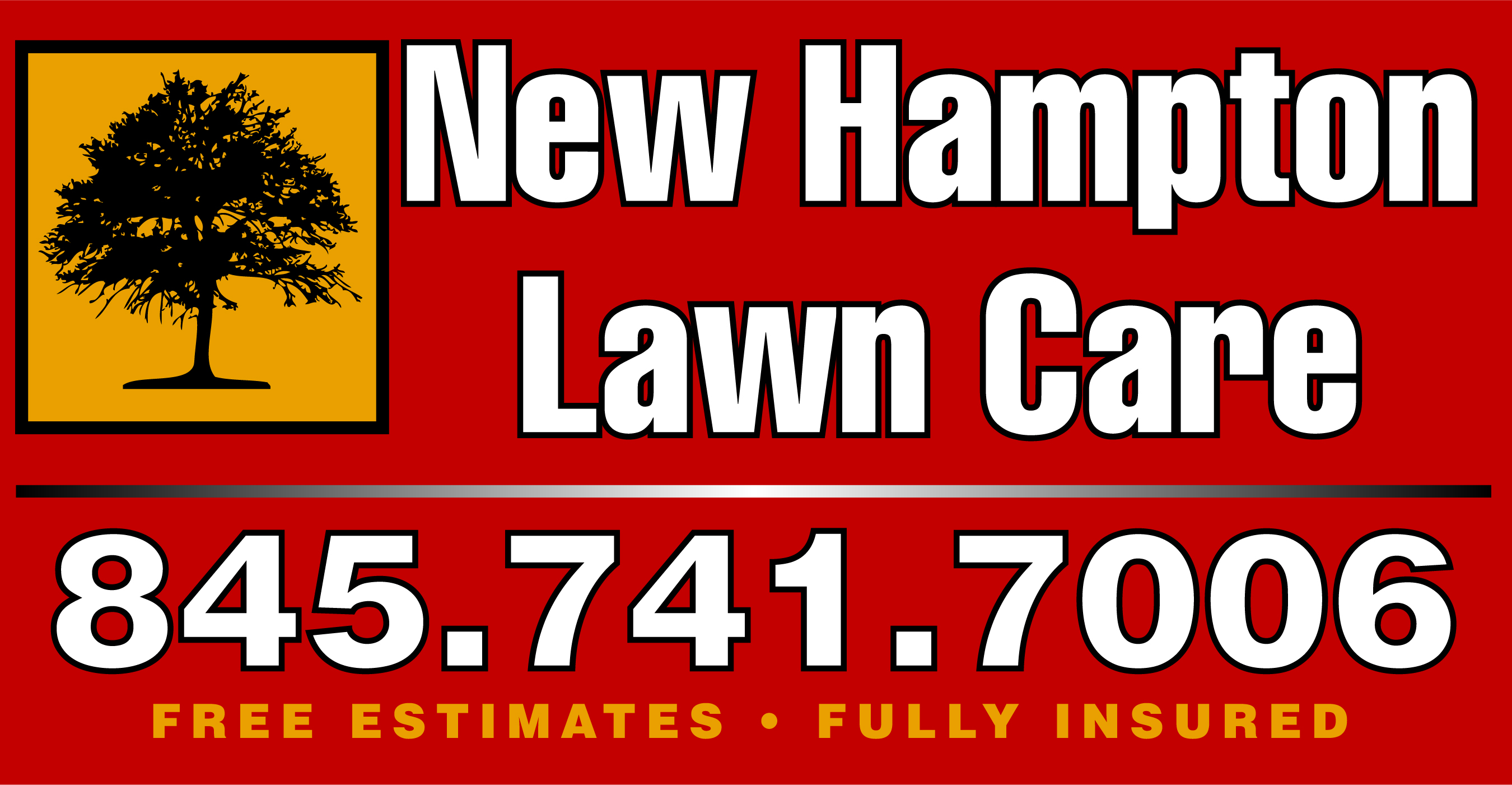

AKwrapguy
Here's a basic layout
Mosh
That one belongs in the letter spacing tutorial.
Can't go wrong using the three best fonts of all time...My cousin set this up and he can draw real good!!! Spacing? Kerning..I know not of this!!!

signbrad
LiteBriteLauren,
I appreciate that you posted your design for constructive criticism. There are a number of talented and knowledgeable people on this forum. The only danger may be that you could be discouraged by the feedback. But if your skin is a little tough you will certainly benefit.
Rick, the Certified Circle Designer, was comprehensive in touching on a number of areas that could be tweaked. I want to elaborate on a couple of points.
Logo design should not include clipart
What is a logo? Well-known designer Michael Bierut said in his book, How To, that a logo is "the simplest form of communication. In essence, it is a signature, a way to say, 'This is me.' " https://www.amazon.com/Graphic-Desi...2457686&sr=1-1&keywords=how+to+michael+beirut
One dictionary defines a logo as “a symbol that represents an organization or company, used, for example, in its advertisements or on its products.” A company owns its logo or logos. Many logos enjoy trademark protection. If someone else uses a company's logo it is likely a trademark infringement.
A logo design should not incorporate clipart. If a clipart image is part of a company logo, then how can the company own the logo? Most clipart services offer the use of copyright protected artwork and photographs for a fee. But they are not generally selling ownership of the images. They are only selling a license to use them, and the license may have limitations. For example, iStockphoto, in its license agreement, specifically forbids the use of its images as part of a logo design or a branding scheme. This makes sense. If company logo could include a piece of artwork that is already owned by someone else, then the company would be in the odd position of not owning its own logo. Further, a competing company could buy the same artwork for its logo.
A logo design should be original and not include copyrighted images. If we sell someone something that we don't own, then they can't own it either.
Of course, clipart is useful and has its place in sign work. But not in logo design.
A sign layout is not a logo, though it may incorporate a logo.
Create a hierarchy of importance
Determine what the most important element is in the composition and make it dominate. Let nothing else compete with it. Some designers call this the "entry point" to the design. It's what the viewer should see first. The idea is to control the order in which the viewer sees the elements in the layout. Things that are of lesser importance should be assigned second or third place. Think in terms of foreground, middle ground, background, like in a landscape painting. Without a clear hierarchy, a composition will suffer from elements that conflict. The layout will take on a "busy" look.
Rarely should a phone number compete for attention with a company name. A phone number should be clearly subordinated.
A good discussion of the need for a hierarchy of importance in a sign layout can be found in the book Mastering Layout, by Mike Stevens.
https://www.amazon.com/Mastering-Layout-Art-Eye-Appeal/dp/091138068X/ref=asap_bc?ie=UTF8
Choose letter styles carefully
Sign design is unique in that so much depends on legibility at a distance. Certain letter styles that may look fine on a printed page may be weak on a sign. Many of the romans are this way. The problem is that the thin strokes of many romans tend to disappear as the viewing distance increases. And using the "bold" version of a roman may not be much of an improvement. As an experiment lay several different weights of a letter in Times Roman on top of each other. You will see that there is very little variation in the thin strokes. Most of the variation is in the heavy strokes. Time Roman looks great on newsprint in body copy, but a sign lettered in all Times Roman has a weak, anemic look, and at a distance, its legibility is seriously compromised.
The difference between the thick and the thin parts of a roman is called "contrast." Letters with greater contrast tend to be harder to read on sign work and should be used sparingly. In the days of hand-painted signs, it was easy for a sign painter to improve the legibility of a roman by simply thickening the thin strokes on the fly while painting the letters. Modifying a roman today is not so easy from a computer keyboard.
