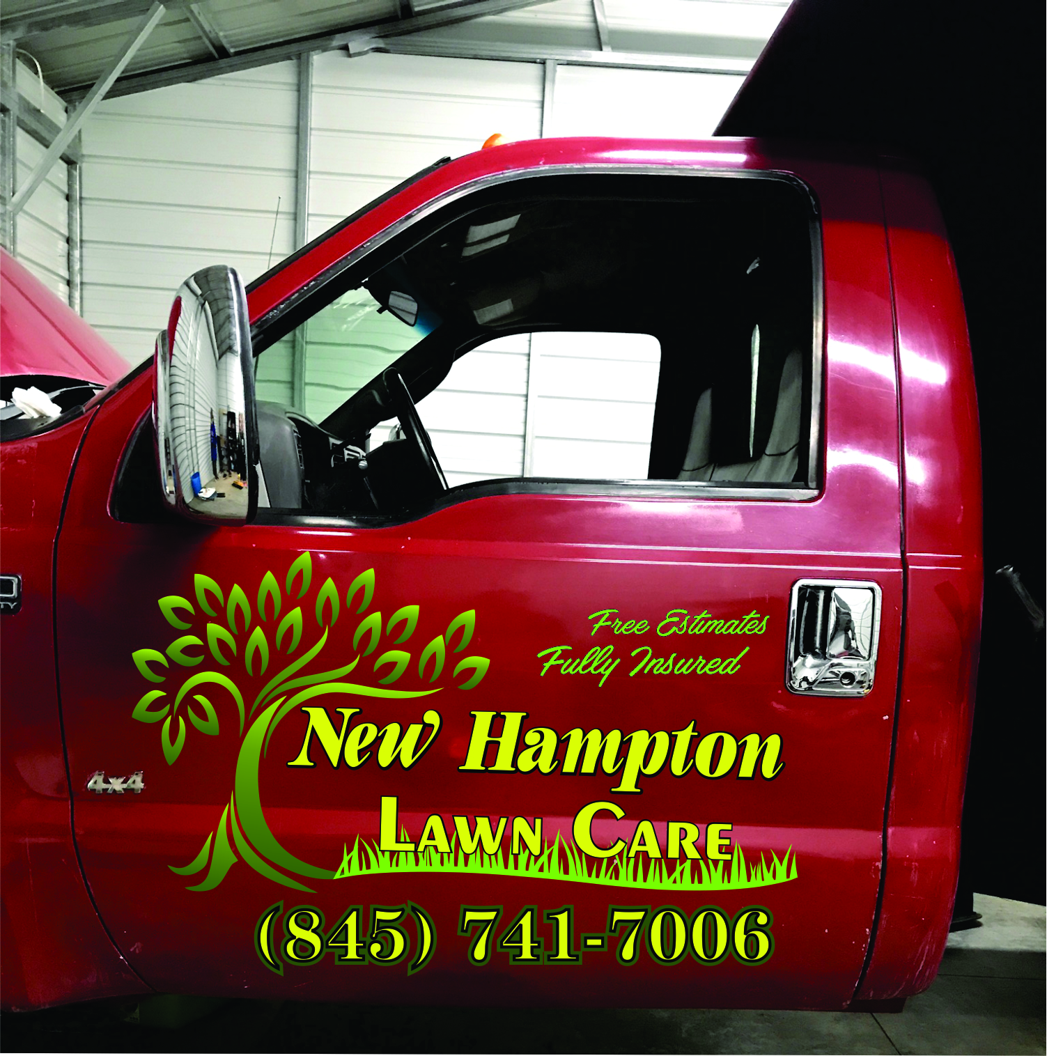

Hello!
I recently made a truck logo for a company and the customer is being critical about it. He isn't sure of the colors but I'm stuck with what else to do. Any input would help.
Thank you!
First of all, it's too large for the door area.
The colors do tend to make it look Christmas-y. Perhaps some tans and lite greens. Also, for a landscape company, those fonts look a little too wispy. You might wanna find a more substantial type style.

I think the image is too large as well but not by much. I think maybe shrinking it down about 5 inches overall would look better but its your design . And i also think there is too many shadows in the Phone #. But i personally like the colors over all. Just my opinion tho.

As for the colors on that color truck I would go with creams browns and tans. What is giving you a hard time is the green on the red. They are split complementary. Gonna hurt your eyes. If you would to use those colors how to get them so they won't vibrate as much is add a little bit of red to the green or vice versa and that would brown out your greens or reds.

First thing I noticed about this "logo" is that it's not a logo... it's a layout... very sign-shop looking (not a good thing by the way)
Sign shop logos/layouts suffer from many of the issues your layout has.
-- Poor choice of type
-- Too many typefaces
-- Clip-art looking
-- Clip-art elements not matching each other
-- Too many different type effects, I see outline with drop shadow, then a thin outline, then at the telephone number 2 outlines... lay off the effects...
-- Lack of legibility - Outlines - they make copy hard to read
-- Too crowded
-- Lacks rhythm and hierarchy
-- It's unfortunate that it's a red door, it will be easier playing with color choices once the layout is cleaned up
If it were me -
-- Make a design brief so you have a target to design too
-- Incorporate the design process - mostly, research...
-- Stop collaging like a sign shop - each element should have purpose and reason...
-- Be able to tell the client how and why you came up with it...
-- Do not use this layout in your portfolio...
-- If you are new to this, invest in sites like Skillshare and Lynda.com and magazines like Signcraft to learn the design process and what makes a good layout...

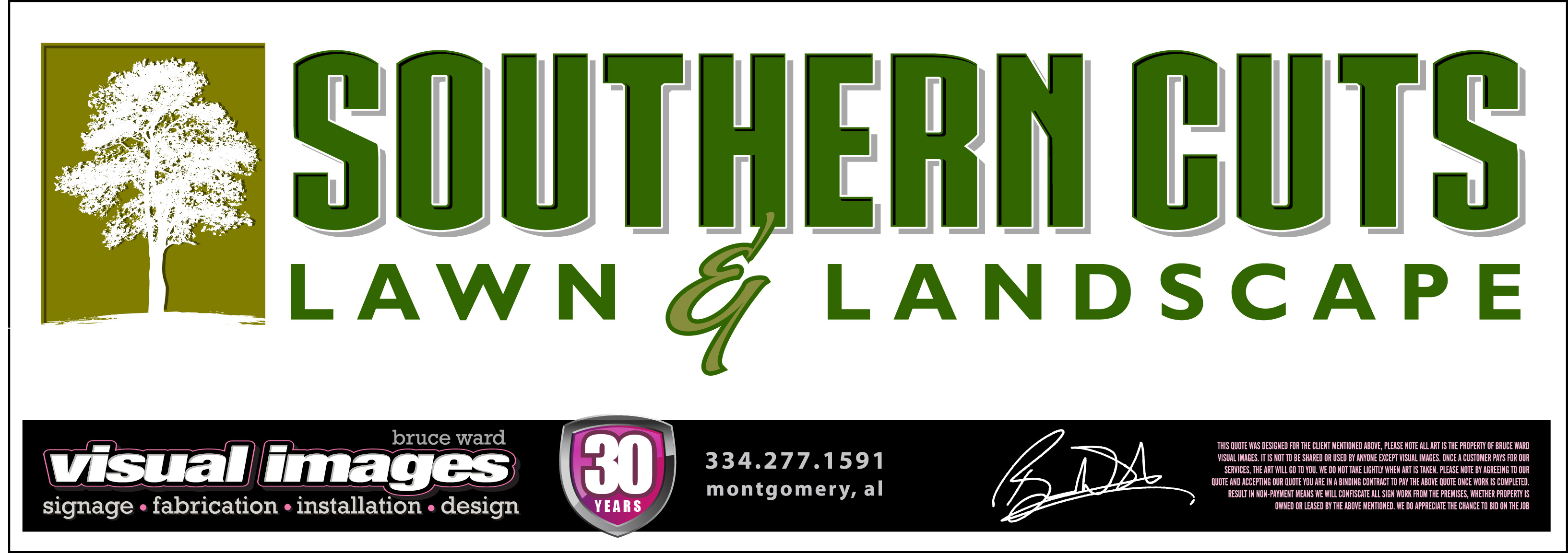

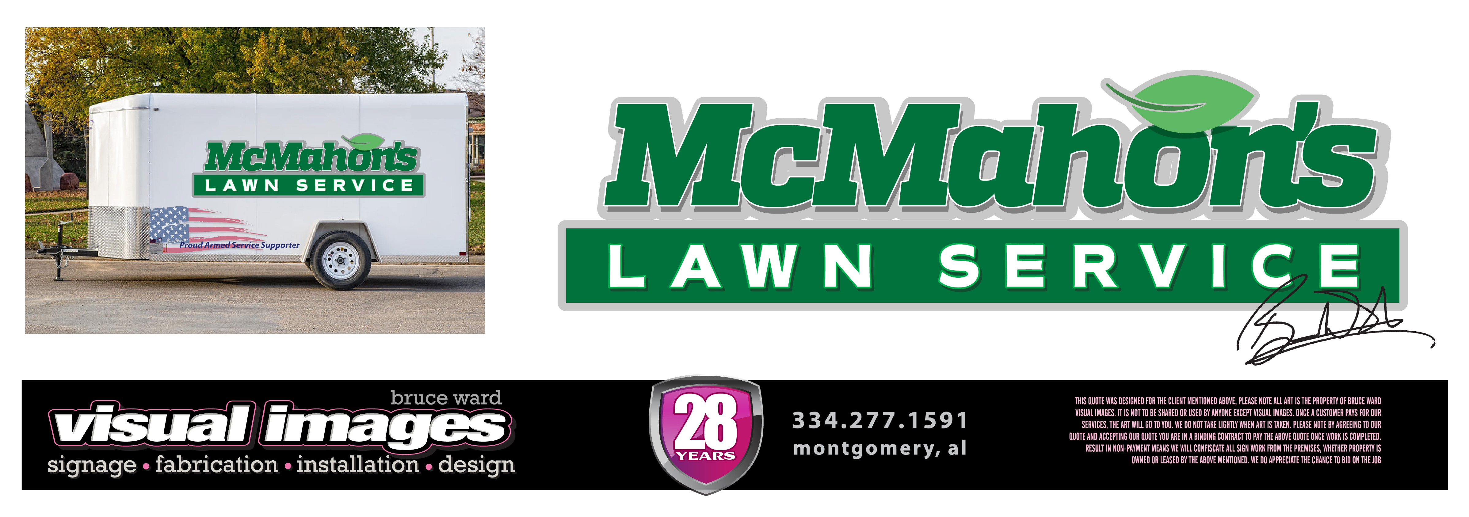

Ok, since you asked.
The fonts are horrible, all that shading is not necessary and is very confusing, its way too big, the tree is overpowering.
When I first look at this i have no idea what this company is or does.
Be simple, be clean this is not a time to be fancy. You want folks to be able to look at something quickly and figure out what it is.

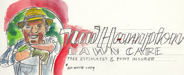

The guy drives in your shop and wants you t put a nice brand on his red truck doors. Sheesh! you guys talk him to death with your philosophy on business and layout, Toad gives him a medical history survey to fill out, come on, a quick rough and you get to work. No wonder the big discussion on minimum money on a job. You guys would take forever and all 99% of you are going to do is throw some type out there and put want he wants.
And please if I see another modern take on a tree or leaf that you saw on the internet I am going to puke.
But to tell the truth, this OP is not going to make a better layout no matter how much is said or shown. They might ask Visual800 what fonts he used and make them white to go over red. They won't use my idea because it is not a computer font or clipart that can be purchased for $49.99 this month on a special deal.

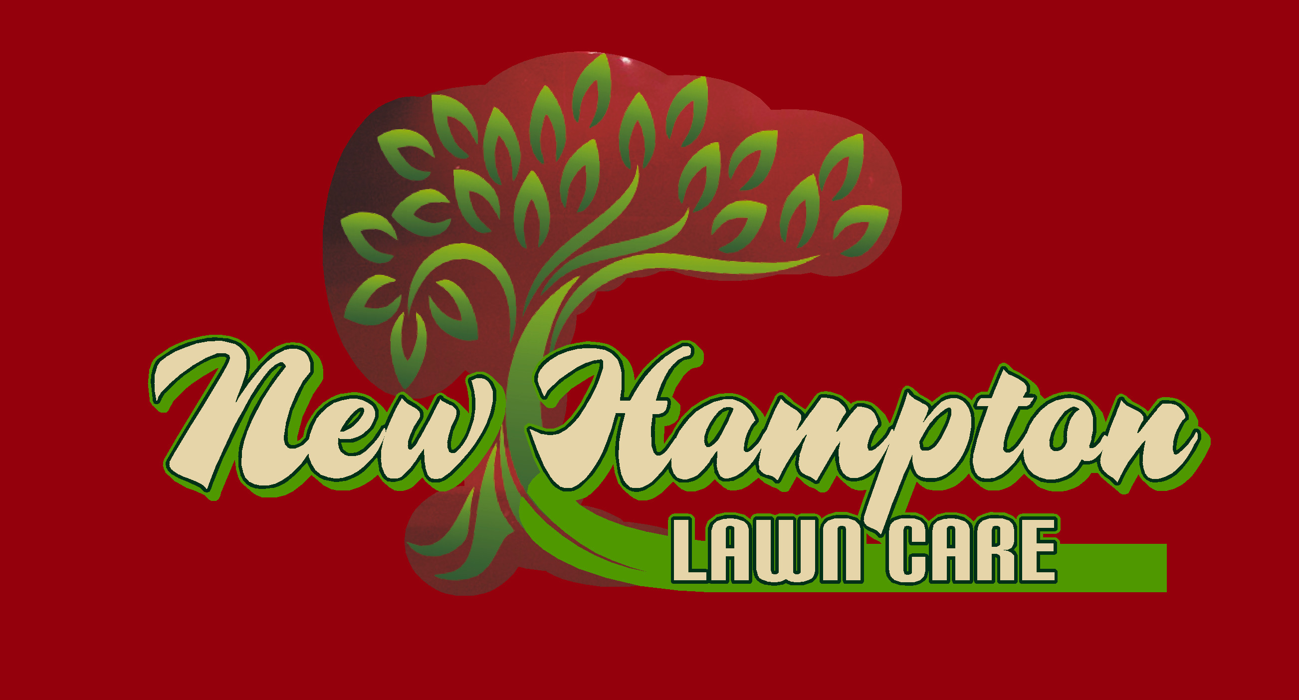

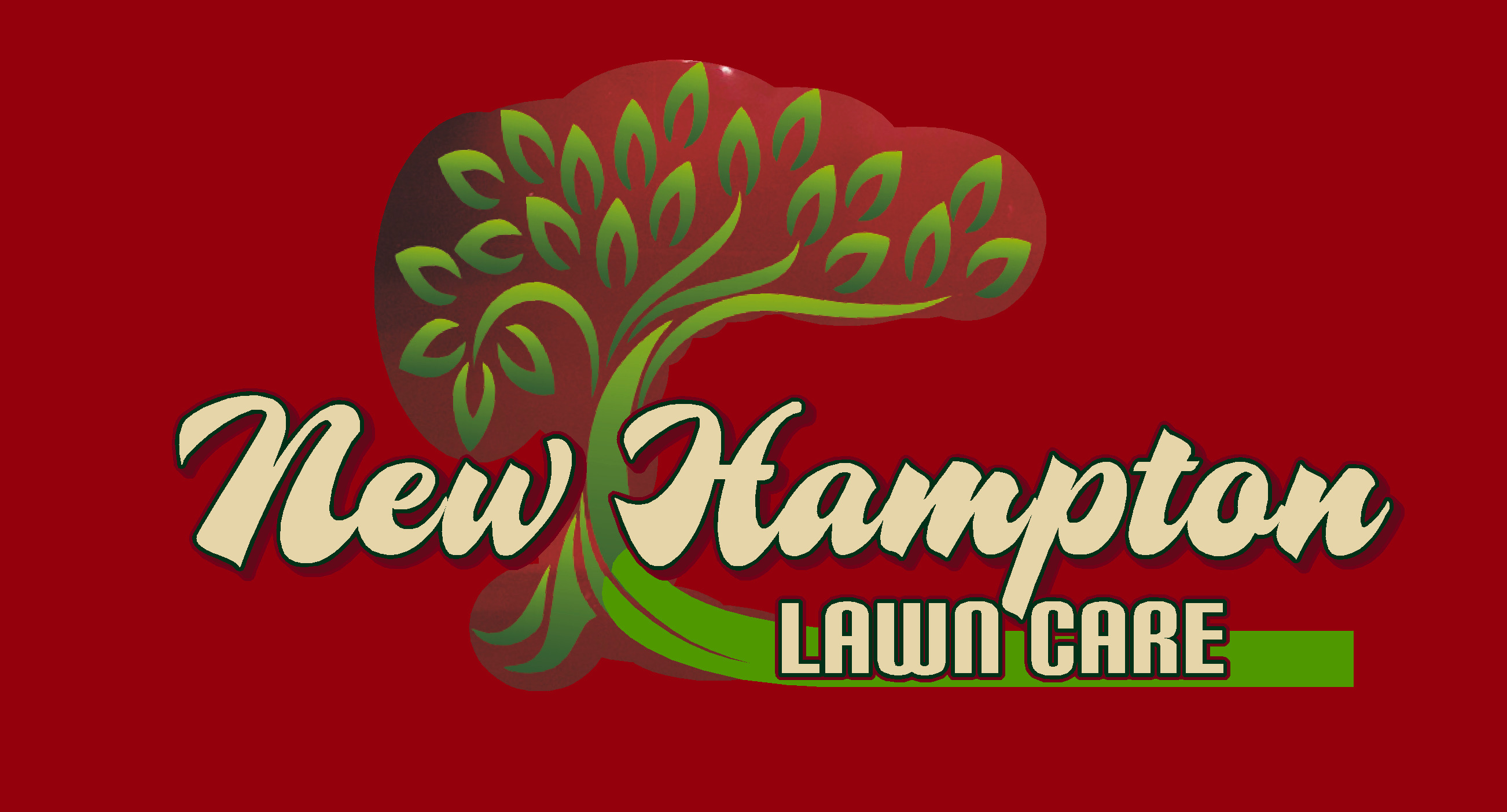

Here is a rough take on your idea. Not much better.
Some different ideas for colors. I changed the yellow to a cream.
I have some burgundy's and apple green. Apple green might be a little too much but it does match your graphic.
The phone number I would put on the hood fender.
The secondary copy I would relocate it also.
