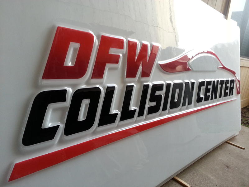

The attached is completely painted, 2nd surface, no vinyl.

Faces, out of Tennessee or Alabama is who we use for our pan faces. A lot of the time we will just get a border embossed in it and put the translucent (depending on color, not series) on 1st surface and call it a day. If it is like the photo posted before where the letters are embossed then we will just get them painted and not worry about anything.

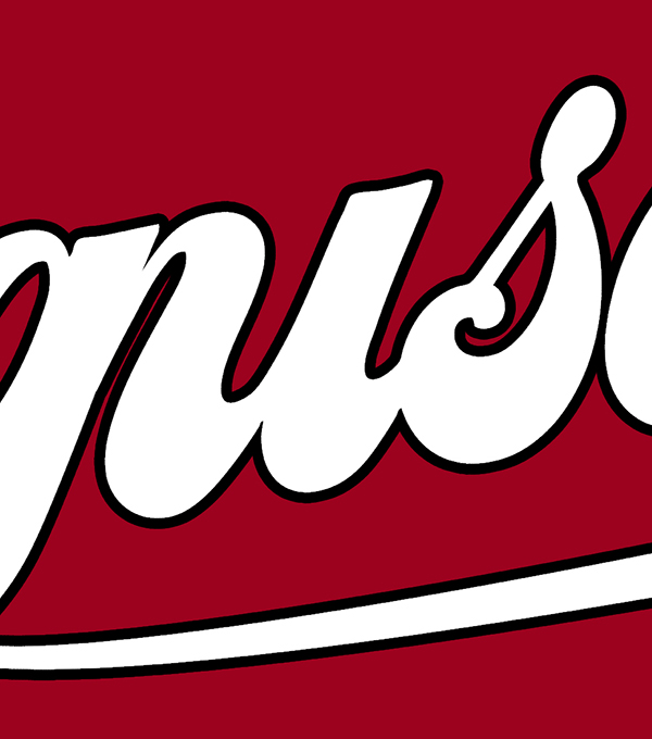

It has been recommended that I use REGULAR cast black for the black parts (which I have already), the black will be an out line on top of red with reverse type to let the white pan face show through. Any issues overlaying the black onto the red translucent vinyl?
