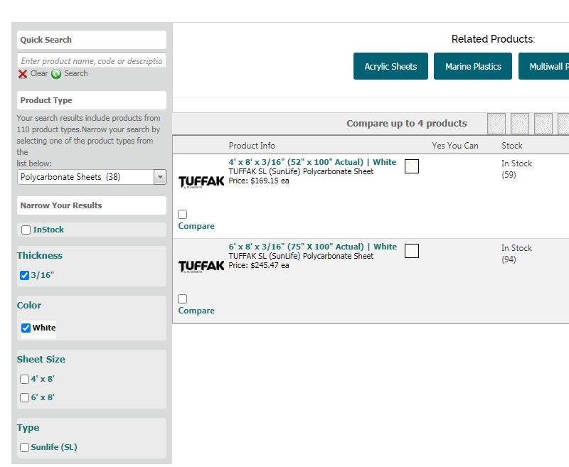

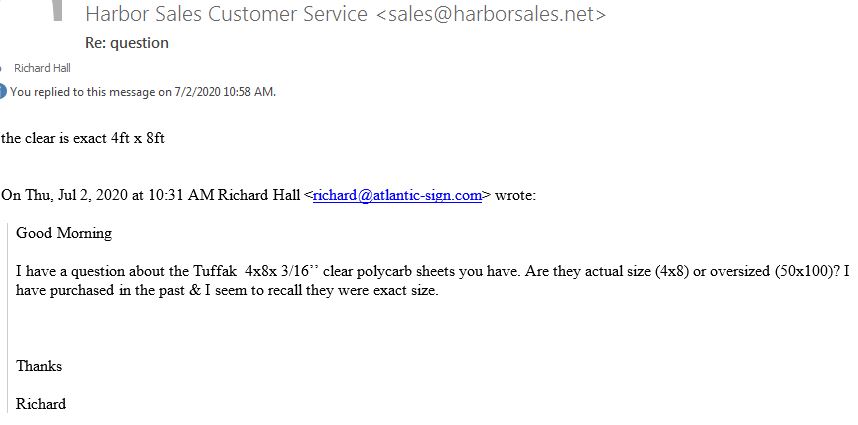

Harbor DOES offer true size 4x8 clear as I stated before. I have included snips of the page as well as the email reply I got back this morning. If it is not actual size, they reference the actual sizes to the right.
Whatever Richard.................. I've been talking white, not clear and so is everyone else.​
However, I asked the exact same question to the girl I talked to and she said yes, it's a true 4' x 8'. I said, so when I get it, it's 48" x 96", and she said no, it's 52" x 100". You'll have to cut it to your exact specs. We just call that our 4 x 8 sheet. I never inquired about clear, as it's not even available at the moment in that thickness.

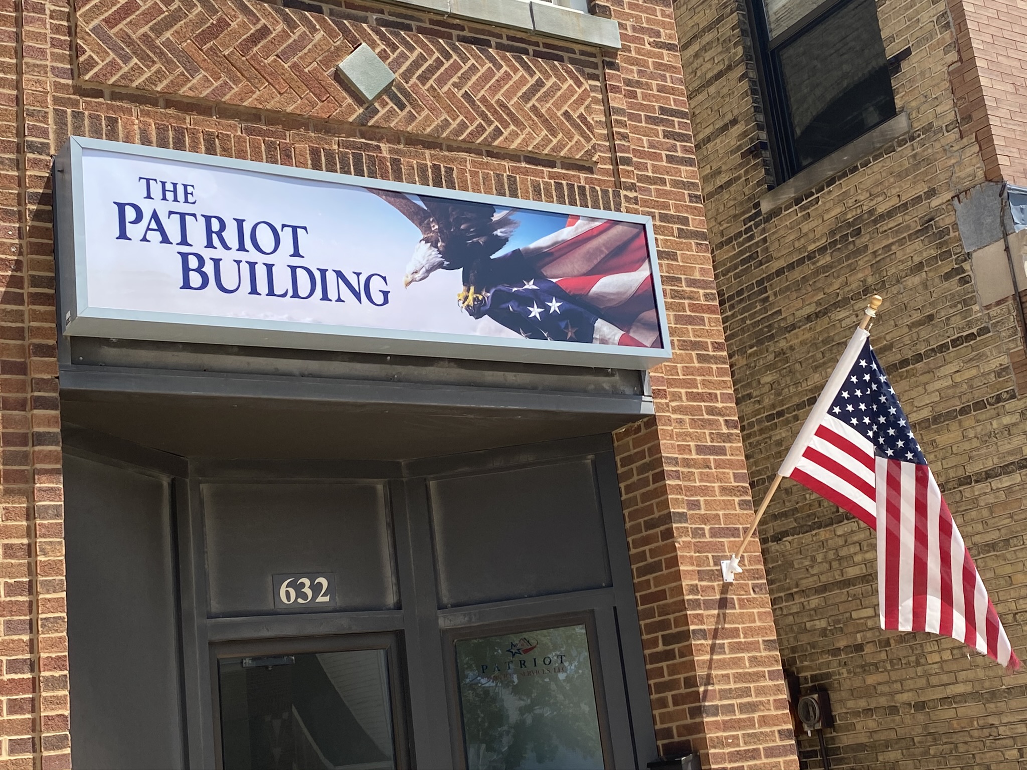

All finished up. I was very nervous that it was not cut perfectly, I guess I'm not sure if it was, but he installed it with no issues LOL Thanks for all the help, the customer sent me a text at 10 pm stating that he loved it!

instead of doing a double pass, I like to do a single pass on clear, then do another single pass, but mirrored second surface. This way the colors are right during the day and don't get blown out when backlit.

Looks fine and also good to see someone follow up!
