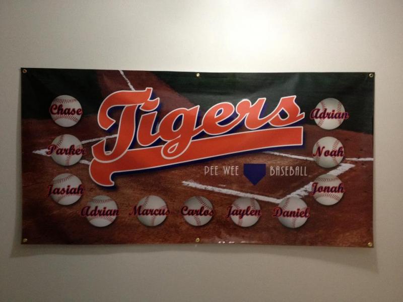

This is the first one we have done for a little league team. the client was a friend of a friend, last minute deal...
They asked for all players names, the team name. We asked them the colors and then we went at it.
We wanted to create a clean, classy image and make our work stand out over any other banners on the field. Hopefully it will lead to more referrals. I was reading a post by SignManiac (I Think?) on here and he was showing how he had redesigned banners for a little league field, I agree with him. Once you have the info and the color scheme, why not take 15 minutes to come up with something "outside the box" for the clients and keep it affordable
obviously all the baseball images are the same image, but you can tell I got a little OCD and rotated them differently... To me, thats the type of stuff that noone may ever notice, but it satisfies my inner artist. the folks who do notice it will definately appreciate.

I think you missed his point.
The players’ names are barely 3" tall. Probably no one without binoculars will be able to read them. Then the name itself against the background is about 4 to a 7 on a scale of 0 to10. Again, it will be hard to read that if this sign goes in dead center field.
What looks good on the screen isn’t necessarily gonna be legible from 300’. Anyone doing Lil’League, pretty much knows copy has to be at least 6” or 7” tall and not script to have a chance of being noticed, let alone read or it’s useless garbage.
Just look at your thumbnail…. you’ll get the idea. We do quite a bit a Minor League and those homerun walls are 450’ and the backboards are almost 500’, so our sizes are bigger yet. Of course, the smallest sign is 8’ x 16’, but size, contrast and layout are very critical and you can’t just go artsy-fartsy or you won’t be doing them for anyone else.

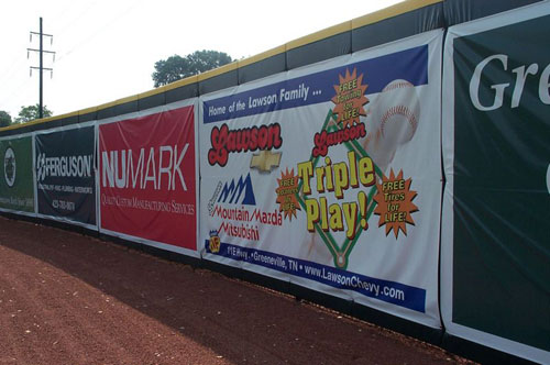

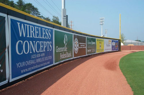

Gino is correct. Here is a photo of the banners we have done at local minor league stadium. They are all 8'x16'.

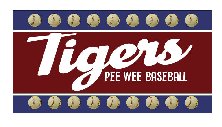

Here's a simple way to display the team name and yet appease the coaches requests to incorporate the kids names. I can tell you that nobody would be able to read the kids names at that distance, but at least they would be able to make out the name of the team on an outfield fence.
It's a compromise to keep everyone happy.

While I admire your effort, most of the message is completely lost due to lack of contrast.
I would have done the player names in a sans serif font too, not a script, and made them fit onto the baseballs (or softballs)
When legibility is a concern, always opt for clean and simple.

I don't think this is meant to be seen from 300' away. Around here teams attach banners like that to the back of the dugouts, parents are more like 30' away. Still could have used more contrast but legibility is fine.
I doubt the banner is to be viewed from 300' away. My guess is this banner is put on the dugout or on another fence for up-close viewing. Having said that, the kids' names do need more contrast.
agree about the contrast. I do love that you put in so much effort to give them a nice banner. it is pee-wee baseball so I think it will be OK if no one but the players can actually see this as it will most likely be the first time these little guys see their names in print which is what this is all about. I am willing to bet this will be a much loved banner amoung the Tigers. next time, just watch the contrasts.

I think it looks good, but agree with the others about the contrast on the names. Too dark to be read. But its a nice layout and no doubt they will like it.
WCSign
sorry for the confusion.. this will not be 300 feet away.. first it will be used in team pics, then close quarters, ie. dugout like someone mentioned. my reference to the signmaniac banners was about "business" banners that are out on the fence
as far as contrast, I would agree, BUT I could defer to the darkness of the pic, I could say it was a 15 minute design that they ultimately approved on the first round and loved it in person etc.. the main reason I didnt brighten the names was to insure that the focal point was the team name - and as I mentioned, its going to mostly be seen at under 30 feet away

I strive to do the nicest, cleanest, effective work possible while "knowing my client" This client would have been happy with a white banner with a plotted out logo and baseballs one color with arial lettering for the names
mentioning the font for the names.. I thought about changing, but in the end, I knew my client wouldnt notice.. of course all of us would LOL
thanks for the compliments - if contrast and name font choice is my only flaws, then gracias as well, because that speaks volumes, I dont know you guys background or skill set, but I assume most of you are awesome designers
