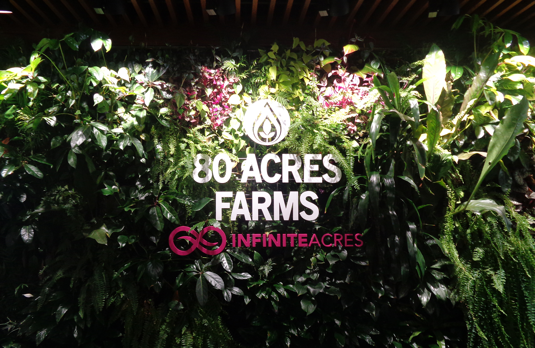

This will be a first for me so I'm coming to all of you to hopefully answer an issue before it ever arises. We are doing studded dimensional letters protruding about 6" off of a living wall. This will be in an (interior) office space, but my concern is about humidity/moss/mold potential issues.
They'd like their logo/lettering cut out of a white material, so if there is a potential for it to start to turn green in the future I'd like to avoid that.
Are there any thoughts on any materials that might be better to use for this project? What ones to avoid?
I'm going there tomorrow to do a site survey to determine the best mounting procedure. Should be a fun project! Photo of the actual wall attached.

WOW! That looks like a place in Fort Worth area I was at a number of years ago....
Unless they don't have A/C or some sort of air movement equipment, cant see a problem myself. Aluminum doesn't rust, and anything with paint will attract mildew, unless the air is kept moving.
Are the plants watered mechanically? Will water be able to sit on top the letters or inside the cutouts?
There is some maintenance to this type of thing, and I can't imagine that place not having a cleaning crew.
Would seem to me, as long as the parts are rust proof, stainless or aluminum, Seems like a cool project.
I hope you post some pics when it's done.
MikePro
treat it like an exterior sign, and you should be fine. mold/corrosion is a living thing too, but highly unlikely that will even be a factor unless you're making it out of paper-mache

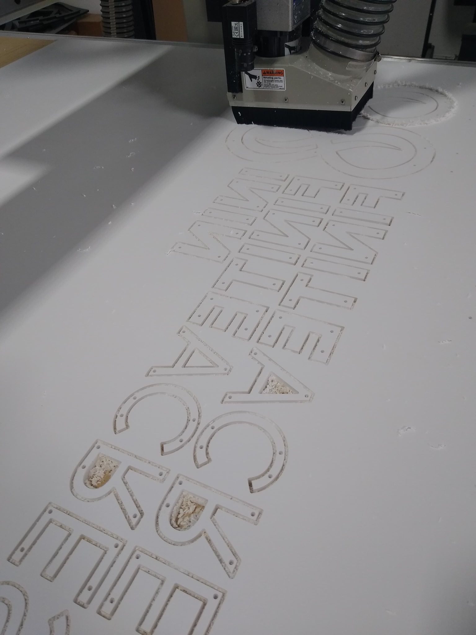

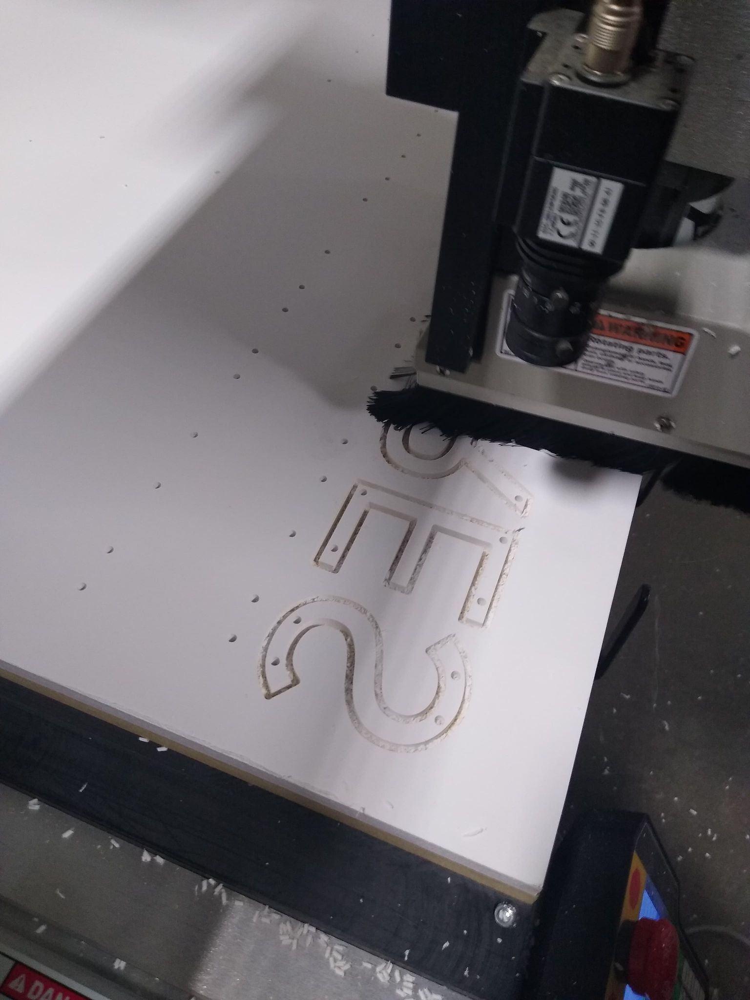

We have done something like this before. We have a 150w laser in house so we reverse cut 1/2” white acrylic and mark the locations for pins.
Recently did a wall wrap there and they still look brand new. As mentioned they will require some cleaning here and there from water spots but the cast acrylic is rock solid.

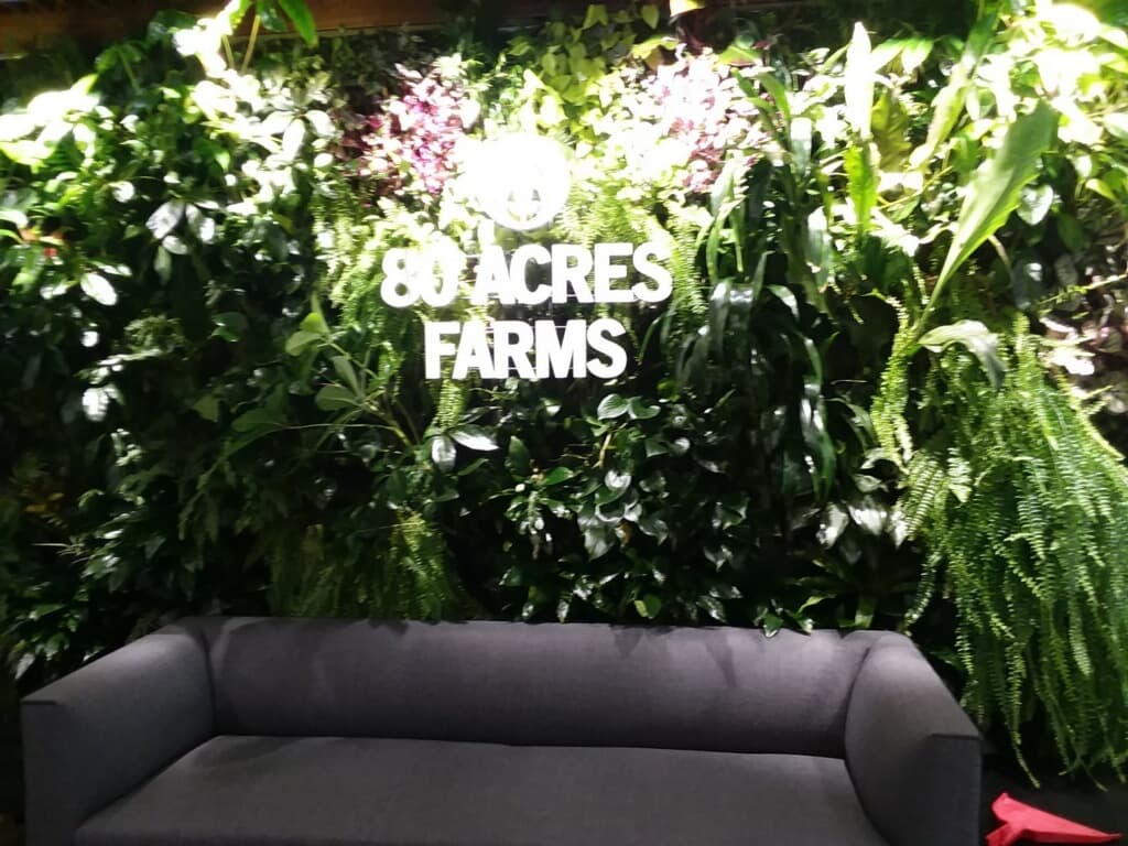

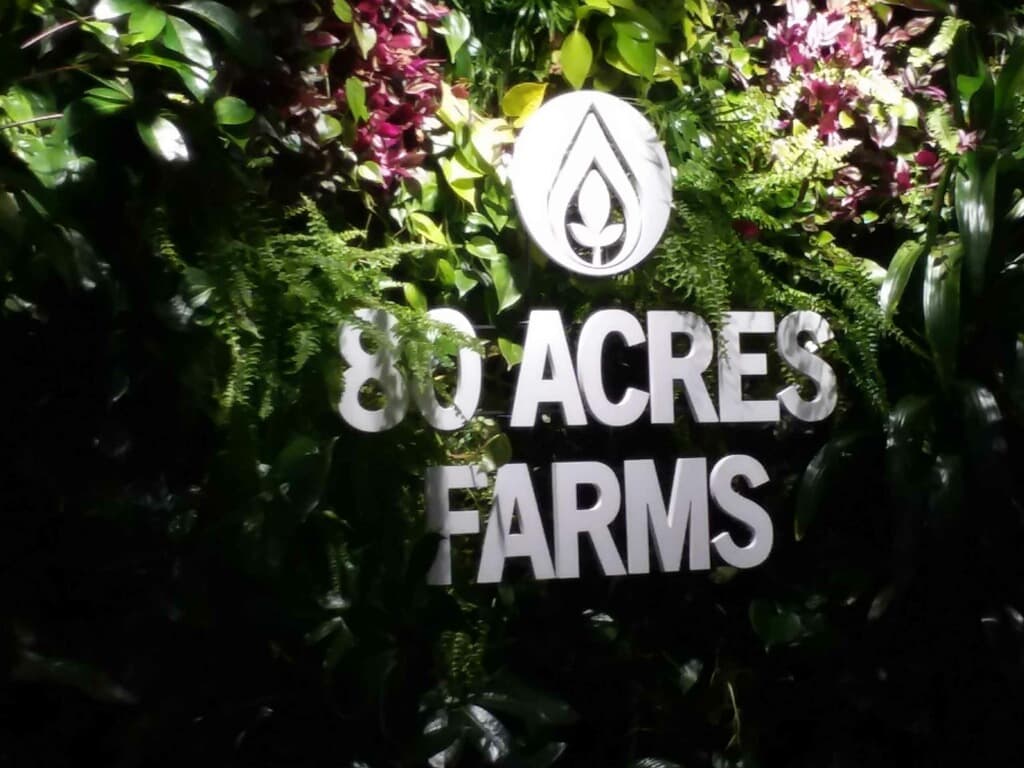

Not the best photos, but everything turned out awesome. We pin mounted the letters and welded the pins to rails (painted black). Hung the whole thing (around 2 pounds) by thin black wire off of 2 hooks at the top. We added adjustable legs to the back so that we could get it to sit flat with the uneven wall surface.

I love it the concept of this, the sign looks great, good job!!!! Thank you for posting a finished pic!

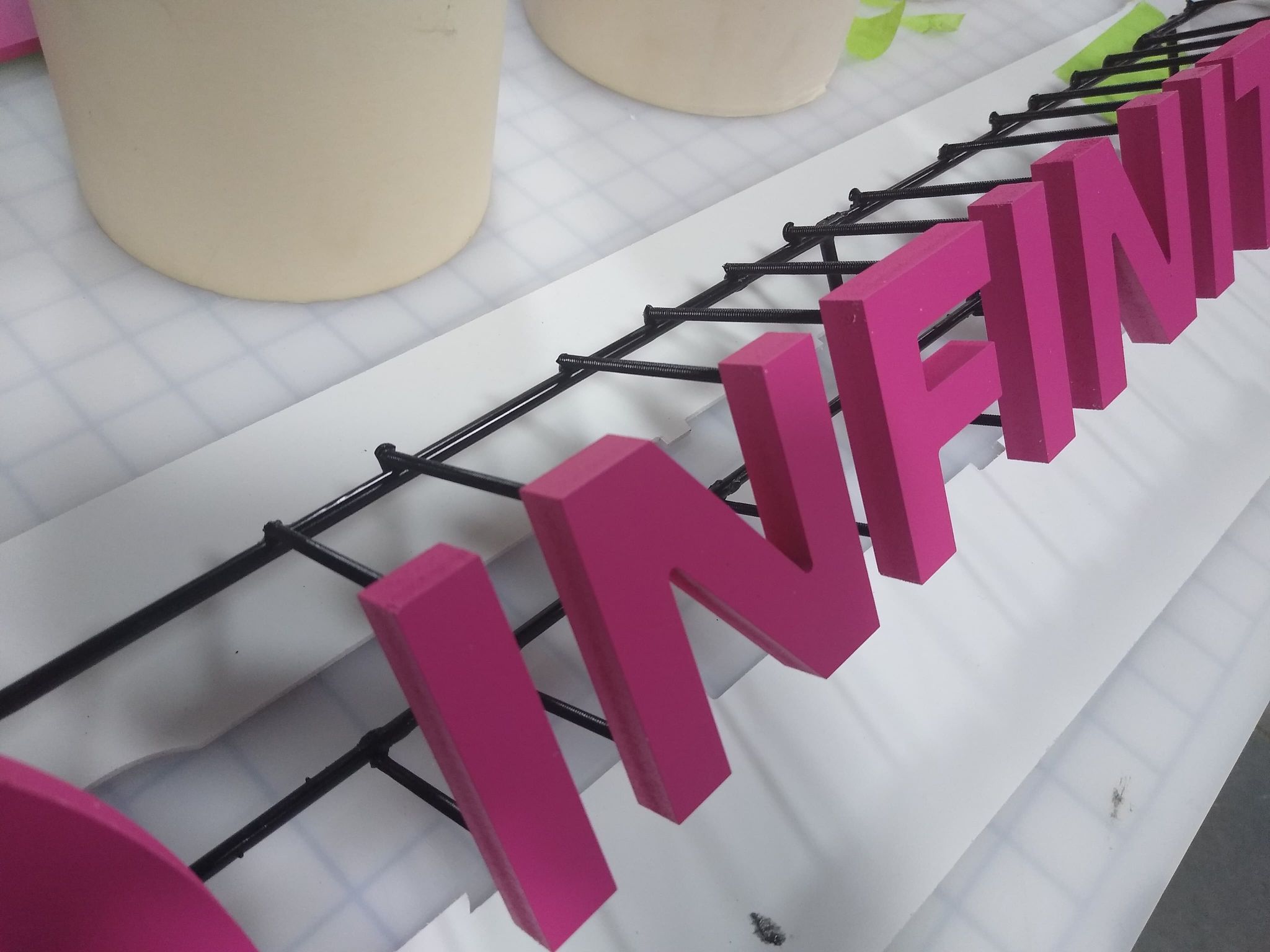

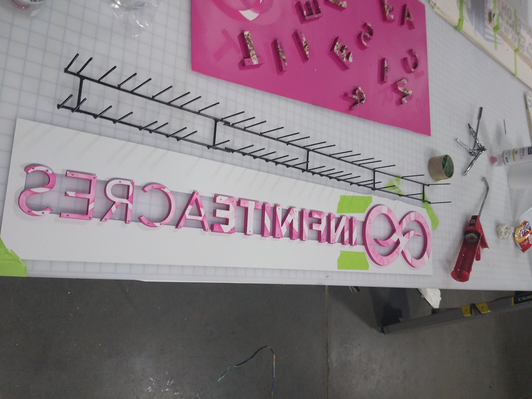

We're already on to our 2nd living wall sign.

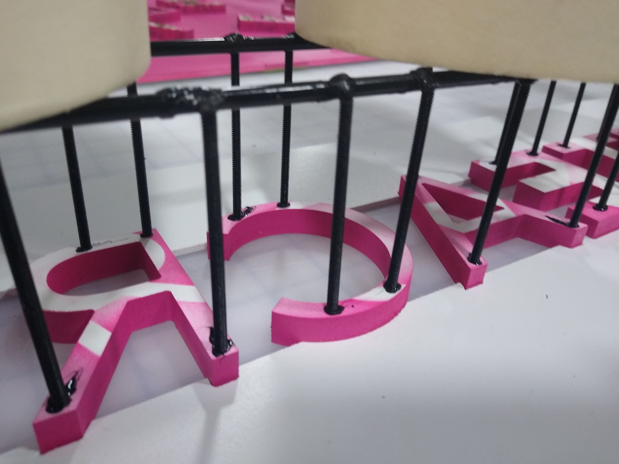

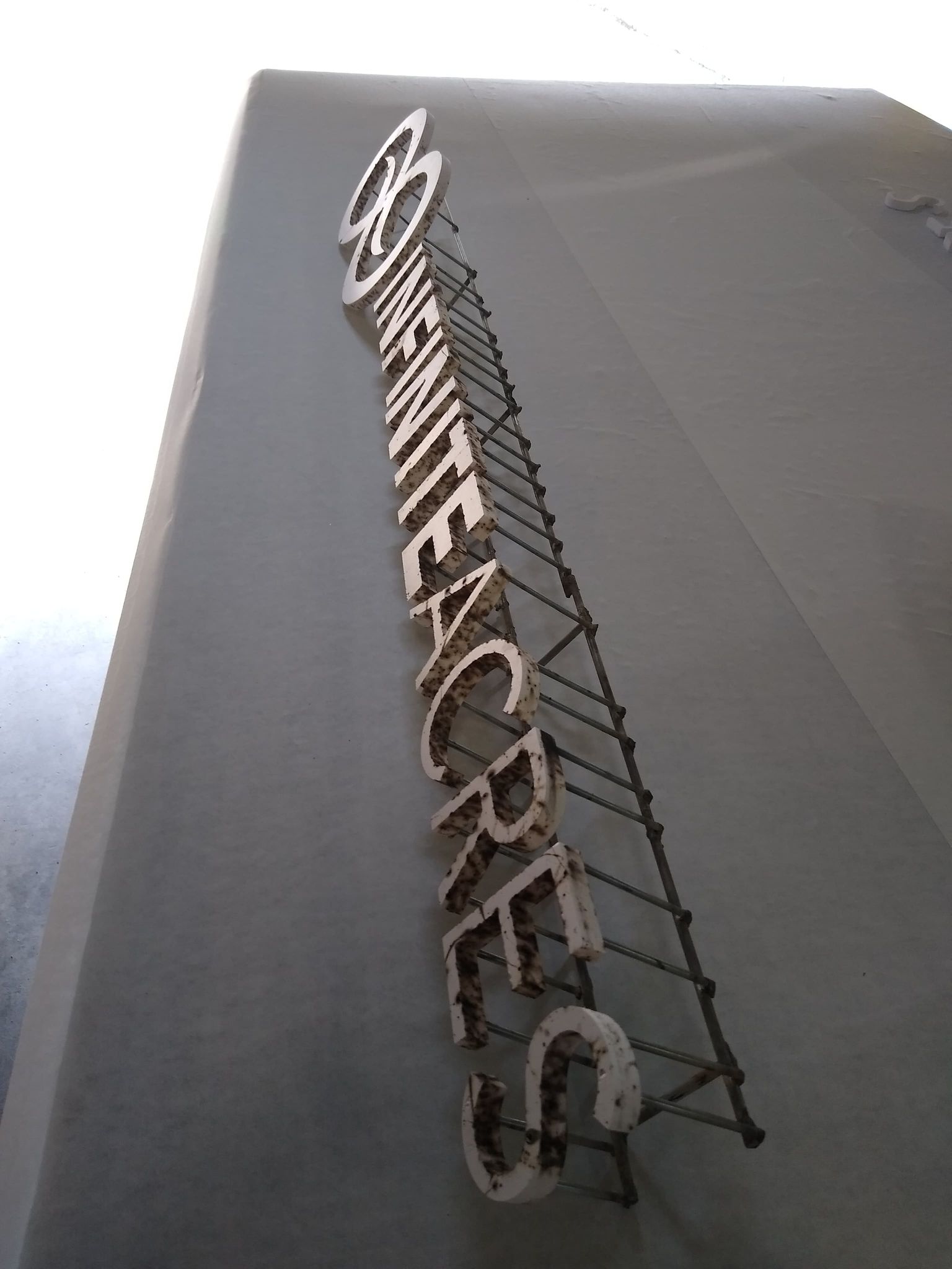

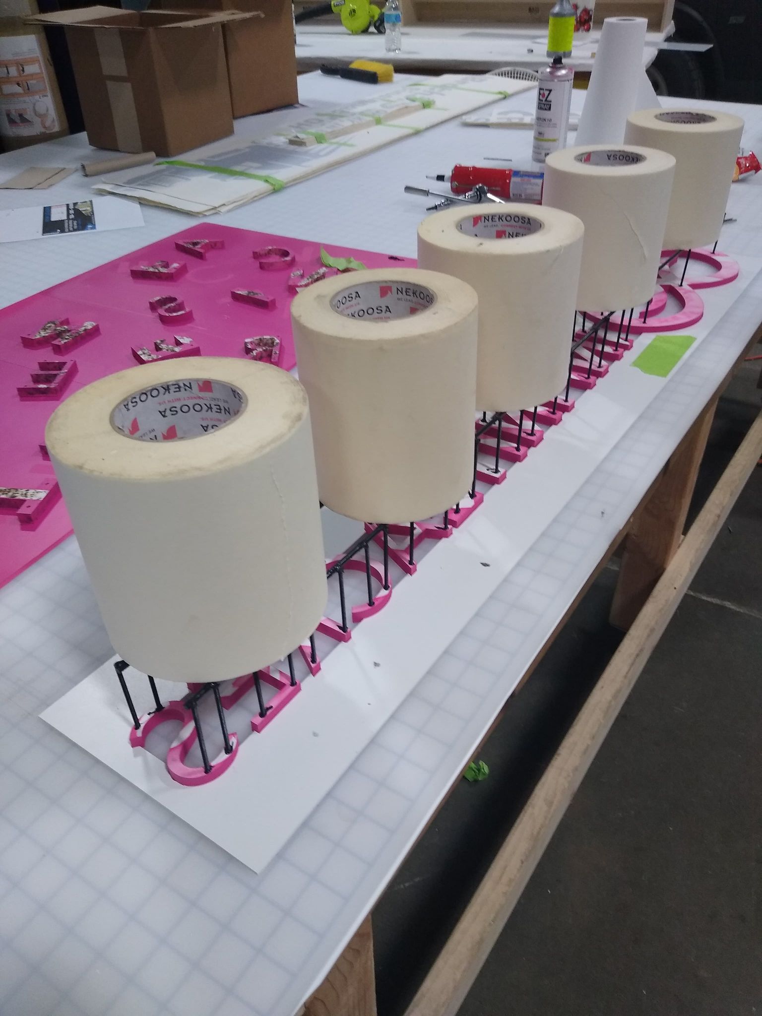

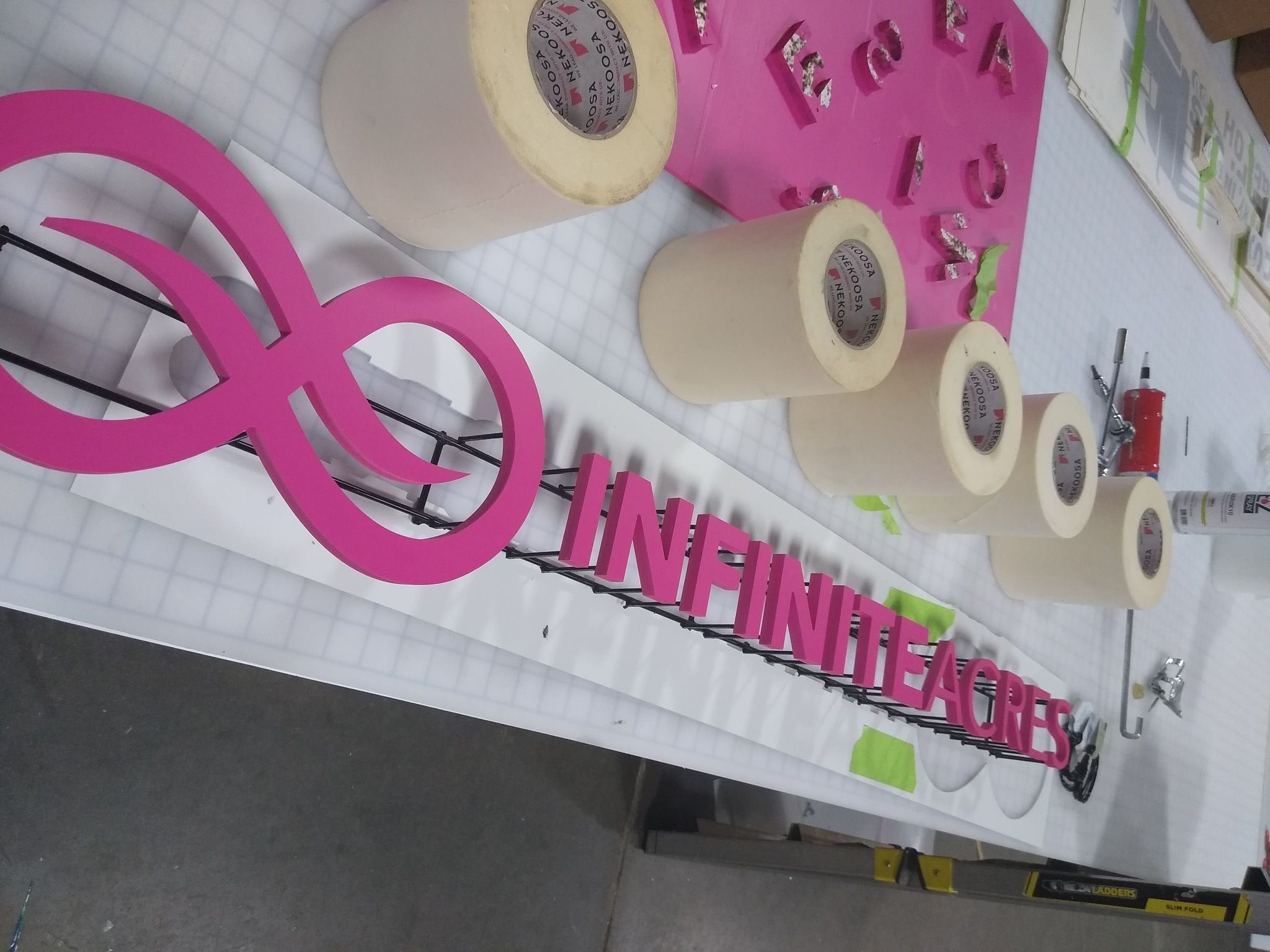

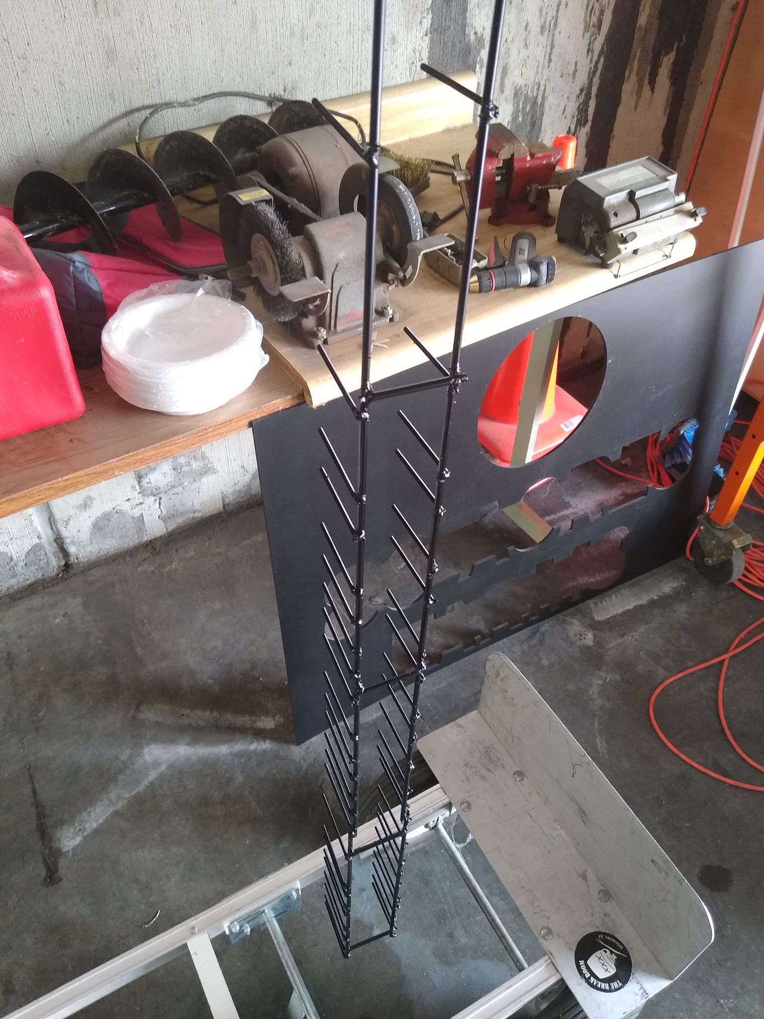

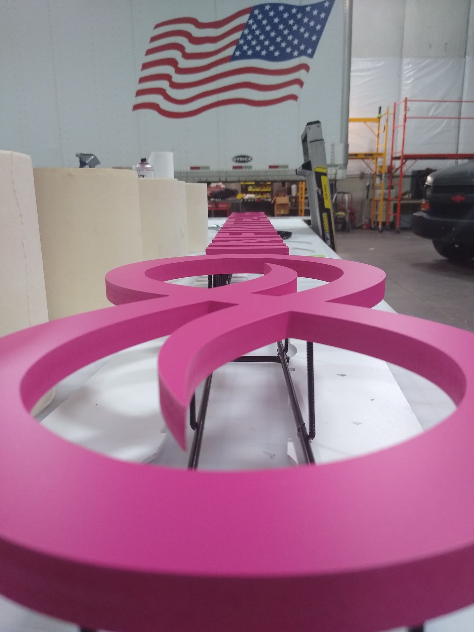

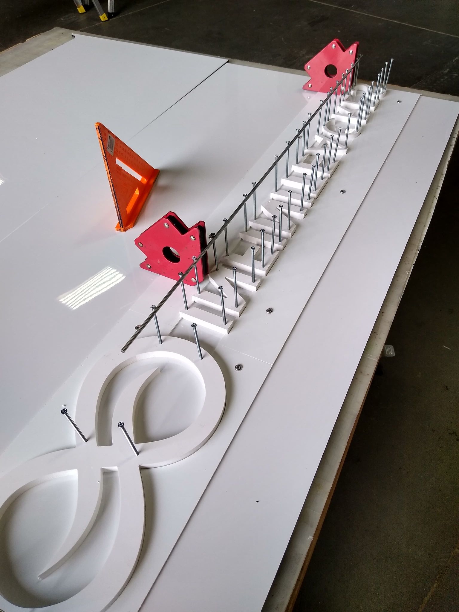

Did a few things differently this time.
Pics below should explain a lot of the process for the curious. ;)

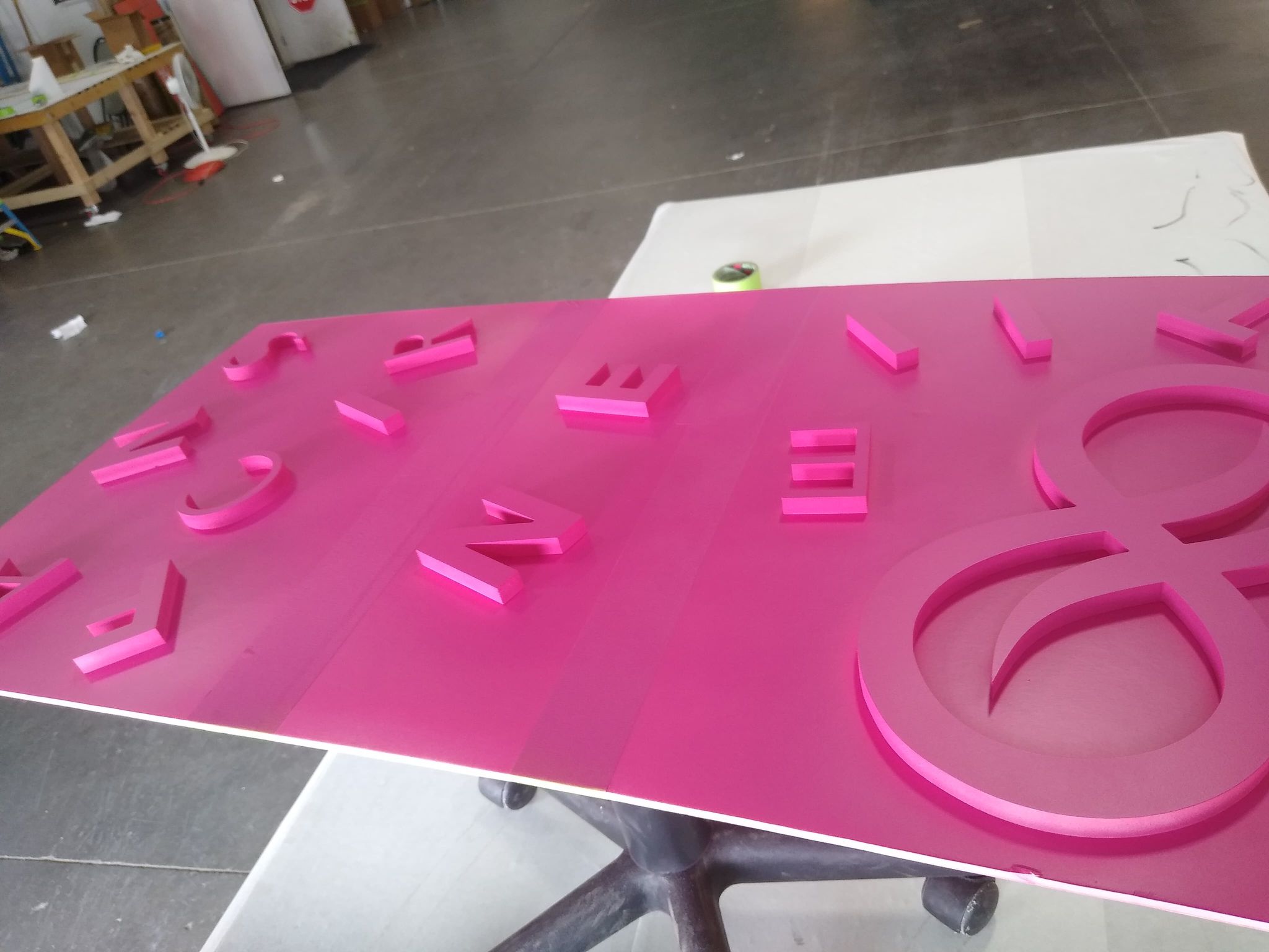

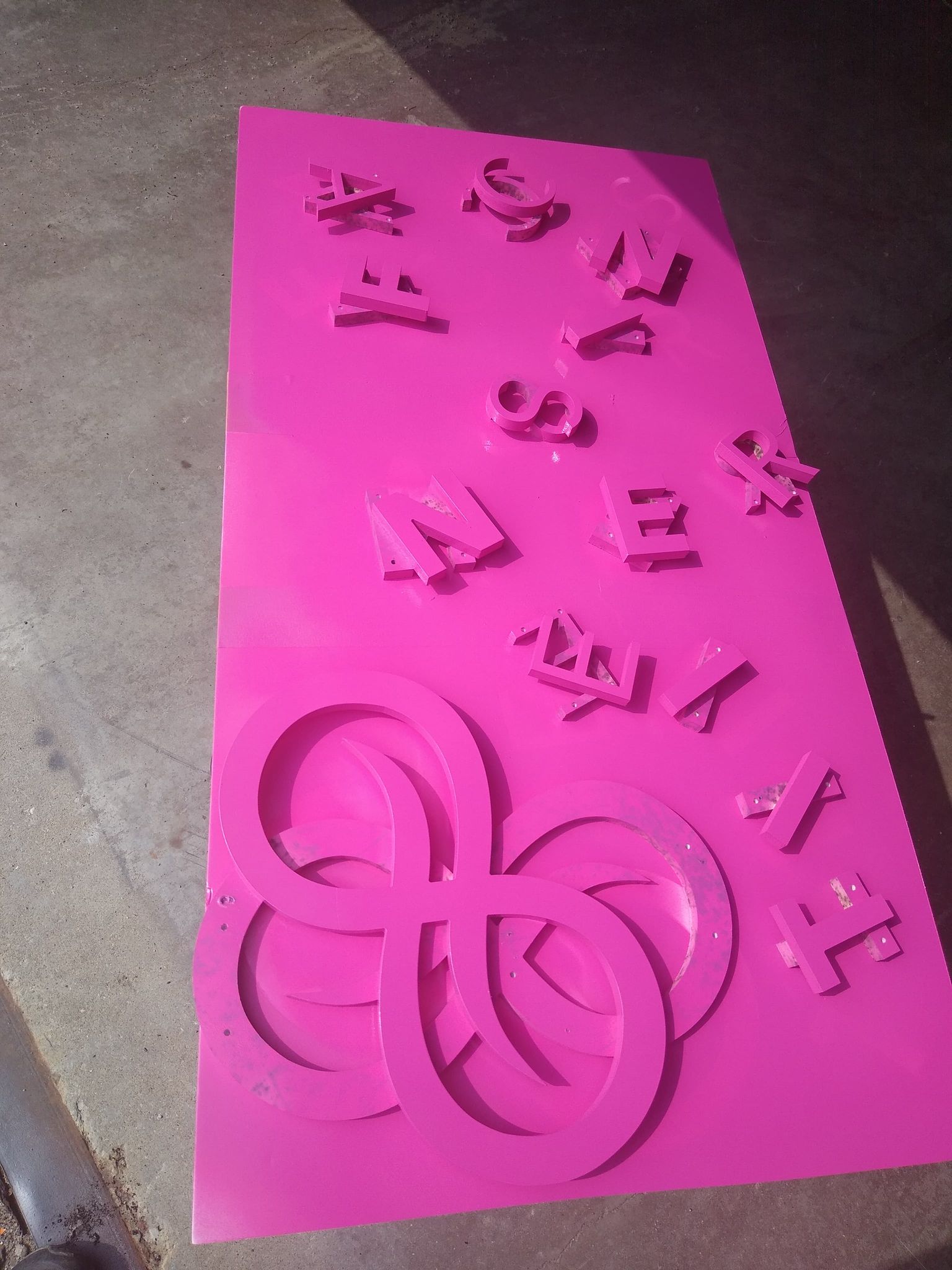

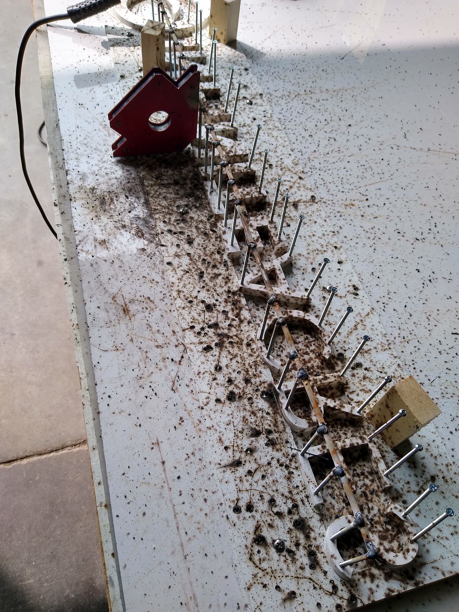

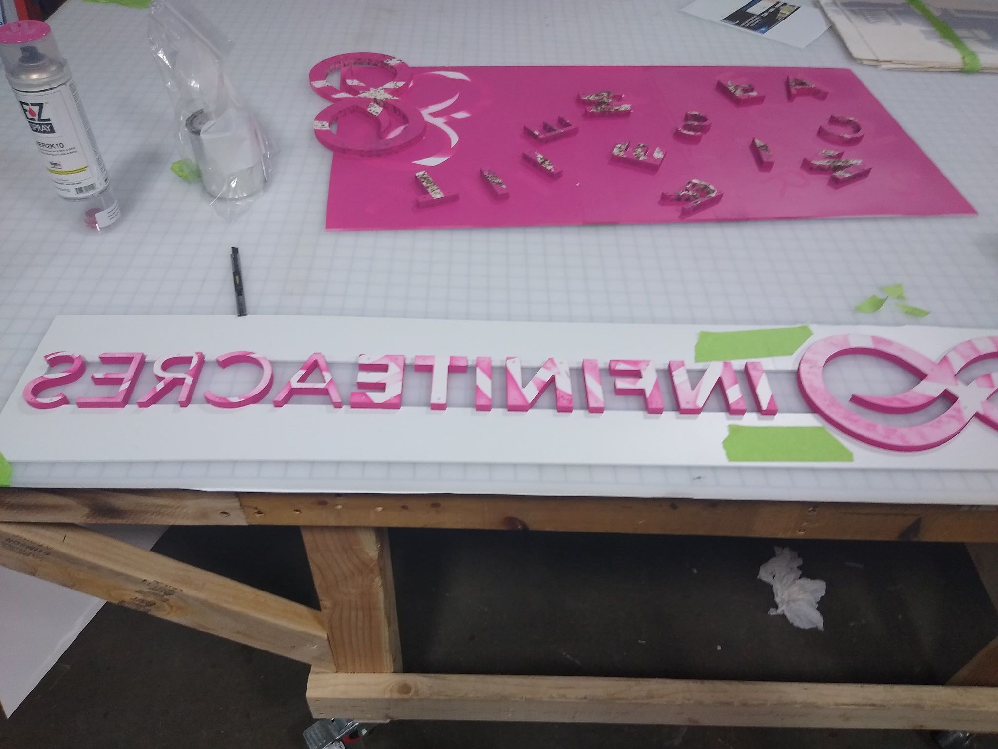

Look at the 2nd image. This is a sacrificial set of letters.
The "real" letters were being painted while the others were attached to the framework getting welded together.
It seems no matter how well you think you cover it up weld spatter finds its way to the letters and discolors or damages them.
Since they're the exact same pattern we just popped the junk ones off and pitched them and painted the frame without worry of over-spray from either color.
After the last coat of paint we will glue them back together for install later this week.

Greg Kelm
www.cheetaprint.com
I see it now. Was thinking that there has to be a better way to avoid all that, but your method make sense now.
