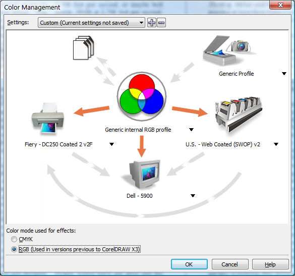

It is most definitely user error. Corel has a very nice Color Management Tool where you can adjust your color profiles and optimize your setting for print output or web and etc.
The problem is some people don't take the time to set this up properly.
I think the only thing Corel could do better in this case is set the default to a different more widely used setting.

Been there... done that... got the profiles to prove it...but all my customers don't. So that does me no good when I get a "print ready" eps from my wholesale customers... Dump and run is supposed to be the way that works... and it does from Illy.
But here's the thing Joe... I trust my Versaworks profiles completely... and hate Corel overriding them and adding to my work.

Well I don't know what process you are taking but we have absolutely no problems with colors using both Corel and Versaworks. Here again the answers lie in the Color Management tools.
