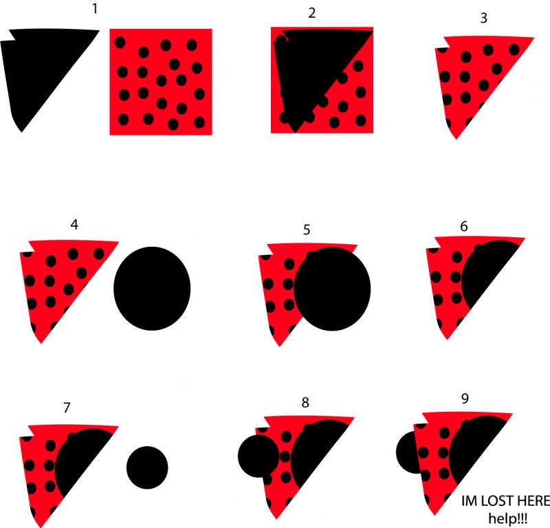

vectorterrorist
heres a pic- when I get to this step I get lost and when I try to do clipping mask again the black circle dissapears and makes the triangle white/transparent- I want to learn how to keep doing clipping mask on top of clipping mask if that makes sense

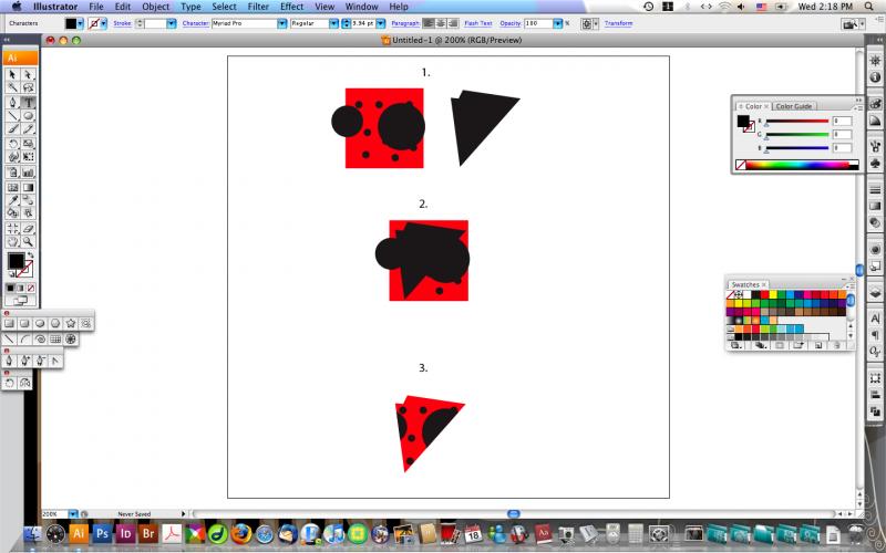

m.hafenbrack
I see what you're doing. I don't quite understand why you're making multiple clipping masks over each other. Just put the square and circles all down, then the clipping mask (triangle) over them, select all and make a clipping mask.

1. Release the clipping mask on your last circle and delete the mask vector as it is not needed.
2. Select and Cut the circle.
3. Double click the red object. This will take you into ''Isolation Mode''. If the red background is grouped with the other dots, the entire group will be selected. Double click the red background again and this will select the background layer. From your description, I believe you will only need to double click once to select only the red background graphic
4. Leaving the red graphic selected in Isolation mode, go to edit and ''Paste In Front'' (or use appropriate keyboard shortcut).
5. Double click an open area on the canvas. This will take Illustrator out of Isolation mode and your circle is now included in the original clipping mask.
6. The same procedure can be done with the smaller circles as well. Just as posted above, you really only need one clipping mask. :thumb:
synergy_jim
when we do mx graphics, we use the divide command in pathfinder a ton.
that way we can overlap multiple paths and use the edges of the paths as a trimming point for other paths without the need more masks.
