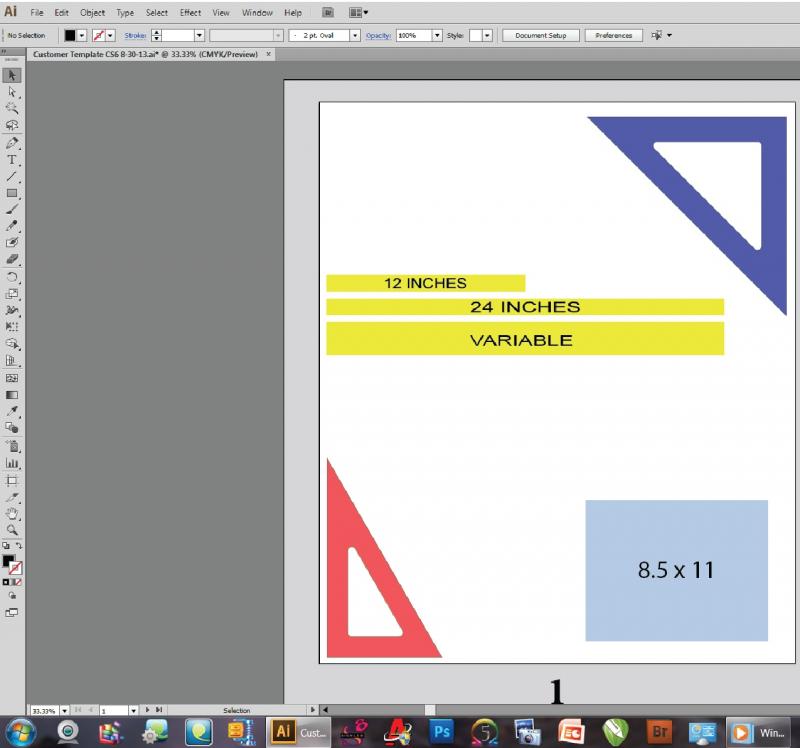

I use Illustrator, and I have a template art board that has several rectangles of the most common sizes we use. It also contains some vector images of old school drafting "tools" such as a 30-60-90 and a 45-90 triangle.
All I do is import the photo into the template file and do a scale reduction (or enlargement) of just 1%. I then use the CTRL + D keys (transform again) and CTRL Z (undo) to quickly scale the image smaller or lager. I can usually accurately scale a photo in less than a minute with no calculations....just match the photo to the correctly sized rectangle.
