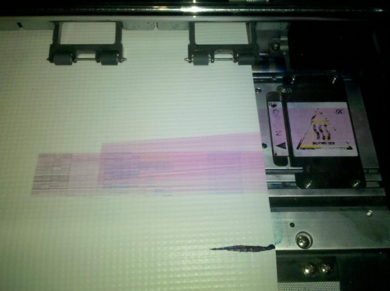

Trying to get a Mimaki jv3 160sp running. I have attached a image of the test print. Print head #3 seems to always be firing.
Does anyone out there know what this might be or have had a similar problem.

that is a bad sign. you are having data issues. either from a loose data cable. but more possibly a blown head. i'd give you some pointers about a data swap that would diagnose if it is your slider board or head. but, i don't think i want blood on my hands if you do the swap wrong and fry your printer.
at least recheck your cables and make sure all the ends are clean with no fraying or bent ends, and that they are plugged in firmly. turn off your machine on front, switch off on back, unplug, and press the front power button four times before doing any poking around in the head carriage. and try to keep one hand on the platen if possible.

That is a loose head data cable most likely.
Turn off your printer.
unplug your printer
Cycle the power switch to insure there's no power left in the system.
remove the damper to the affected head ( make sure you pull straight up and don't break the nipples on the manifold to the head)
Gently remove the plastic cover over the magenta head ( the dampers for the heads to the side will be partially over the top of that plastic cover wiggle it free)
Gently push down on the ribbon cables on the head, making sure they are seated fully
replace all the parts in the opposite order
power up and see what you get.

check the flat data cable on the printheads..especially the magenta printhead...it could be just a flat cable...

After replacing a head, I am greeting basically the same thing as the original post here. Except I am having the problem with what I believe to be light cyan. Do I need to replace the cables?

first just inspect the cables and or swap the cyan with one that is working to see if the issue stays at the head or follows the cable. if it stays at the head, it can be a bad slider board port or ink inside the head's ribbon cable input.

Now I woke up this morning to a head error 07 message that appears to be referring to the head that I just replaced. I switched the cables and restarted the machine and came back with the same error.
superdj23
okay. I might have jumped the gun a little. When I switched the cables, it looks like the error is coming from the head that I switched the cable to. Hopefully I just need a new cable and this was the problem for the original large streak of cyan.

then mark that cable and keep moving it. if the issue keeps following that cable then it's the cable.

Turns out it was the cables that needed to be replaced...I have gotten a good test draw with all six colors finally showing up. I haven't done a head alignment yet, but how much much of a difference does this make?
artbot
if you haven't changed your heads than no difference. you machine is most likely already lined up. even taking out a head and putting it back into that exact spot for me has retained the same alignment. glad to hear that your printer is fine.
