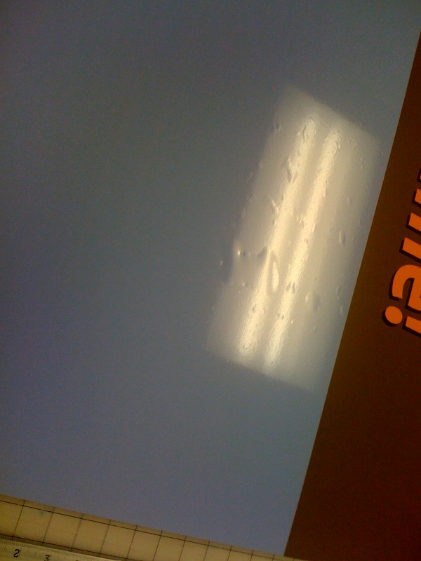

So, here's the problem. I laid down two 4'x8' prints on Friday. There were a couple of small bubbles at the start of the print, and another decent few at the end. Got those squeegeed out and everything looked great.
Put the signs off the table and went home for the weekend. Came back in this morning and there were MASSIVE bubbles, EVERYWHERE on both signs.
Any idea what the deal is there?
Gary
Circleville Signs
Here's a pic. This is just a small section (14"x14" or so). These types of bubbles are all over the signs.
These are Briteline intermediate with gray adhesive and Oracal 210 Lam.
Prints sat for 12 hours before lamination and another 12-14 before application.
Substrate is 6mil polymetal.
Gary

There are many variables involved with air bubbles. Since it looked good when it was first mounted, the problem is most likely from out gassing or trapped moisture.
More information is needed to help pin point the problem. It is hard to tell from the picture if the bubbles are under the laminate or under the laminated vinyl. The Big Squeegee mounts the graphics dry so out gassing of some sort is most likely the culprit.

If that's outgassing, that's by far the worst outgassing I've ever seen. Anyway, the substrate is polymetal which I believe is a baked-on-enamel finish. If so, then outgassing doesn't even enter the equation.
To me... it looks like the wrong pressure and angle was used when using the tool. I've seen prints in our shop that weren't pressed down hard enough, but still looked alright. We usually look at the print a few minutes later to make sure we had good contact, look for any obvious bubbles and then re-squeegee by hand with a soft squeegee. If this is let go til the next day.... small bubbles and trapped air will gravitate towards the weakest areas and form larger bubbles. After doing this stuff for 25 some plus years with vinyl, you tend to see it all.

It's not outgassing and I had the exact same thing happen to me on Thursday last week when I mounted 3ml 4'x8' to 6mm pvc. It is the pressure on the squeegee that causes it and unlike regular bubbles these are in a mass that shows they never had any pressure on them. If you use a soft squeegee in those areas and go back and forth vigourously you will see most of them will go away and adhere properly. You will of course have to go through it and use the glare of the overhead lights to find the bubbles left over.

Gino is correct and with increasing use you will find these problems go away.

Thanks for the help all! I was pretty sure it was user error, but hey - I figured I'd ask :)
