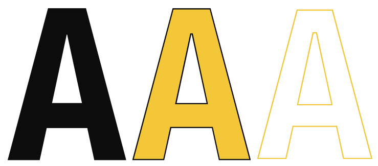

I normally do a thin inline on the letter and then inline the inline. You don't have to worry about removing the vinyl and the vhb still sticks directly to the wall.
