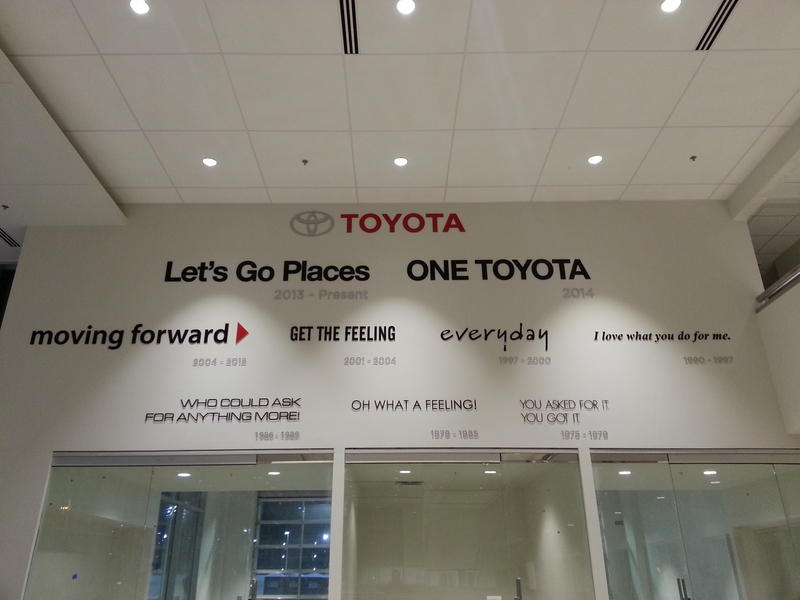

The "YOU ASKED FOR IT, YOU GOT IT" letters were about an 1/8" or 3/16" stroke.
