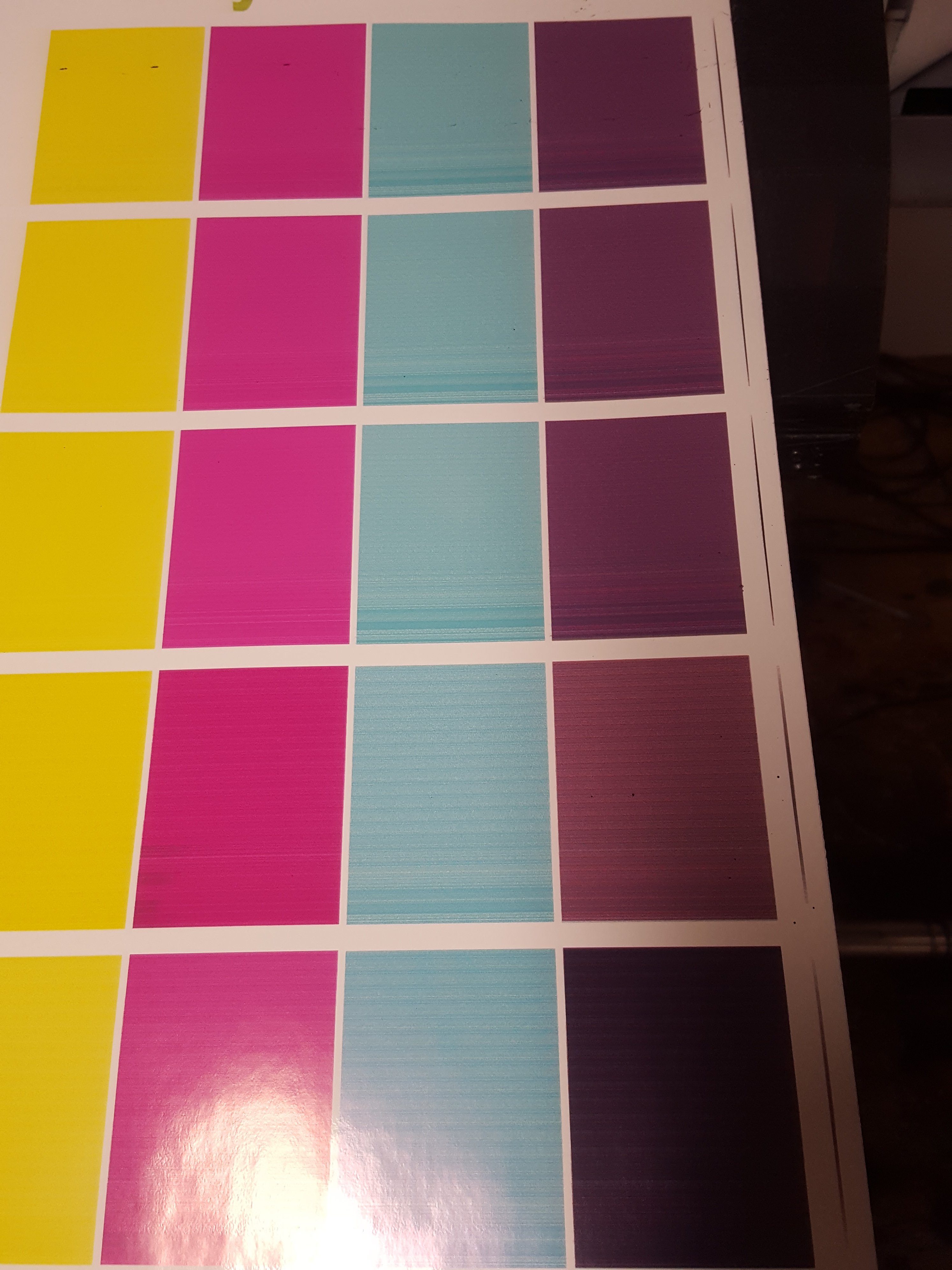

? how do i fix this
RG
What is the distance between white stripes? Looks like you might have a locked print head: one that's made for a desktop printer. Or, your Flexi program could be in demo mode.
