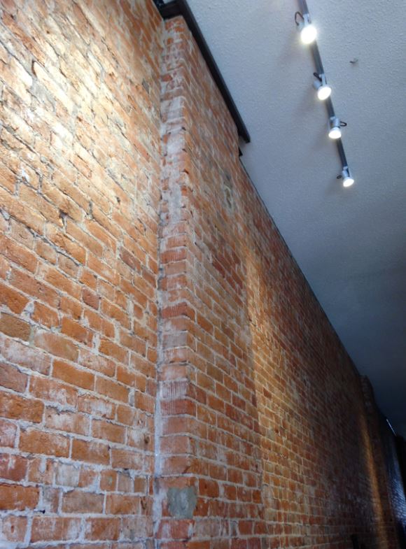

I have a customer that is looking to change the coloring on brick walls where they bump out. They dont want to paint them. The walls are really rough and not level at all. They are thinking of attaching some kind of substrate to them. They said they didnt mind drilling into the brick.
Any ideas?

You could wrap the brick. It will keep all the same texture just a different color. I think the problem with putting a substrate on it will be all the little pieces that stick out further than others. You will have to build a frame of some type that is level and gives you something to attach the substrate to. But in my opinion, I would wrap it.

What material would you best recommend for wrapping. Its extremely rough and not level at all.
There was a member on here a week or so ago who had some really nice approaches to walls and other things of that nature. His deal was etching on plexi or something similar. His thread can't be too far buried at this point. You might consider this technique as it looks like it would work quite well, looking at the other stuff in that area.
Billct2
They could probably be boxed in. Run a 2x up the sides and have it long enough to clear the face then screw the panels over that.It will take some shimming to get the 2x level but that can all be hidden by the panel. You may have to custom cut where the side panels meet the wall depending on how bad the gaps are. Why do they want to do this? Most place s like brick. I think wrapping it would work and keep the texture but it would have to be cleaned pretty well.

1/4 sheetrock and then whatever flips your switch. Can always remove the rock later to show off that very nice brick wall.

If it's mostly a "cosmetic" thing for advertising space it may be possible to just build a U Shaped column that hides it and only has to be attached at top, bottom and a few in between. That way there's little permanent change.

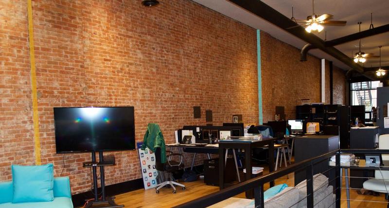

UPDATE
This is what I got from the customer. Budget under $900
Just a recap on the project, we need 5 pieces, each one a different color (probably painted?). They will need to be affixed to brick. The dimensions are:
4 pieces that are 14' tall x 3.5" wide
1 piece that is 14' tall x 6" wide

My basic math came up with about 280 square feet of area to cover to start with. That's $3.00 per square foot just to make up the "panels". That's nearly 9 sheets of some kind of material. Then there's putting the color on them somehow. Even with just house paint, you'd probably be a couple gallons into it. Then there is framing the wall out to hold the panels. Then there is the work to actually hang the panels.
I'd say their budget is more than a bit shy unless you are in the charitable giving mood this time of year.
