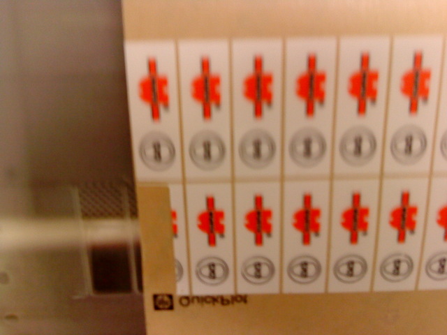

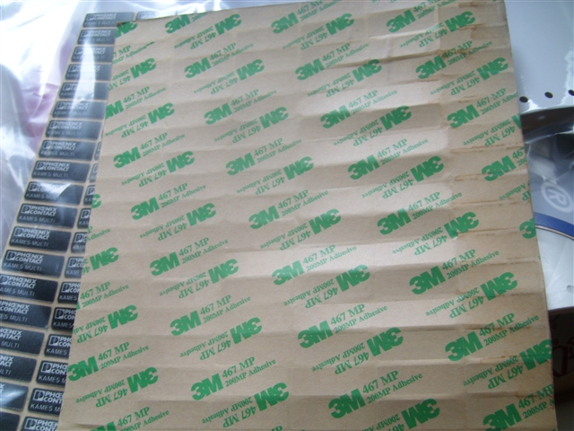

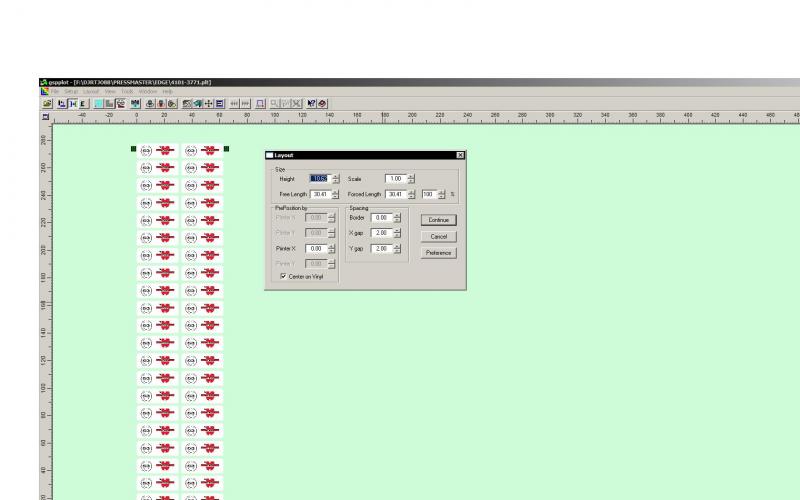

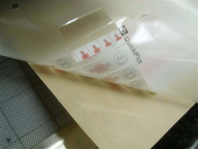

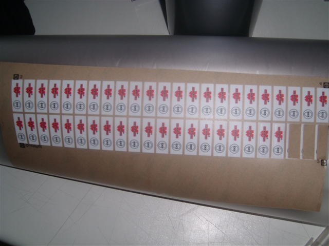

Im about to make Lexan labels. Using a Gerber EDGE2 and Gerber inVision plotter. So far ive figured out that ill need to print the labels mirrord. So i went with the print and putted a backing white foil in in the Omega gspplot software. Applied to "job area". I would want to make the backing white to bleed but couldent really execute that. So first i printed red, then black and then the backing white and all mirrord. Putted on M3 adhessive wich shows in the pictures and wrapped the roll around. Now the problem occured to me. The Target point to aim at for cutting got on the left side instead of the right wich im used to so the cutting process started to the far left.
So how on earth do i get the cutting to go "reverse" instead.
And do you guys got any other tips and trix when making lexan labels?
Sorry for bad picture quality, cellphone camera :/

Damn, tried it now, did exactly like you said and when i multiply them and make like 2 rows with 24 in each the cut target is stuck down in the wrong corner. If i press END for start/end positions, I can't change the positions in any way. start is stuck at bottom left and end at bottom right. Maybe i should get start at the top left instead some way?
Ill make a screenshot!

That is normal behavior for the target.
With regard to repeats, I found many years ago that it is best to setup the vertical repeats in Composer and the horizontal repeats in GSPPlot.
Finally, as to showing your screen shots. signs 101 requires that all images be uploaded to Signs 101 and not linked from somewhere else. This is most easily done by clicking the paper clip icon when posting which takes you into a direct upload mode.

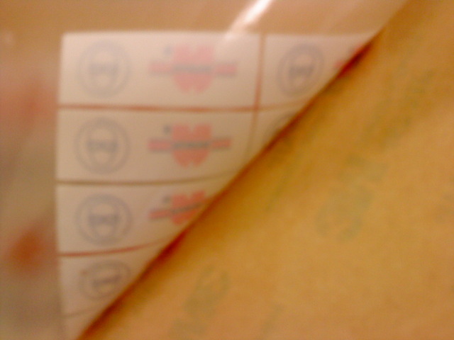

Ah well i get your point. Plotter is a Gerber EnVision. Still the problem is that it should be cutted from the upside, with that i mean with the lexan surface upside. Thats how the guy ho did this before made it. Been trying to ask him but due to issues between him and my boss he don't wanna explain how he has made it in the past. All i got is some labels he done before to watch and understand how he made them and he made it the way im describing it, the only problem i got when doing it the way i did it are that the cut marks are for some reason not correct so the plotter cuts the labels about 2 mm wrong, tryied to do it with 4 marks in each corner and still got the same problem. No Idea how i will fix this, can't "play" aroudn to much with the material either since it's so damn expensive. :/
rudeez

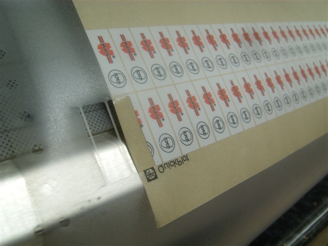

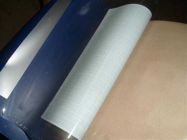

So i took some photos to show you with sharper quiality.

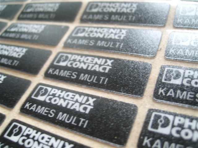

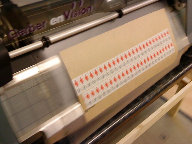

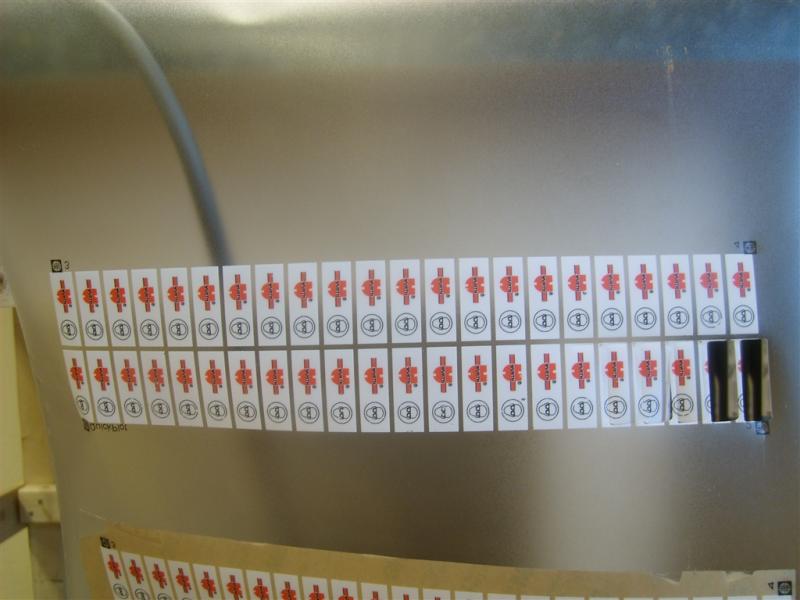

As you can see it's printed mirror flipped and reverse print order. Then i simply flip the work after applying the adhesive. Smooth so far and when ill cut it, it's missing for some stupid reason even tho i used 4 targets. Tried on another piece yesterday aswell and used "center" target and same thing happen, or well. I was even more out of "sync", about 10mm wrong. The Later pics with the phenix labels are labels done by the old guy who made this. Been trying to use it as a reference. He cut it from upside and i know it's possible. And the last pic is some work he diden't finish, seems like he used a separate backing finish in it's own process since it's filling the whole area, wich is better to not get any missed areas when cutting. The pressure is on, got about 10 orders with 200-3000 amounts of labels on each one wich has to be done before 12th of june and until i figure out the problem with the cutting, im stuck...

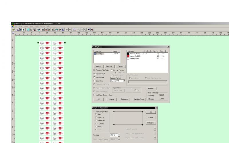

If i use the regular target "lower left" and then flip it when cutting, the target gets on the "lower right" side instead obviosly. Isen't there any simple setting on the Gerber invision 375 that tells it to start cutting from lower right instead of lower left. To me it sounds like the smartest thing but. so it cuts the jobb just like normaly but strats from the lower right.
Any suggestions?

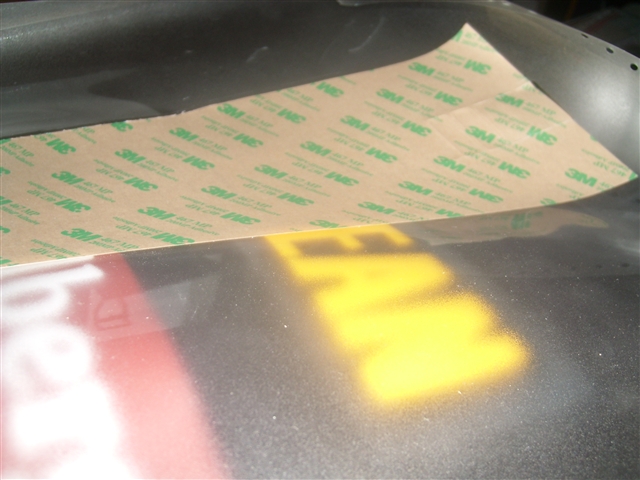

EDIT:
Tried again using the settings on the last two thumbnails, the printscreens. Printed it on the backside of the lexan wich is blank, and flipped it when i plotted. Last 3 pictures are from this test.
Settings and the result are shown on the last 3 pics.
