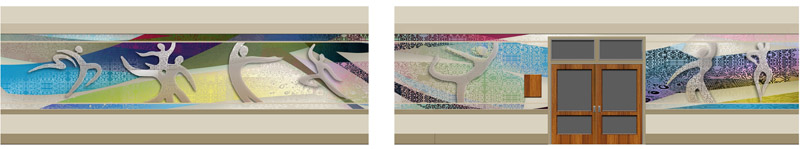

i'm doing a big wall wrap that is choking my computer. ...or else something is just wrong with the computer. i've worked on larger gigabyte files than this but maybe it's just the dimensions that is slowing it down.
short of a weekend upgrade (this is a rush job). i'm thinking of downsampling the file.
current file:
650" x 132" @ 140ppi (91,300 x 18,582 pixels). currently 9gigs and it hardly started should rise to 20 gigs or so with layers. i've gone as high as 14gigs without problems but not at 91,000 pixels.

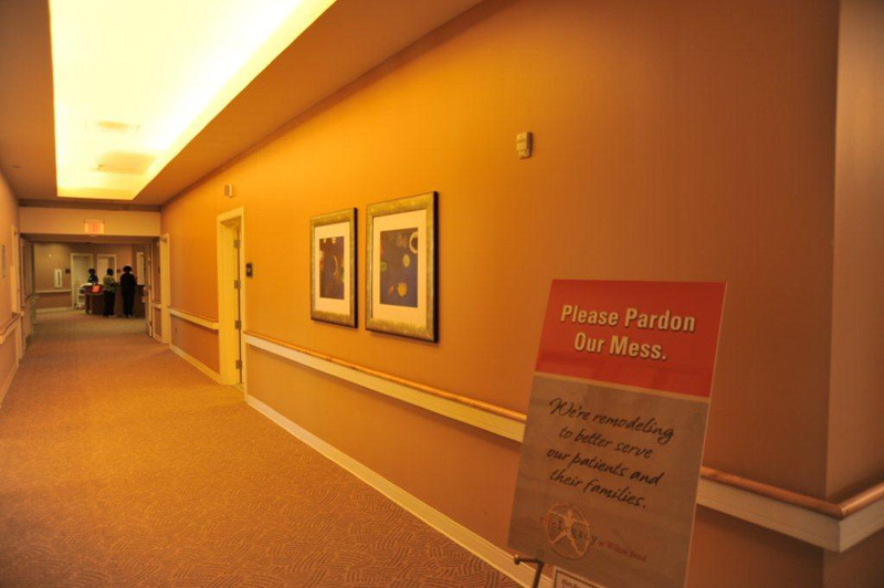

attached is a rendering of the project (wall wrap with 3/8" acrylic floated "dancing people" floated over. except for the current design is supposed to go all the way to the ceiling at 118" high).
also attached is a photo of the space. it's a bit tight. a luxury retirement home. beyond the wall is a work out area.
do you think for this space i can get away with 110ppi or less. the image is supposed to be a bit dreamy so there isn't a lot of sharp detail.
