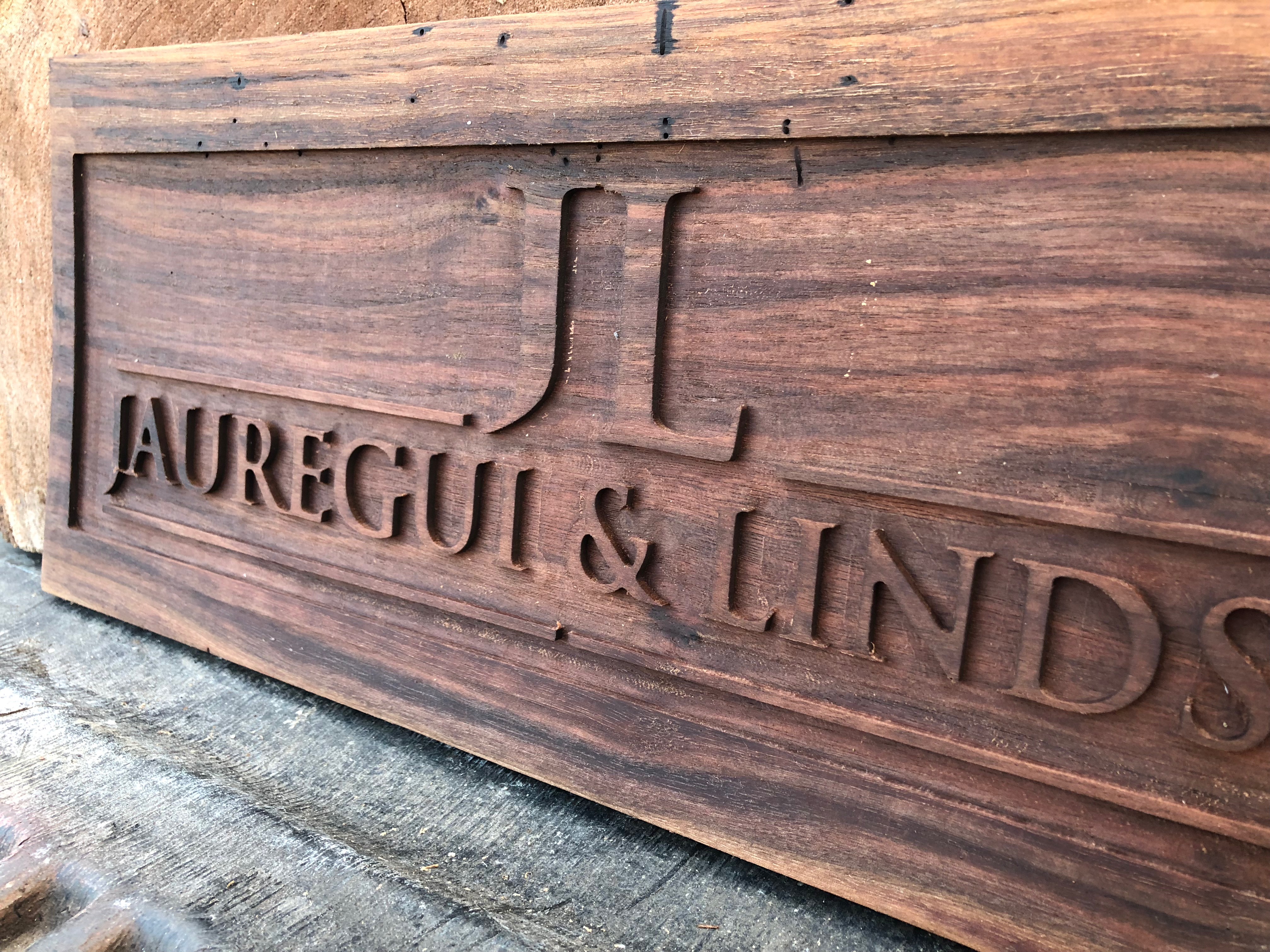

hello all! First post here. I am relatively new at sign making and looking for suggestions and advice on making this sign look good. I have been asked to carve a 20"x50" sign from Solid Walnut. Attached is a small carving I did on the CNC on a scrap piece of walnut to show the customer what the larger sign would look like. see attached image Sample Carving.jpeg
The customer loves the walnut but was curious what my plan is to make the letters pop so they can been seen. Can some of you professionals suggest some ideas on how to finish this sign please. Any and all suggestions are appreciated
It's called paint. Prior planning will determine what gets what color. Ask you customer, if they have any preferances. Then, figure out the balance from there and offer suggestions.
visual800
I would paint the faces of the lettering a light beige, it would stand out without being intrusive
fixtureman
I think I would do inset the letters about 1/16 to register insert letters out of a light color wood like maple. That would keep it all wood and really stand out. If you intend to paint I would paint the piece first and then route it.
Johnny Best
This must be going into an office environment. I would use a darker stain on the copy and leave the background as is and use good varnish, or two part clear over the entire thing. I prefer Tung oil over varnish finishes.

Like mentioned before, inset the lettering and paint or
I get having a single piece of wood and routing it, but tool marks are not all that pleasing.
I would use a walnut backer
Frame in walnut
Purchase custom dimensional letters (maybe stainless or brushed aluminum?) and rule lines and attach to face... cleaner face and install
Maybe add some subtle pinstripe around the outer frame?

Gold leaf for the letters would be my choice. Or a dark stain on either the background or the copy. The difficulty is keeping the stain/leaf where you want it. For leaf or paint I would seal & clear coat the whole thing first.

Johnny, in my opinion, has the best suggestion. Gilded letters would also look nice, but a nice dark finish contrasting with the natural wood is going to look "best" for most people. I would also do the raised border.

Rout inset 1/16" from edges of letters, and .0625 deep. Rout 0.040" brushed aluminum inserts and bond.

I like the idea of keeping it real simple and understated, but you should share more details about where its being installed and any preferences your client has expressed.
If you are going to "pocket" separately cut letters from a lighter colored wood and glue them in make sure you use a species that is about the same hardness as the walnut, like a white oak, ash or maple. Softer woods will expand and contract far more than the walnut and the letters could pop out or shrink.
